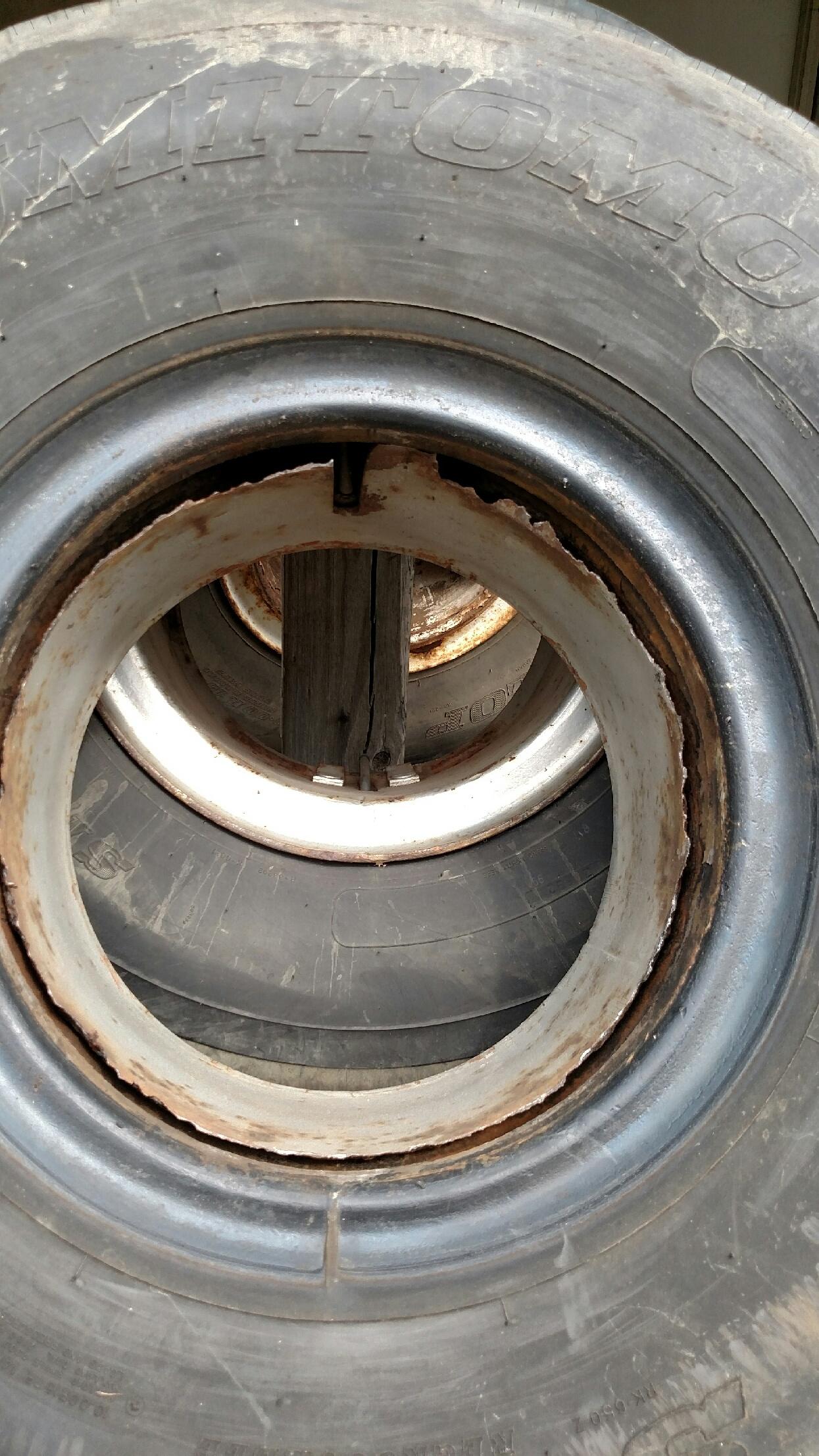

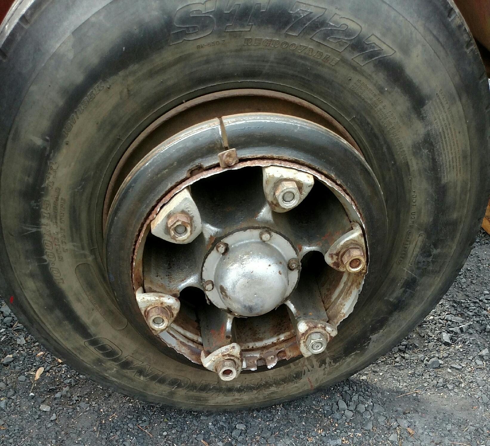

Always, always deflate the tire BEFORE even removing lug nuts. I had no problem with the lock ring, as you can see the nuts and wedges are still on the hub, the rim itself broke in half. It was rusted and paper thin. It seems the wedges were holding the rim together.

was more concerned that the ring wasn't secure

Likewise I never expected that as I did ALMOST everything right... Nuts & wedges still installed. Consulting OSHA guidelines after the fact, it is recommended practice to deflate ANY split rims before removal from the axle.
