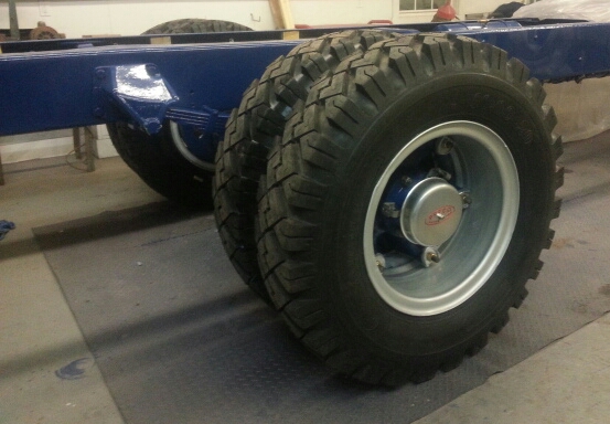

After determining the self-made wheel fitment problem, I was able to mount the wheels and tires.
I sandblasted them, primed and painted them.
Using a floor jack to help raise them to the height of the axle they almost jumped right on with no assistance from me. However, I think I'm going to have to get new wedges for the right side, they're almost bottomed out against the spokes.
They trued up nice and were pretty close "right out of the box".
check your spacer width they should be full 4 inches
Yeah you need to check your spacer if the wedge is out of travel
People these days have a habit of over tightening them and crushing the spacer when they use rattle guns they dont need to be done up real tight I do them fairly snug by hand with a wheel brace and check them again in half a hour or so
The wedges sort of hold the rim on like a morse taper drill bit
Paul
The rims fit!
Good catch on the clamps/wedges/lugs.  The spacer should be the same width side to side and all the lugs should be the same on both sides as well.  There should be cast numbers on the wedges to see what you have.

3 hours ago, j hancock said:
The rims fit!

Thx Jim-Good document
