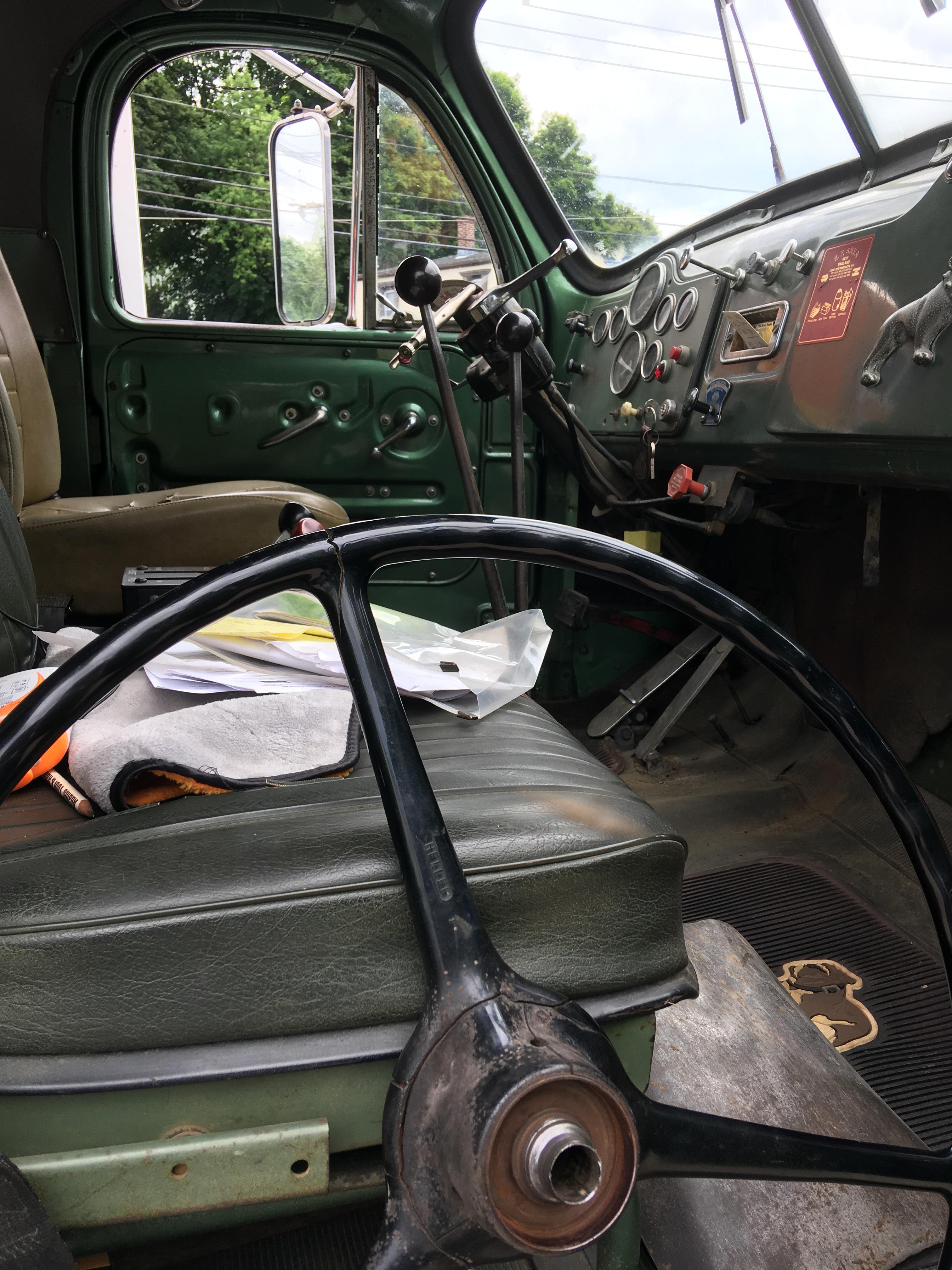

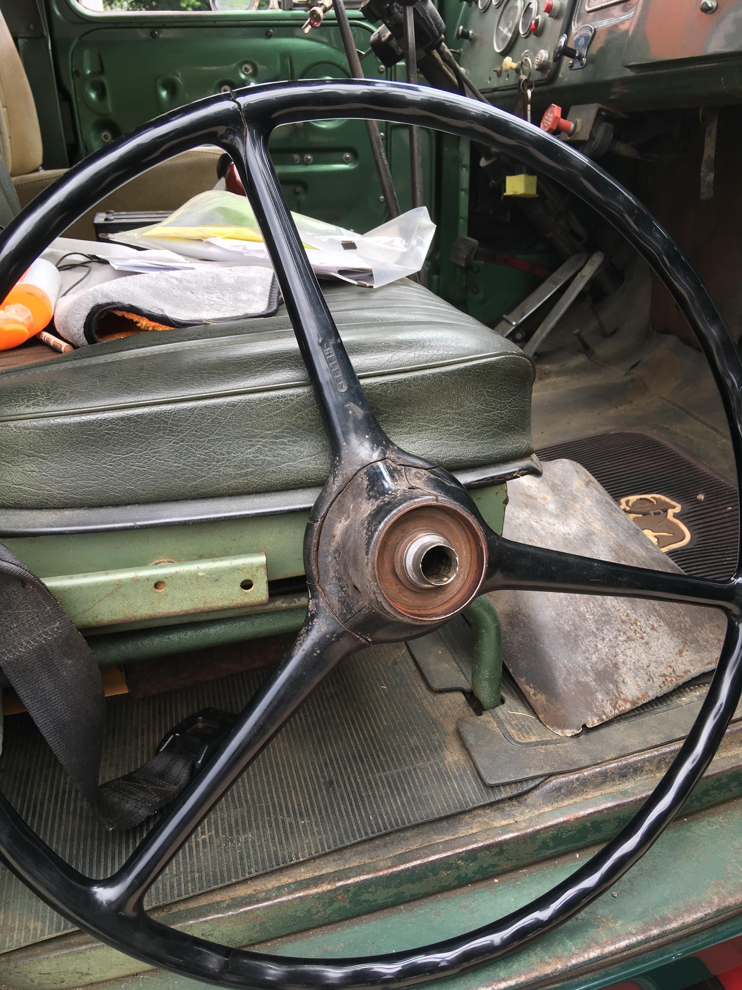

Well took the B in to get a state inspection today.  No problem.  Got my sticker and drove a mile and a half to Gulf to fuel up.  Finished, when in to sign my ticket, BS'd for 20 min. came out and when I grabbed wheel to pull myself up knew I had a problem.  Wheel ends up in my hands.  Snapped off right at upper bearing-which was obviously very worn.  I guess you could say I should have noticed something ahead of time but in the like 6 years that I owned it can't say It ever felt too loose to me.
I guess I'm lucky, I'm a "lightweight" at right around 200 pds.  Guy that owns shop that did inspection goes closer to 300!  Ultimately this thing would have failed but I'm thinking his 300 pd. "tug" when he climbed up (24" rubber ) may have started the break and then I finished it off.
My build sheet says its a Gemmer 500 box.  At some point original owner added power steering.  Anyone have suggestions on best way to get box/steering column  out?
Guy that owns Gulf garage pounded a stud into steering shaft then put a socket on it with a Vise Grip I had a "Tiller" and could get it off fuel island.

Matt-thx very much.  I'm checking on the shaft issue.  And I also had the same box in a B-68 that I sold to a guy in Maine.  So he was checking to make sure he still  had the box.  So if anyone  reading this thread has a clue, please let me know.  I'm also thinking I've got a machinist friend, might be able  to  rework the existing  shaft with a new end.  It broke right where the bearing sits.  As to  your thought of dropping it down,  My engine is a 237 and it looks like as the block flares out a lot at pan, it  would not get past that point.  This thing started life as a gas job.

FT, Inner race. And hollow shaft

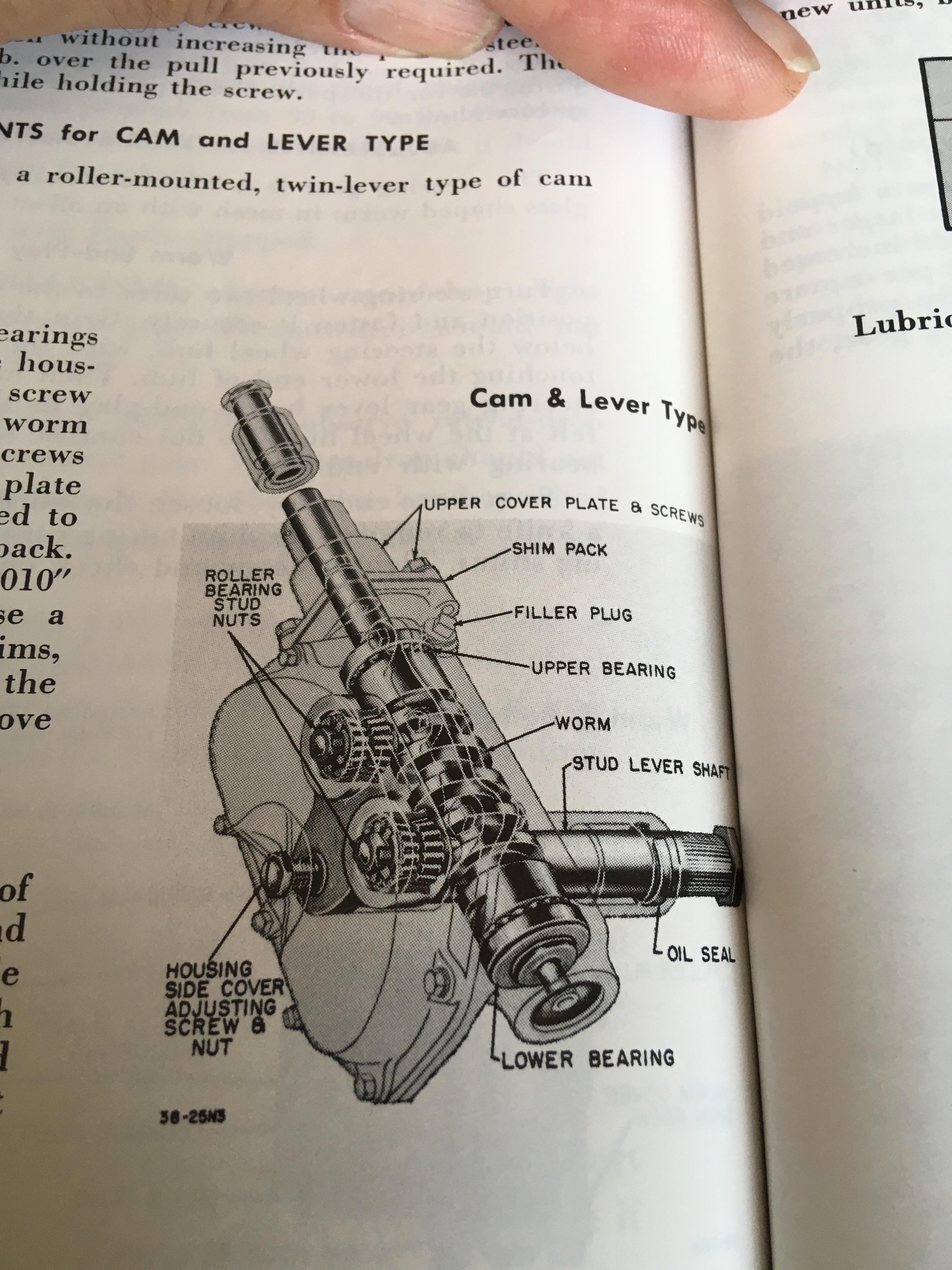

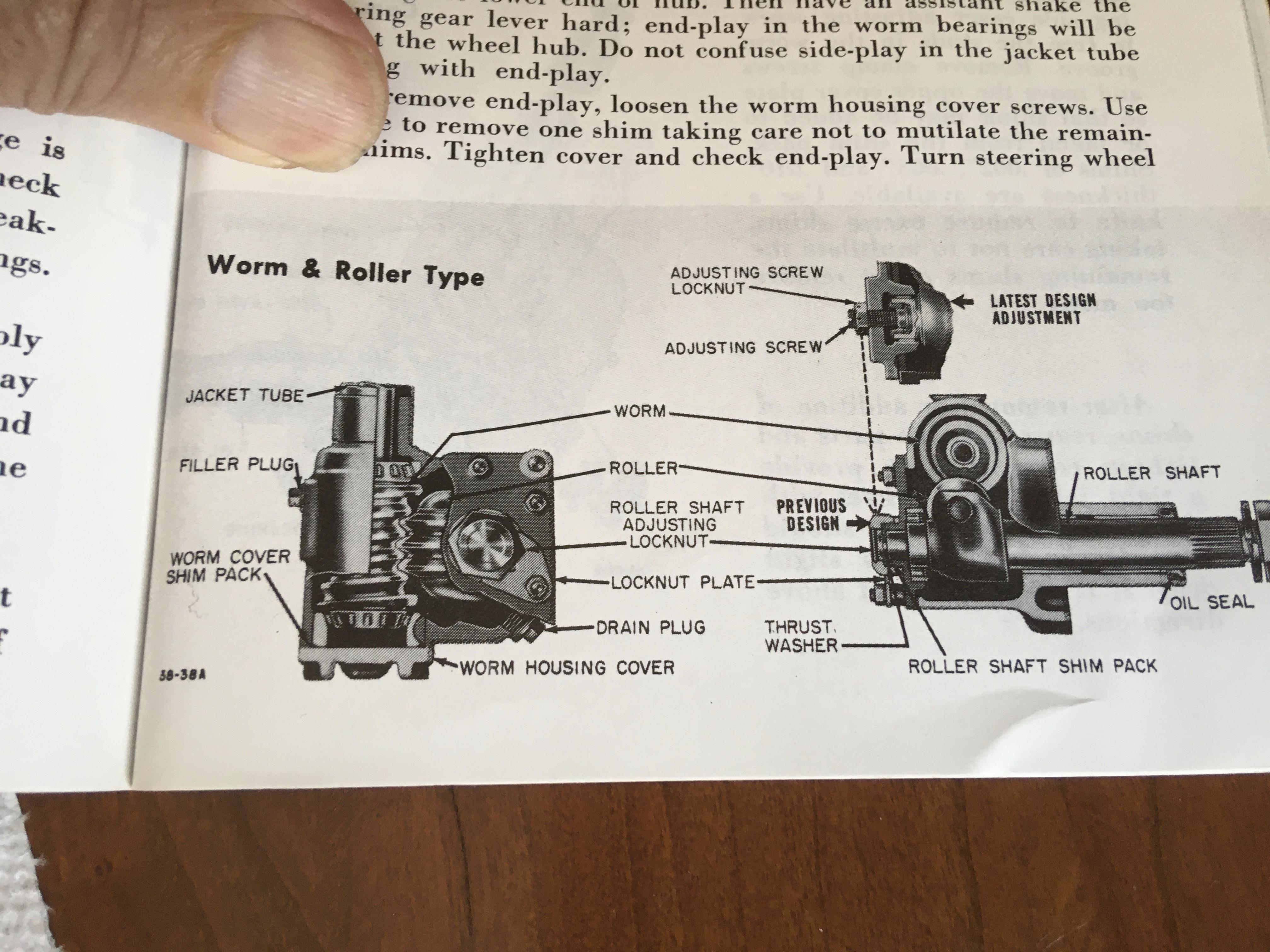

I have a Mack Operation and Maintenance Manual Form TS 442.  Only 208 pgs but attached is a picture of a worm and roller type box which is what you have I believe as well as a picture of the box I have which is a cam and Lever type.
I'm assuming that the worm in both boxes is separate from the shaft??? And if so what holds the shaft to the worm???
