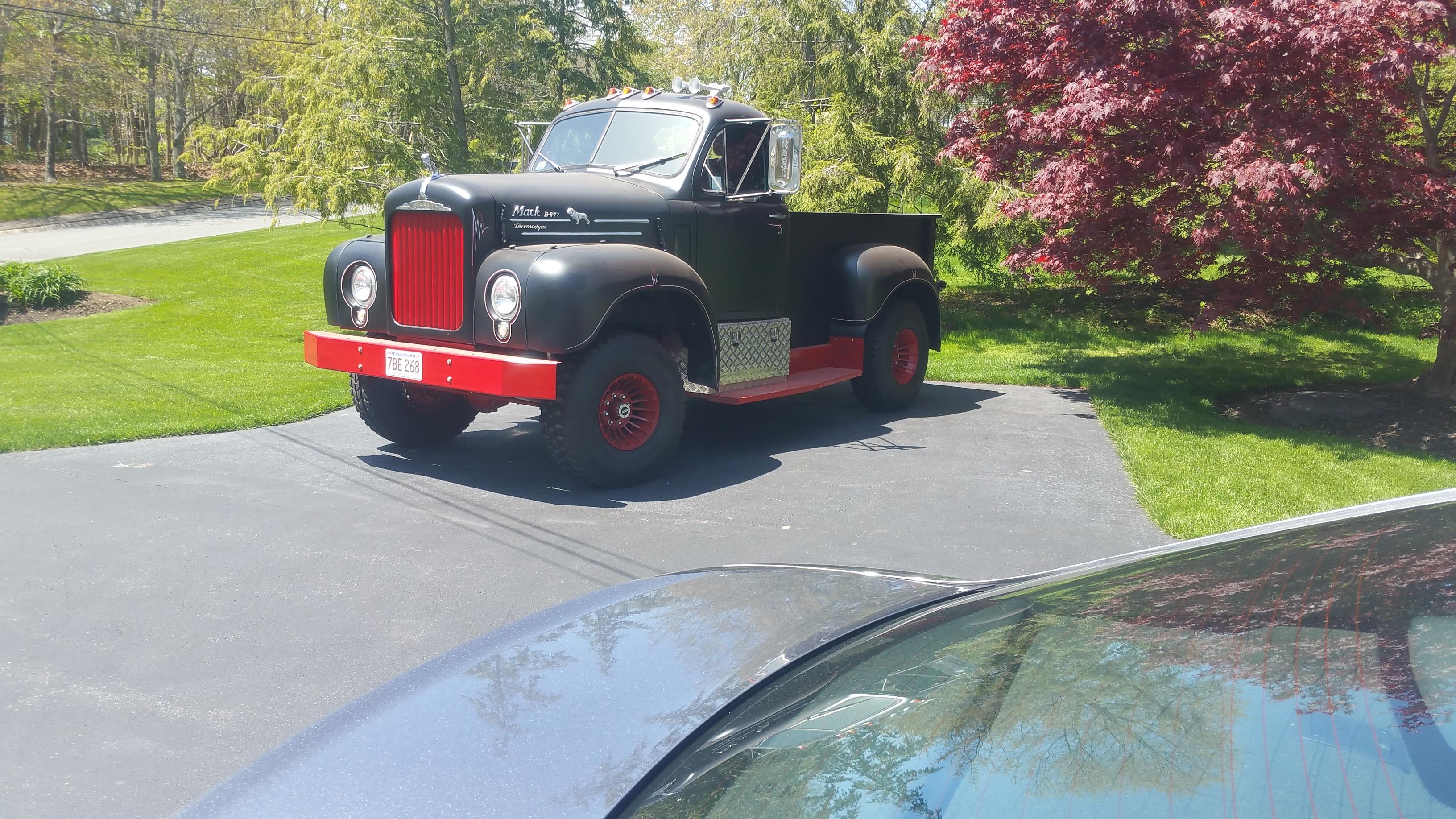

Saw this one in person, was built on a dodge pickup, if I recall correctly... Only about as tall as I was but figured I’d add it here for inspiration...
Edited by CaptainCrutch
Who needs a back yard when you could have a :mack1: Yard?!

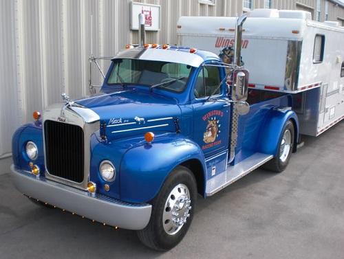

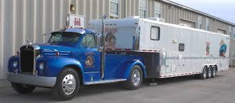

There was a long running thread from a member who built a truck to pull his race car hauler using a B85 (fire truck) and an International school bus. I very nice build. Phantom 409 maybe?  I think he and Larry might have crossed paths at a race track or two at some point.  I cannot find the thread of the build.
that was that real nice white one correct?

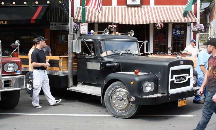

A few years ago at the Cortland NY Brockway show someone had done an excellent job of putting Brockway sheetmetal on an IH ex-U-Haul and was pulling a good sized camper with it. Can not remember the mans name.. Possibly go to brockwaytrucks.com and ask?? There might be pictures also if you go to topics about their show??
Jim Hancock, do you remember the black truck I am talking about???
Edited by Brocky
Brocky
Brocky's pictures of the above mentioned rig.
Jim

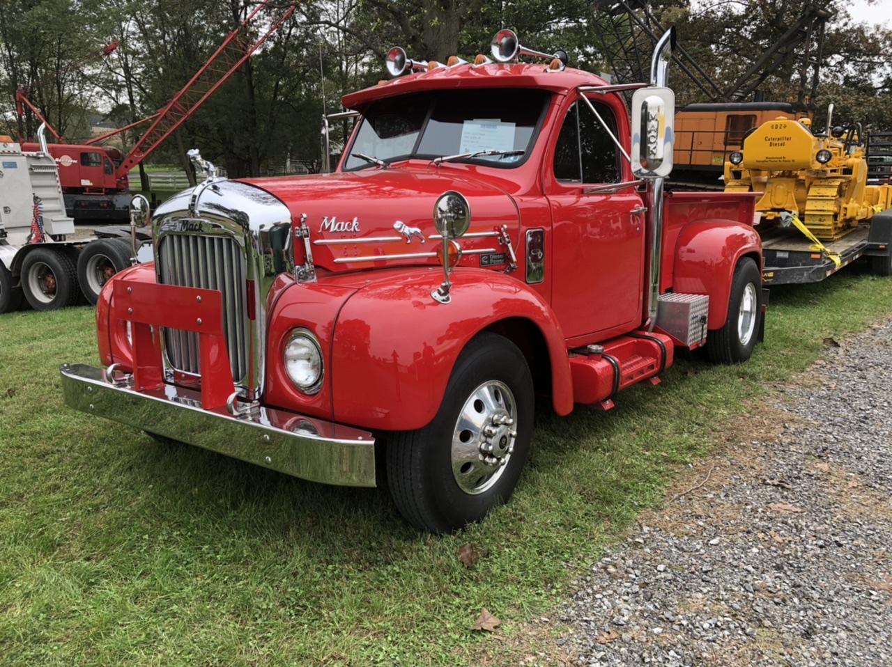

The red B model, like some others mentioned, was built by George Sprowl in Maine 20/25 years ago.  They were built on Ford one ton frames with 6bt Cummings engines.  The cab, fenders and cowl were cut down to make them look appropriately to scale.  I am lucky to have one of them, and love it.  He really did an amazing job.  I looked at building my own for years, and it is a lot of work.  I also looked at dt360 and dt466 engines (I have some of both), and the power, size and parts available with a Cummins 6bt make them hard not to consider.  Look at the horsepower, torque, weight and maintenance cost of  a full size Mack power plant, not to mention fuel consumption in what amounts to a pickup truck, and you might start to rethink this.  I looked at Mack, Ford, Chevy and Dodge frames, all of the power plants noted above, as well as other issues.  There are folks on this site who have built nice B model pickups using 3/4 ton, one ton and full size (class 5-8) frames with gas and diesel power.  It might be worthwhile to reach out to them before you get in the deep end of the pond.
Jim was his name and I did meet up a couple times in Michigan at a race we both attended.  Truck as nice in person as pictures show.  He did only run it a few years though.  Have not seen him in some time now.
Larry
