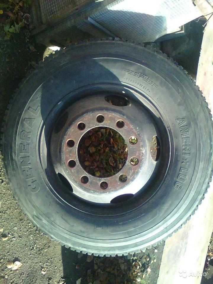

A question - don't you have one 7.5x22.5 5 hole stood centerd still wheel? I need it to complete the one in the picture to get a pair. Need it shipped to NJ but that's another story. I was going to visit Global Truck Traders for a while but that turned out a bit long way to North from the area I used to be in. Vlad
