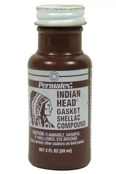

seems to me i had a HD box wrench that i  heated up with a torch ; put an off set riser and bend in , cut off the open end  was able to put small length of pipe on for leverage to tighten the inner bolt. before the days of silicone we put the brown tar -like permatex on the threads for sealant. sure we all have the one draw in the toolbox with custom made wrenches . problem with old age ;  i look at the tools can't remember what i made them for.

'mech'  you made a tool that sounds like the actual kent-moore tool... I made them because the short bone wrench was $750.00...  I bet the tool you made worked great, and I think the sealant you are talking about is called: "Indian Head"..  really tacky, and stink's like ASS !!  Jojo

all three of my tool boxes have one drawer that the jar of Permatex Indian Head sealant leaked in, leaving a big brown tar like mess

I dont use Indian Head any more,  I have had many messes from it,  too funny.  and the dirt daubers caught me one day when I replaced a fuel line on a generator, and no gas came through to the filter.  I was scratching my head,, thats when I learned about the little bastards..  too funny...jojo

made an attempt to go out to garage today to look in that "special drawer" of home-made tools. the temp will have to go above the single digit first. modern technology (silicone) has replaced all the good stuff. one of the challenges back in the day was to  see a transmission put together with this new white stuff silicone and not actual gaskets.
Permatex and Loctite products are getting harder to get locally as they are getting replaced by cheap crap that looks almost the same but definitely isnt
Think it comes from China or somewhere even cheaper if thats possible
The good old gasket good, I  aviation sealant from Permatex is the proper name and the purple Loctite flange sealant that neved really sets hard are my favorites
Permatex copper head gasket spray has had a good result for me
Old blokes used silverfrost paint for head gaskets years ago
Paul
Paul, I swear by This Stuff..(& Loctite 680 retaining compound..)
Image 1 - Loctite 3J Gasket Sealant Non - Hardening Form - A - Gasket Aviation 50ml
Oldest Son is an Apprentice mechanic at the Local New Holland Farm machinery Dealer, & his Toll Box is full of CNH Branded Stuff, that Looks very similar to Loctite Products..
