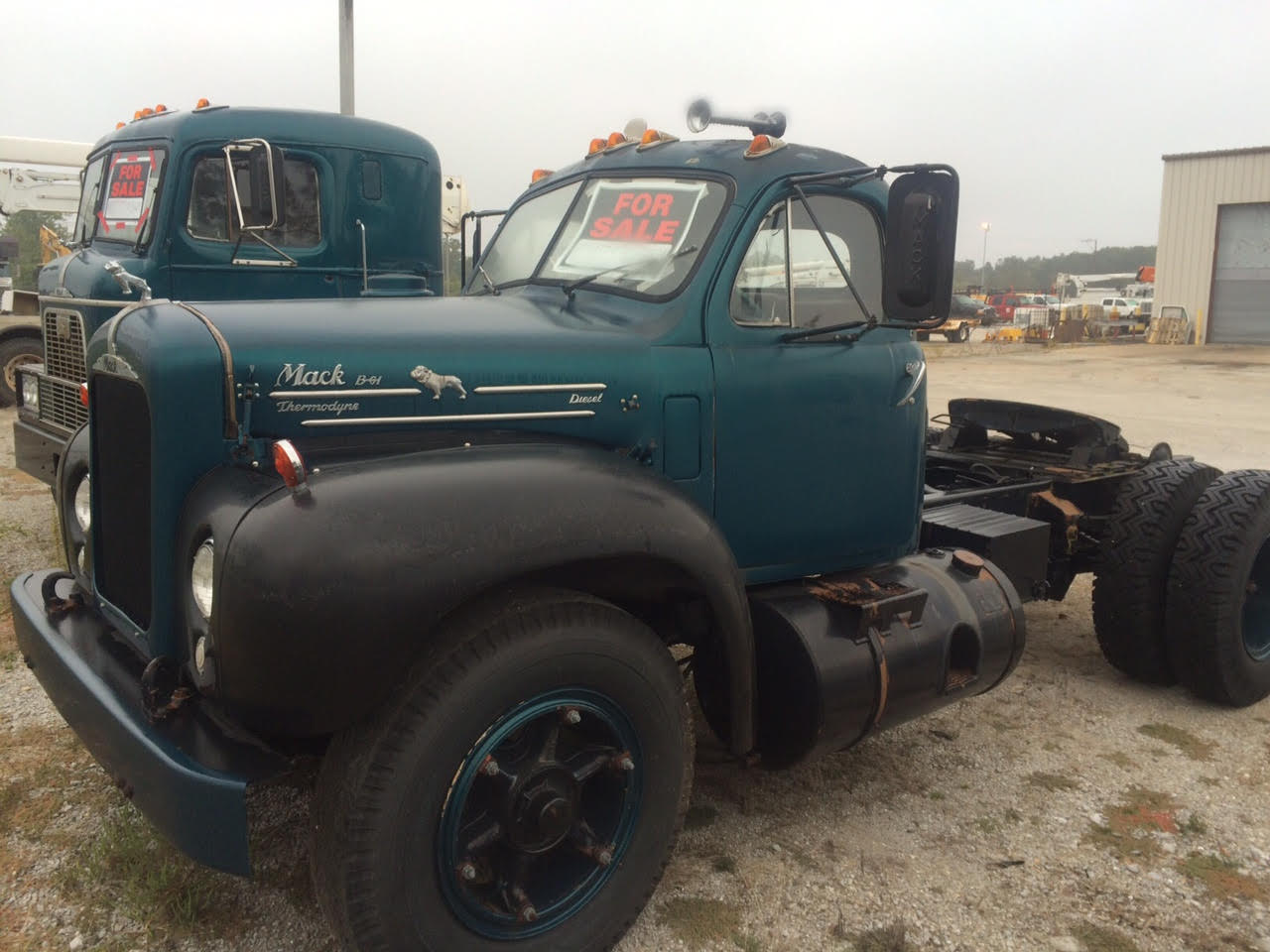

It seems the truck is in a good shape indeed.

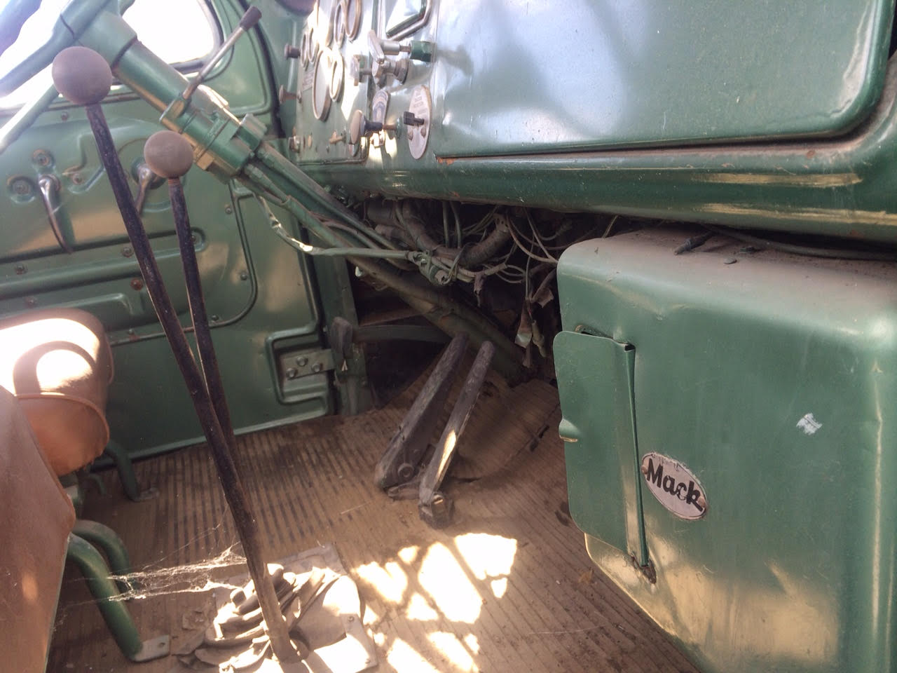

Good interior either.
The color makes it unusual, you might get it brighter applying some polish on.
Any history on the H-model in the first picture?

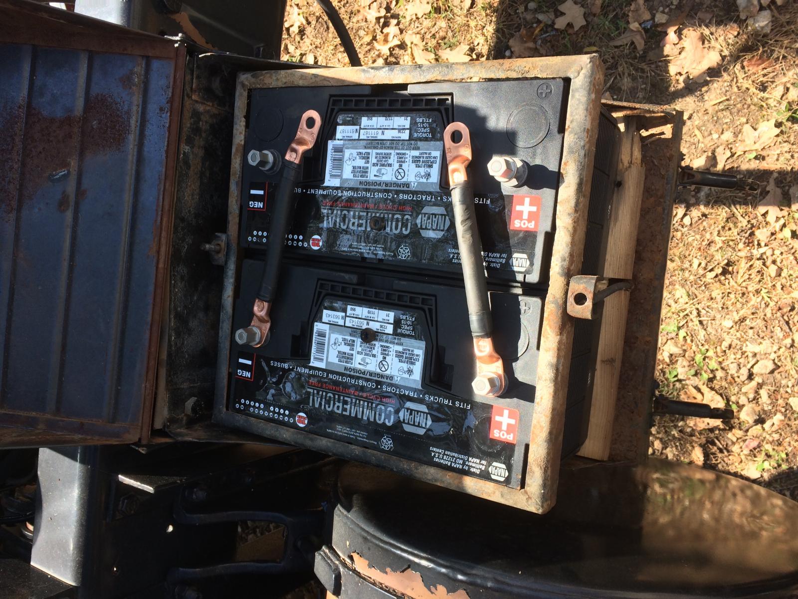

Not much progress today. I took out all the old battery cables, installed the new batteries, and cut new jumper cables. attachicon.gifimage.jpgattachicon.gifimage.jpg
Any work to bring it back is progress! Paul

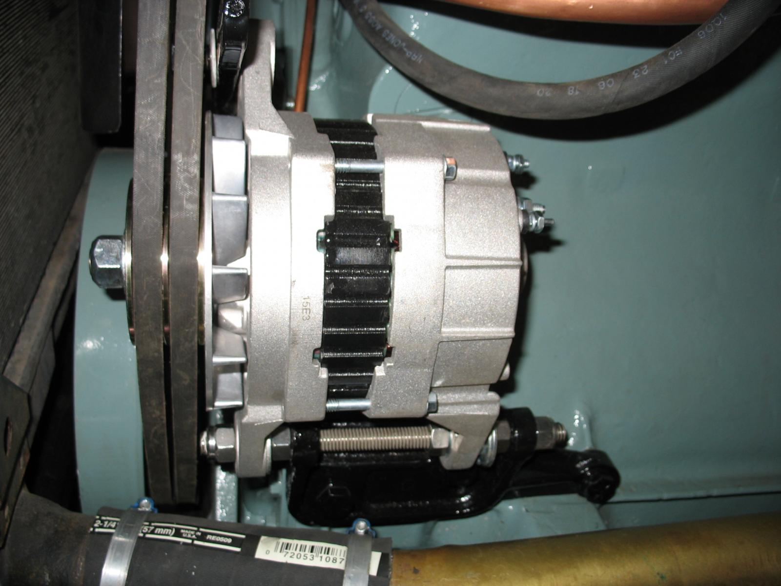

You would do better with a MT39 a newer starter version. Send that alternator bracket back to the dealer and get your money the generator brackets will work just stop by the hardware store and get a 1/2" pipe about 4 inches long to use as a spacer you will need the pulley off the generator anyways because the belt widths are different they are called B width i think 9/16th or 5/8th wide cant remember off the top of my head
Robert
"I reject your reality and substitute my own."
The old generator bracket should work. I used one with some 1/2 " all thread and mounted a 22SI 12 volt 125 amp. alternator. Some use the 21SI alternator but the 22SI was cheaper. I used a 42mt starter. The 39mt may have better as I had some clearance issues with the vent pipe. The shop where I got the starter said the 39mt was a gear reduction starter which would have more torque but the 42mt should spin faster with enough battery. Nice find on the truck.
post-9172-0-25410000-1445783797_thumb.jp
agree. I used a 42mt starter on mine and it has the starter mounted on the top driver side. I had to change the clock position about 4 times to get it to miss the steerimg box and throttle linkage. 39MT is a better choice. I did use a 21si alternator on mine to but made a new mount. the old will work with spacers tho like the guys said
