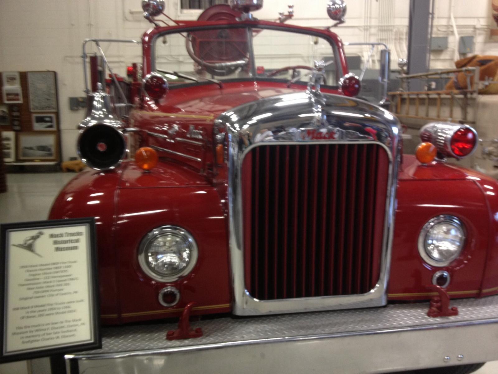

I have looked thru MACK Model B books that have photos of lots of different B's and have every B model listed and state the number produced and years produced in. I don't recall seeing a B85. I always understood that B70's & B80's series had the longer hood, and B80's had square or flat fenders. But I have seen photos in "wheels of time" and some truck papers of B models (fire trucks or that once were fire trucks), they are listed as B85's. They are definitely B models, but have round fenders and short hoods..... Was a B85 specificly and only a fire truck? Or a miss print?
The B model fire truck model designations were based on the size of the pump that the truck was equipped with. A B-75 was 500 gpm, a B-85 was 750 gpm, a B-95 was 1000 gpm, and the B-21 was 1250 gpm. All of them except for the B-21 were basic B model cabs with the B-21 having a stretched nose to accommodate a Hall-Scott engine.
