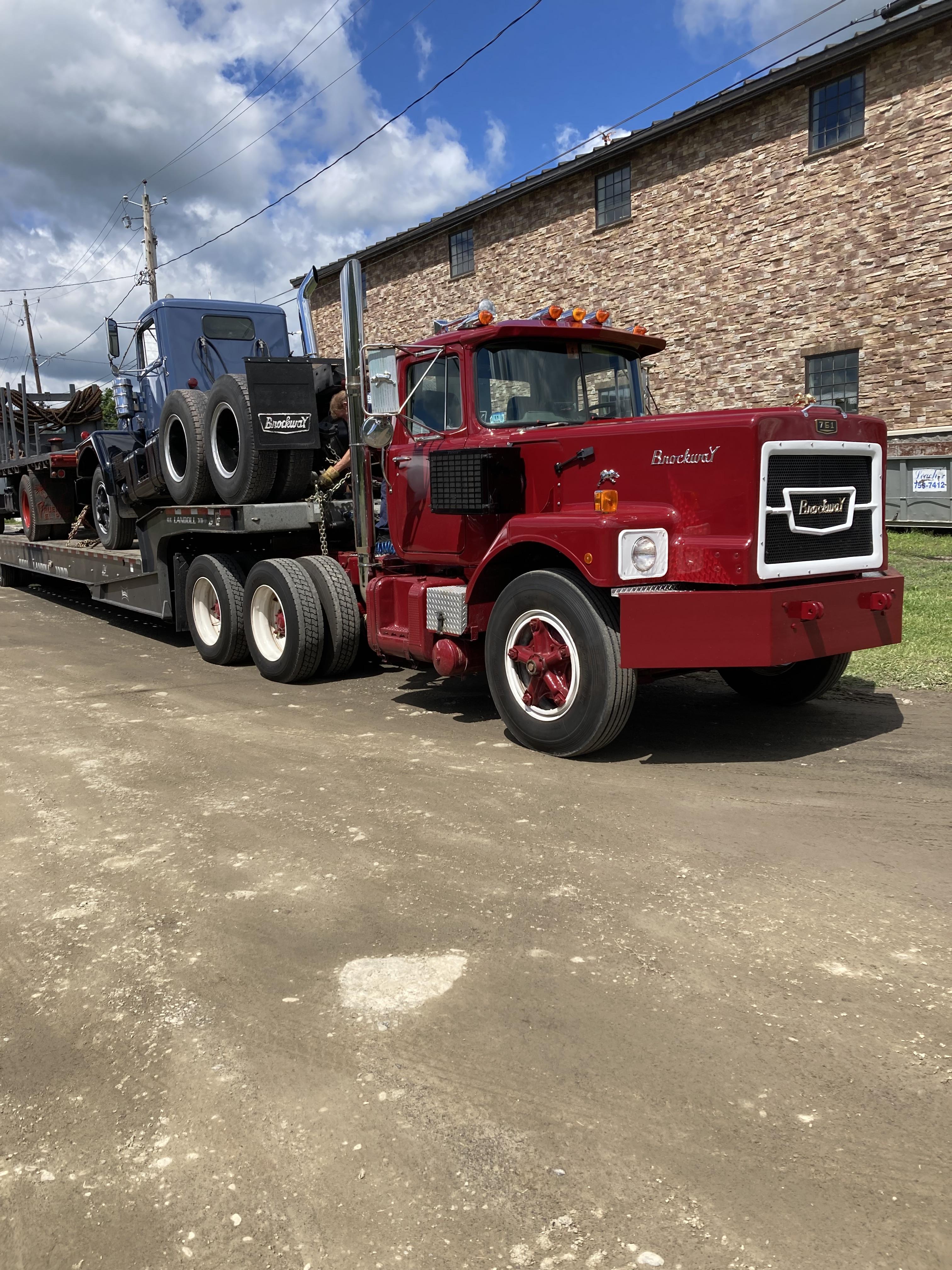

Paul, I think (???) you sort of have it figured out.. And yes it operates different than most of US roll backs (tilt trays)..

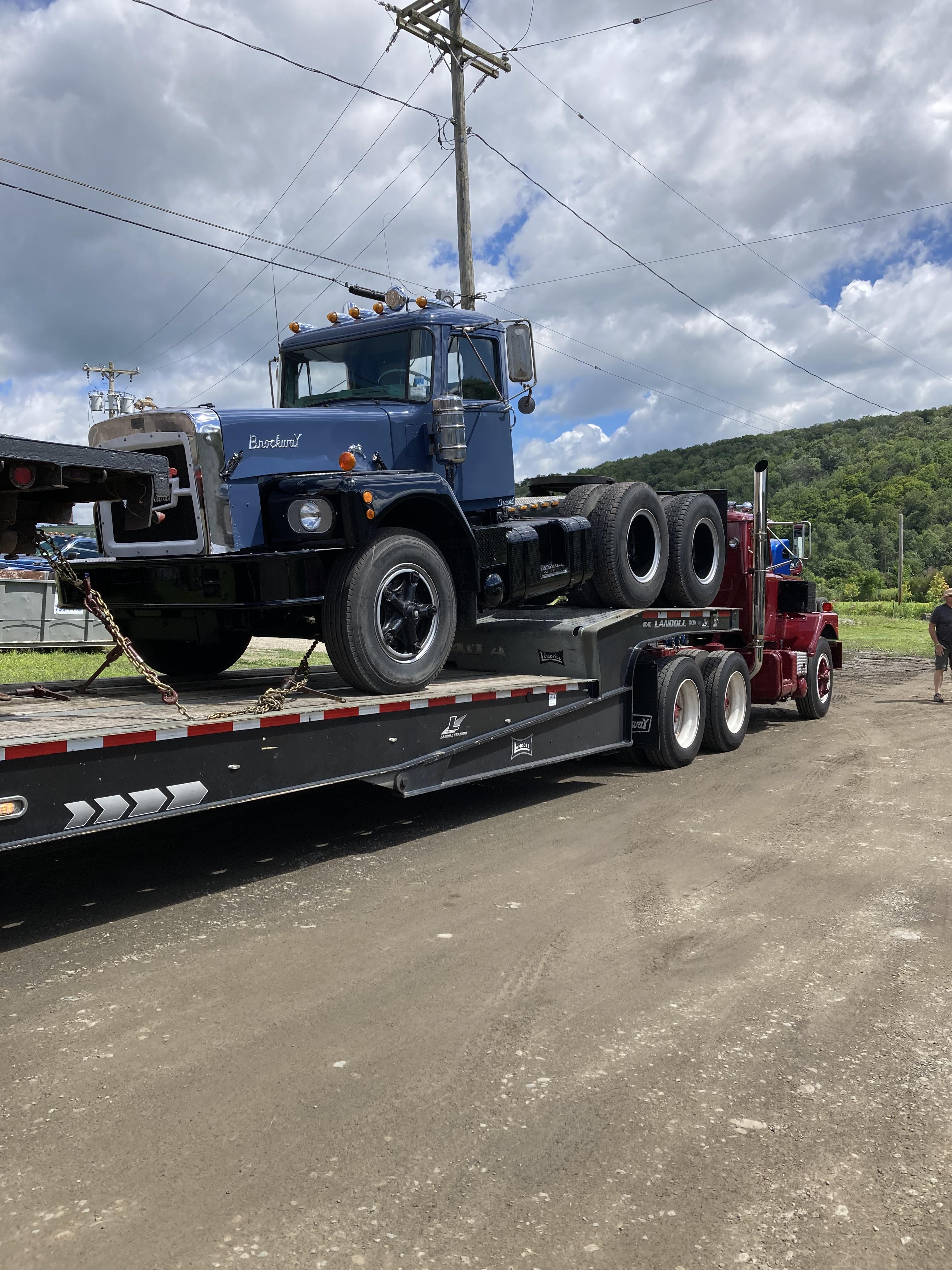

The unit Mowerman  posted the picture of is a Landall trailer version of a tilt tray only the tandems slide forward to lower it to the ground..
Brocky
17 hours ago, mrsmackpaul said:
So would I be correct in my understanding of this tilt tray
The bumber bar light bracket doohickie has it's own hydraulic function and this also doubles as the feet or stabilizer to take the strain and stop the truck doing a wheel stand
The big long ram on top pushes the tray back and gravity allows it to gently lower to the ground as point of balance changes as the tray slides back
And I gather you have a hydraulic winch up the front as well in the floor of the tray
Do I have any of this correct
Tilt trays over there are a lot different than Australia
Paul
correct in operation ideas; study the pictures very closely (I have numerous times). the rear "landing gear" attaches to the bed /deck rails at 4 points =2 each side :: 2 on inside of rails ; two on outside. the landing gear is lowered first ;  for stability also control of bed/deck tilt . gear down, extend deck; as deck extends the landing gear is slowly raised, thus allowing the deck to tilt at controlled rate.  sure hope I'm right =will be in heap of doo doo  with owner for miss instructions. LOL

Took me a while to figure out what you were talking about. I got it …ha ha that thing was absolutely gorgeous .. I originally wasn’t going to take any pictures of it and then I got to looking at it a little closer and I mean it was immaculate hundred percent restoration. There was no flaws on that thing at all every detail covered it actually looked a lot better than the photograph shows.
