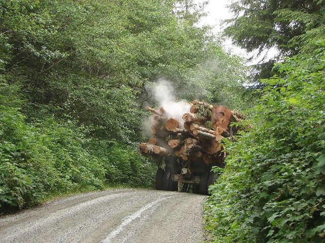

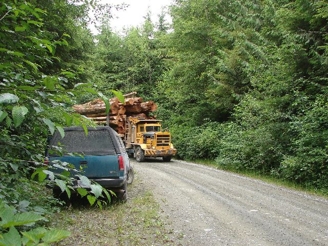

First off,the guys are right,the loggers did water cool their brakes!! There are no Cat Scales in the forests of the Pacific Northwest.pretty difficult to guess the weight of those bark covered logs especially if they get wet! U can be sure they're not grossing 80000 !Out behind the bar,I remembered the name of the place out your way I used to sell wrecked cars to,was Leetsdale Auto wrecking.
                                       Fuel tanks mounted behind the cab were pretty common on early Kw's,Pete's and many other trucks in the northwest. The off road loggers
                                       were mainly the ones that cooled the drums with water, but it wasn't that common.  Note the fuel tank behind the cab on this 54 Pete that
                                       that belonged to Herrett Trucking Sunnyside , Wa. At one time it was the biggest refrigerated truck line west of the Mississippi.  I use to see
                                       Herrett trucks all the time when I was a kid.

My grandpa talked about turning the water on before heading down the mountain with a load of logs. Got to remember those roads were skinny, steep with lots of switch backs. The trucks didn't have jakes and like mentioned above no scales, loads were measured by the board foot. Until jakes came around I don't think watering your drums was that rare.

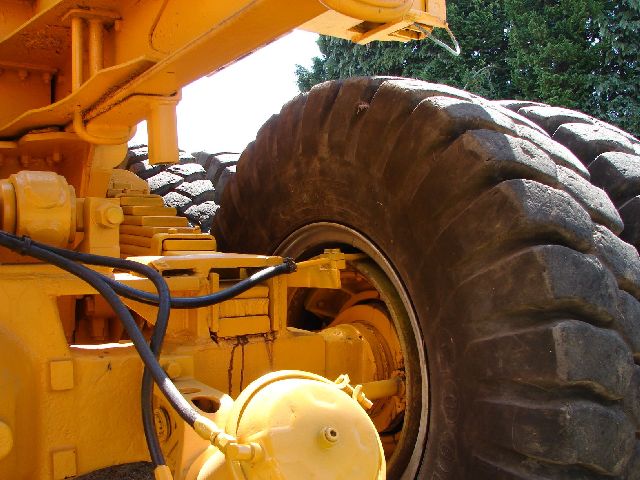

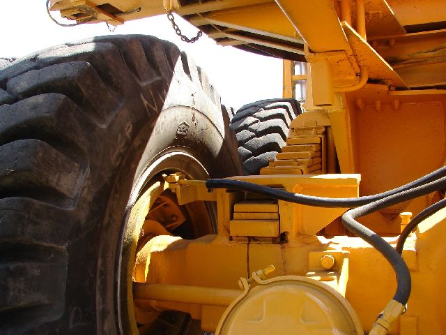

Hayes WHD Ow. Steve Drybrough - 07142207-52s.jpgHayes WHD Ow. Steve Drybrough - 07142207-53s.jpg
Really digging up a thread here but, does anyone know who makes this tire?  I'm looking for the same tread pattern in 1100-22.  I've seen a few L cab log trucks wearing them but can never make out the tire brand.
It was an off road tread design.
And I don't think they were ever available in 11-22.
