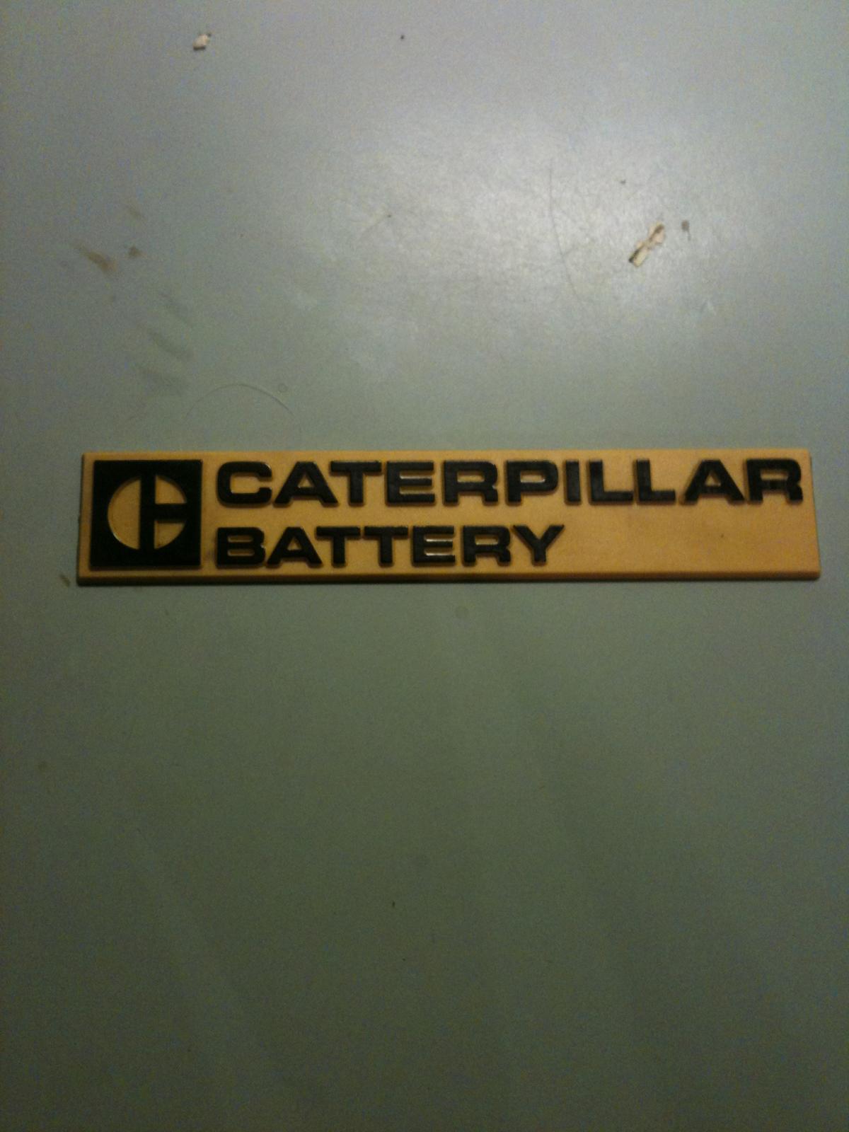

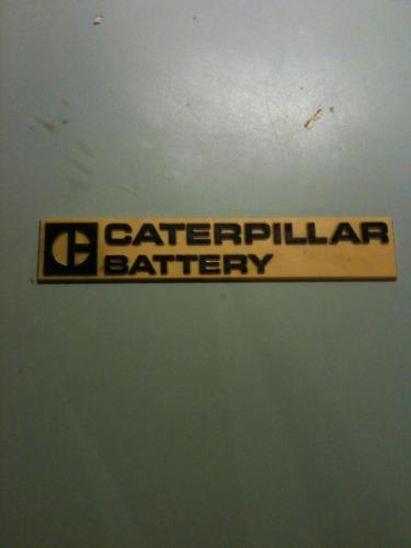

motorcraft batteries are great. caterpillar batteries last 7-8 years in our equipment. best battery we know .
Have to agree on Caterpillar, I use my heavy equipment rarely and my D7E has been as long as 2 years without stating and fire right up, but after 7 years, i know too buy new ones as its 24 volts and both have to be in great shape to start.
