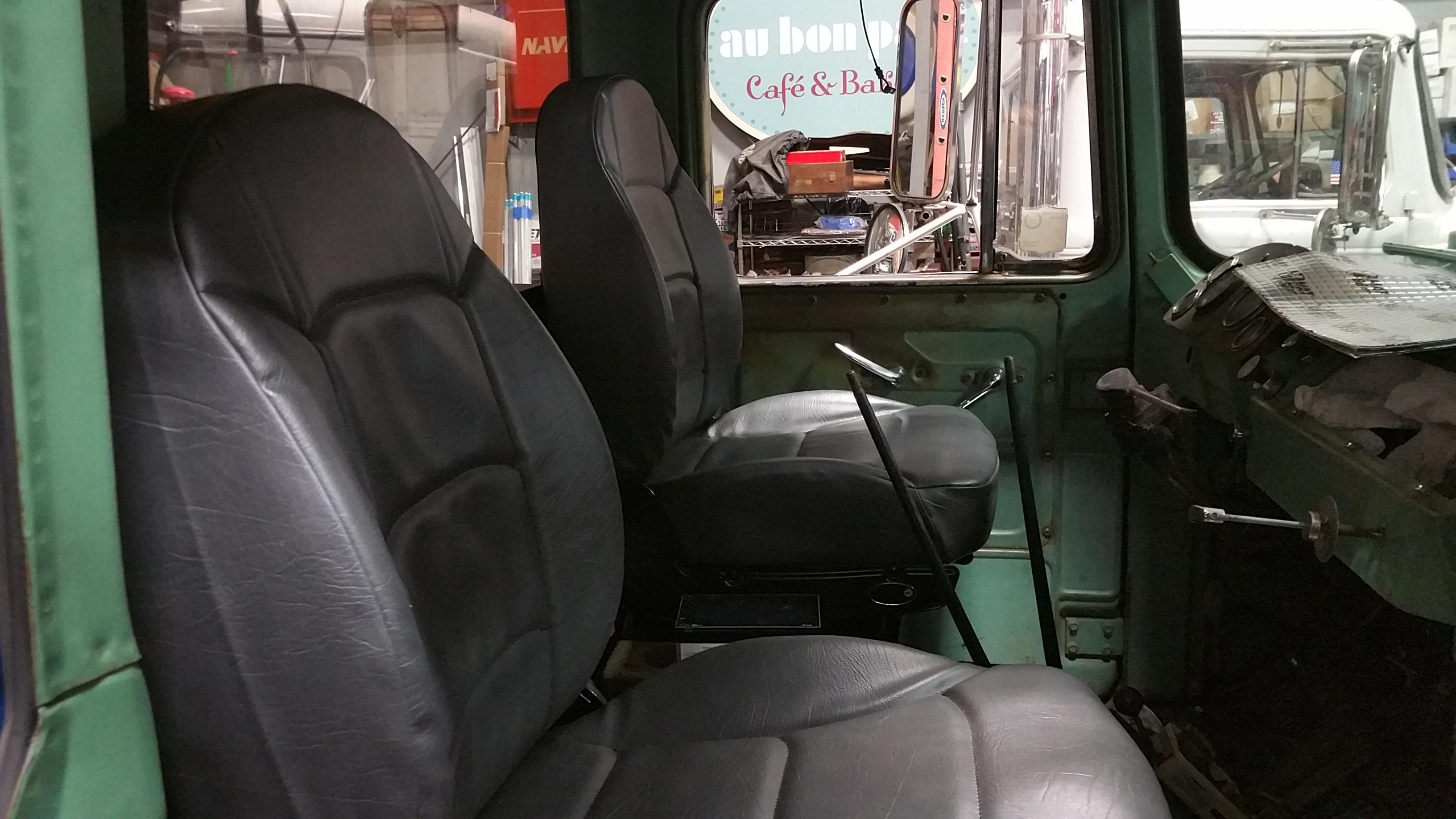

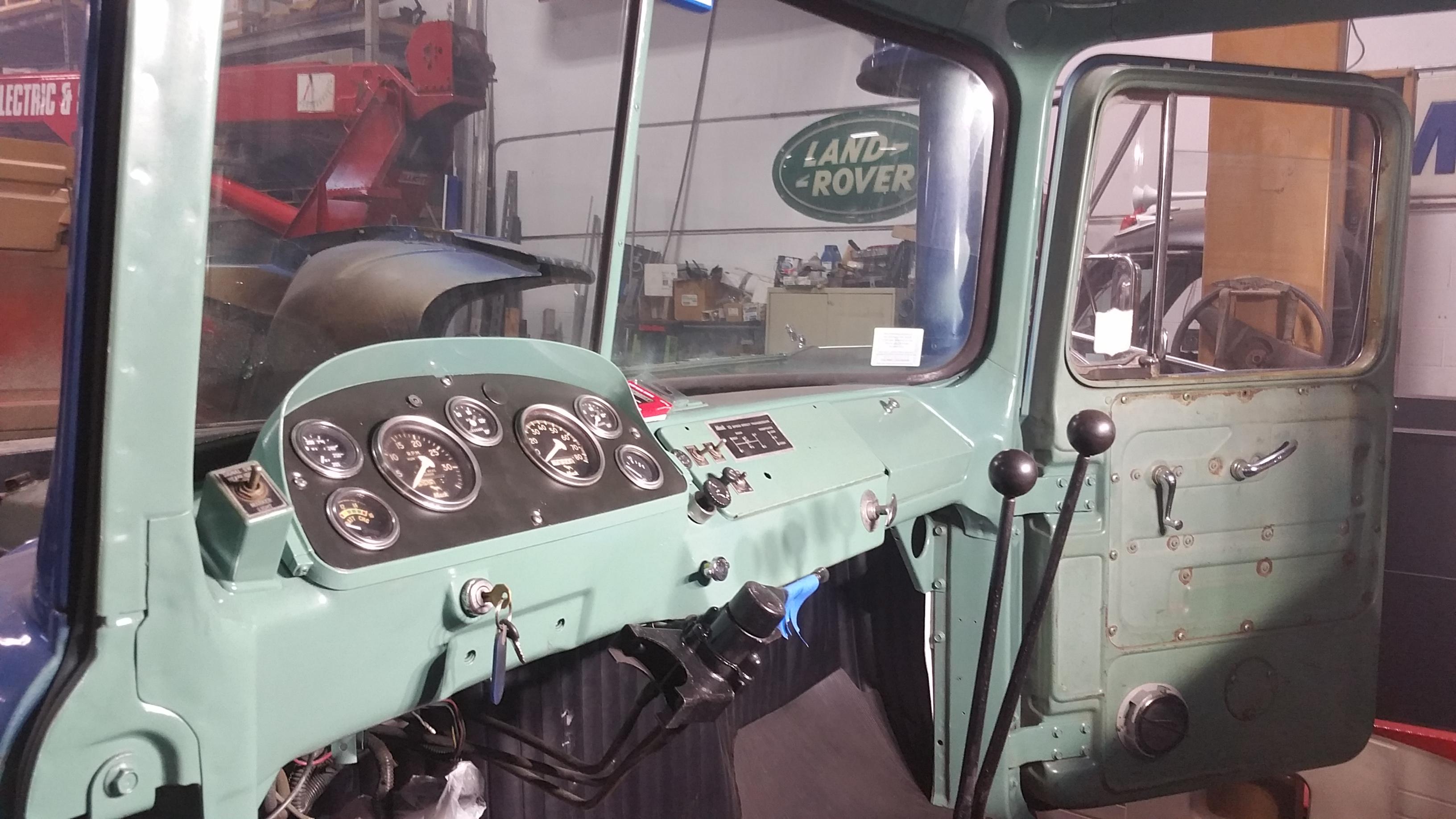

Seats, and interior work look good. Should be a reasonably comfortable truck to drive when finished.

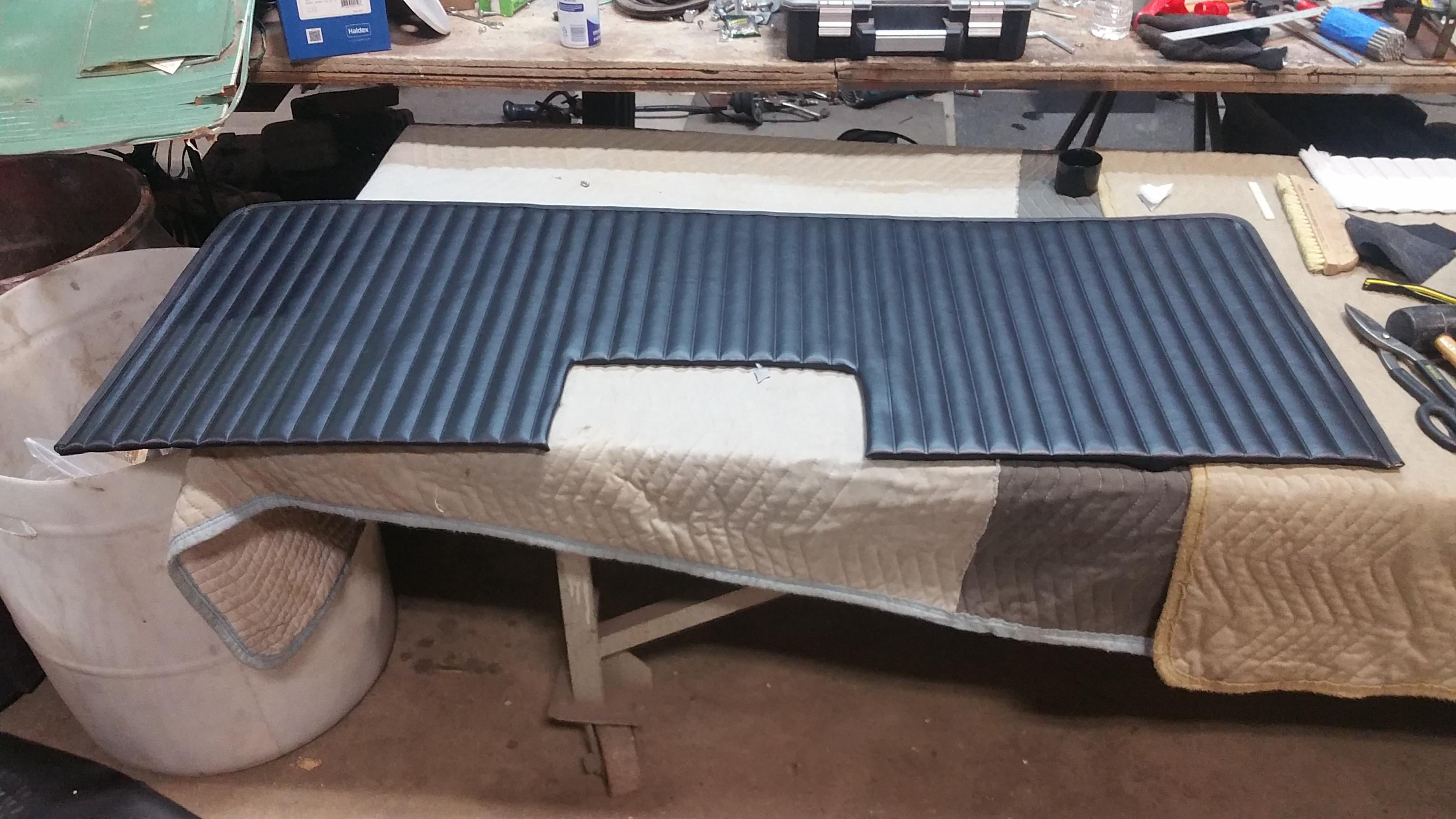

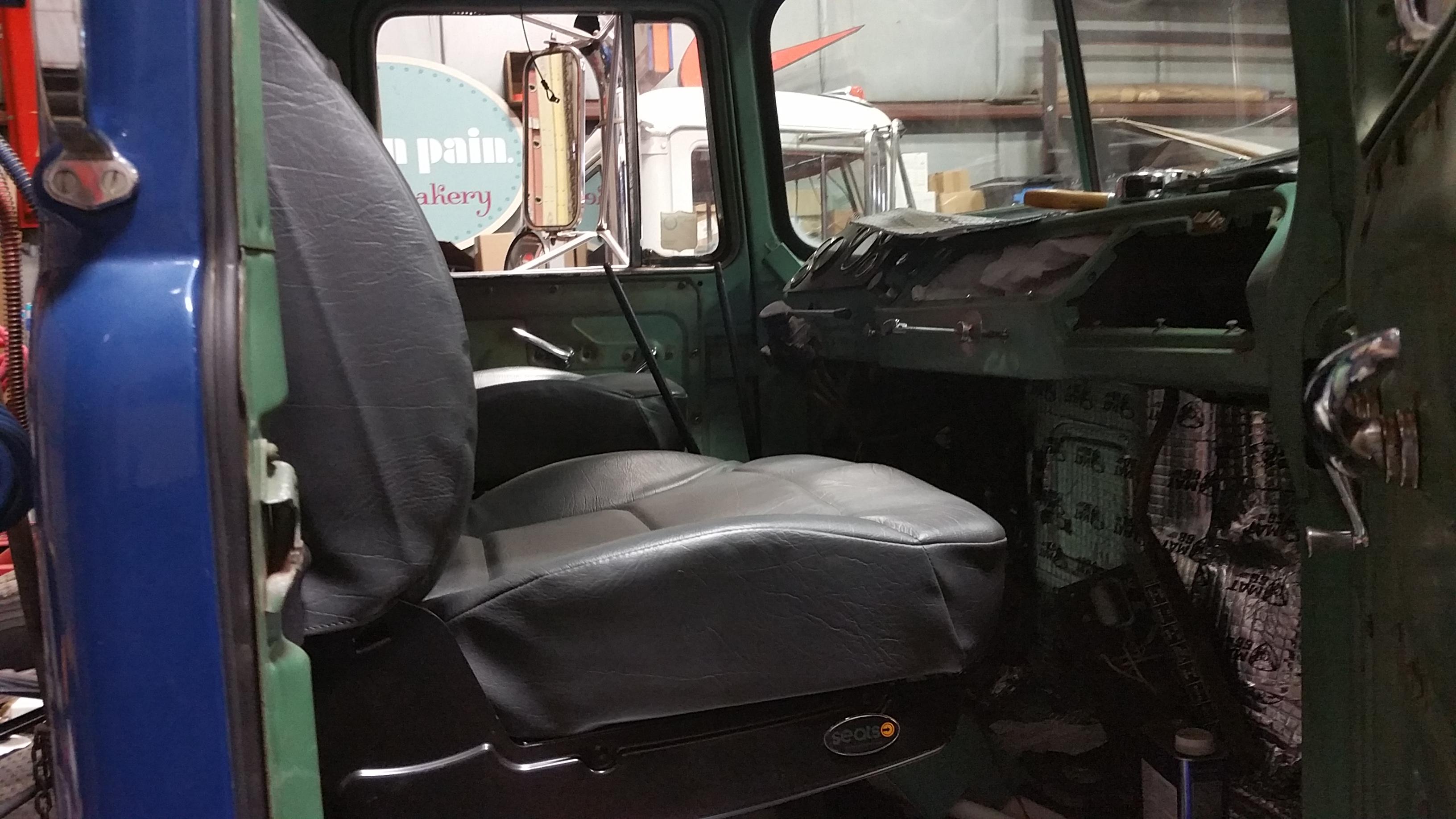

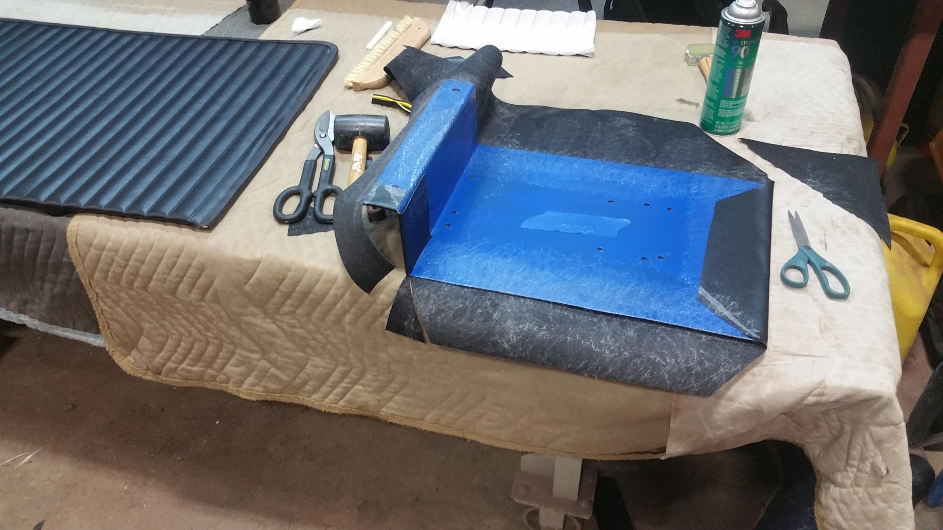

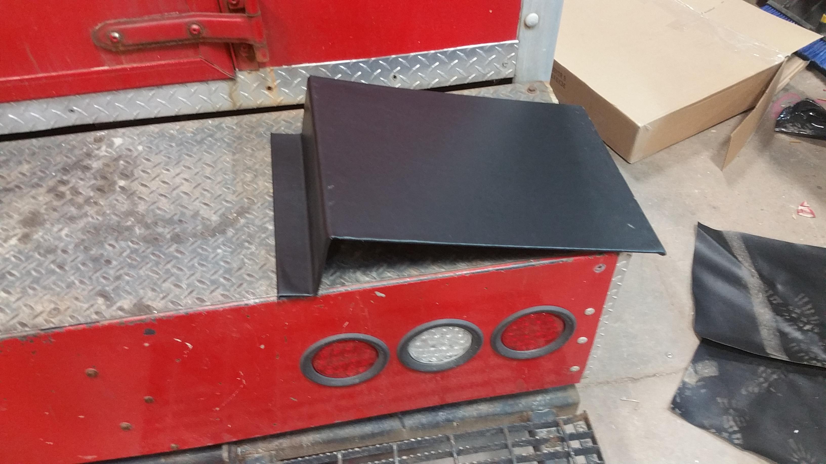

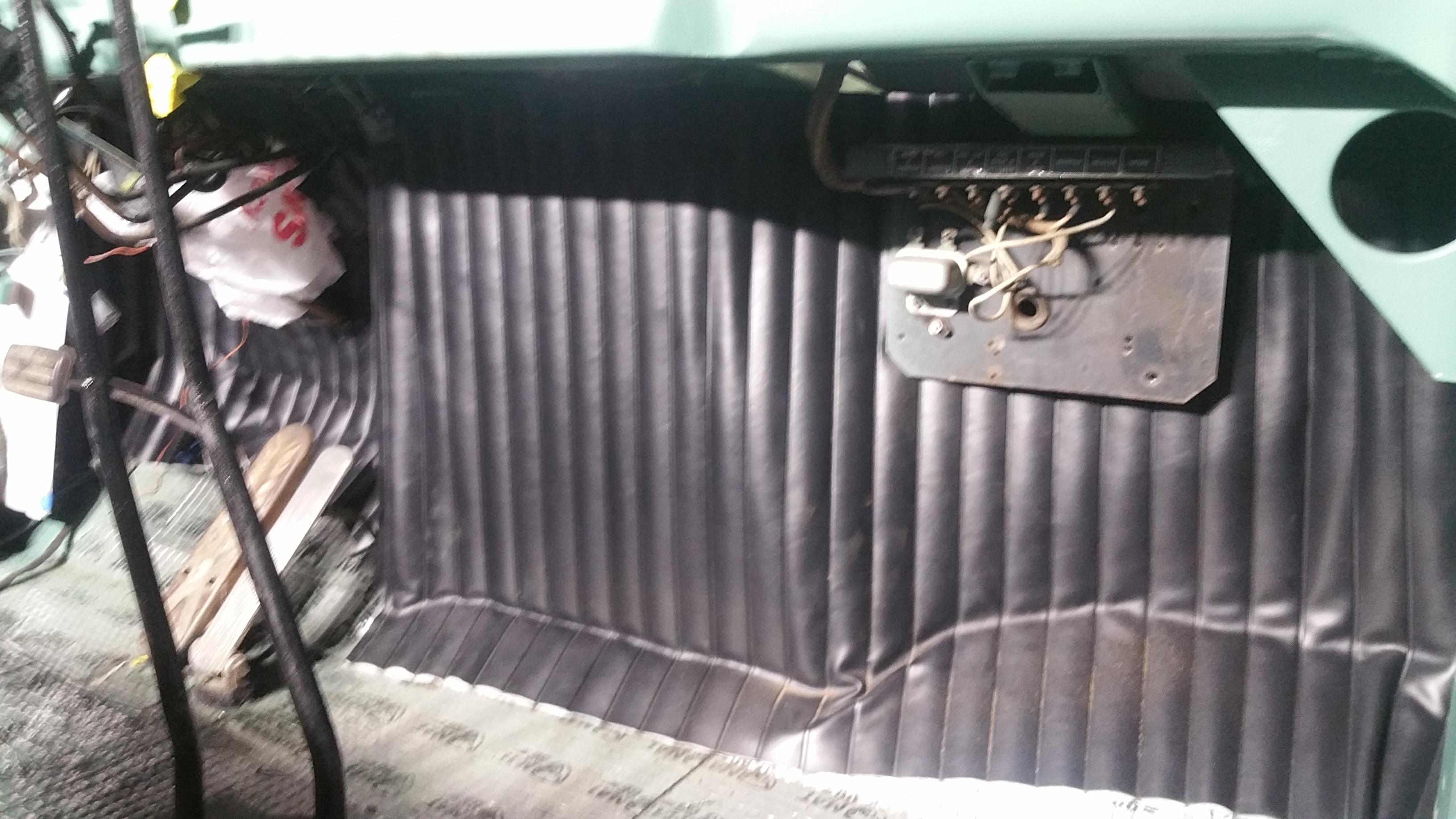

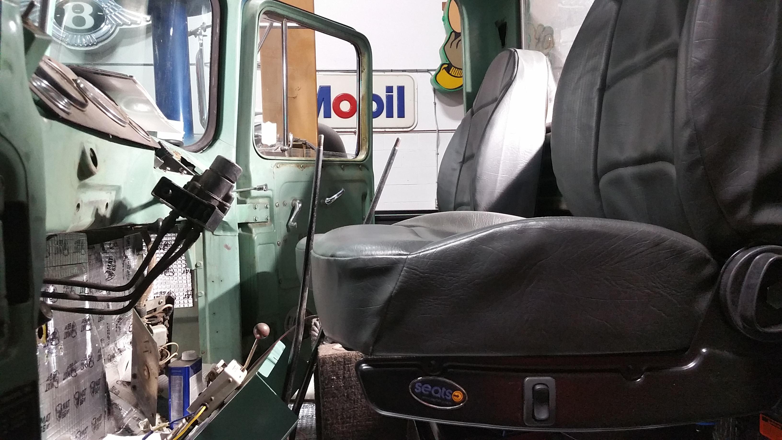

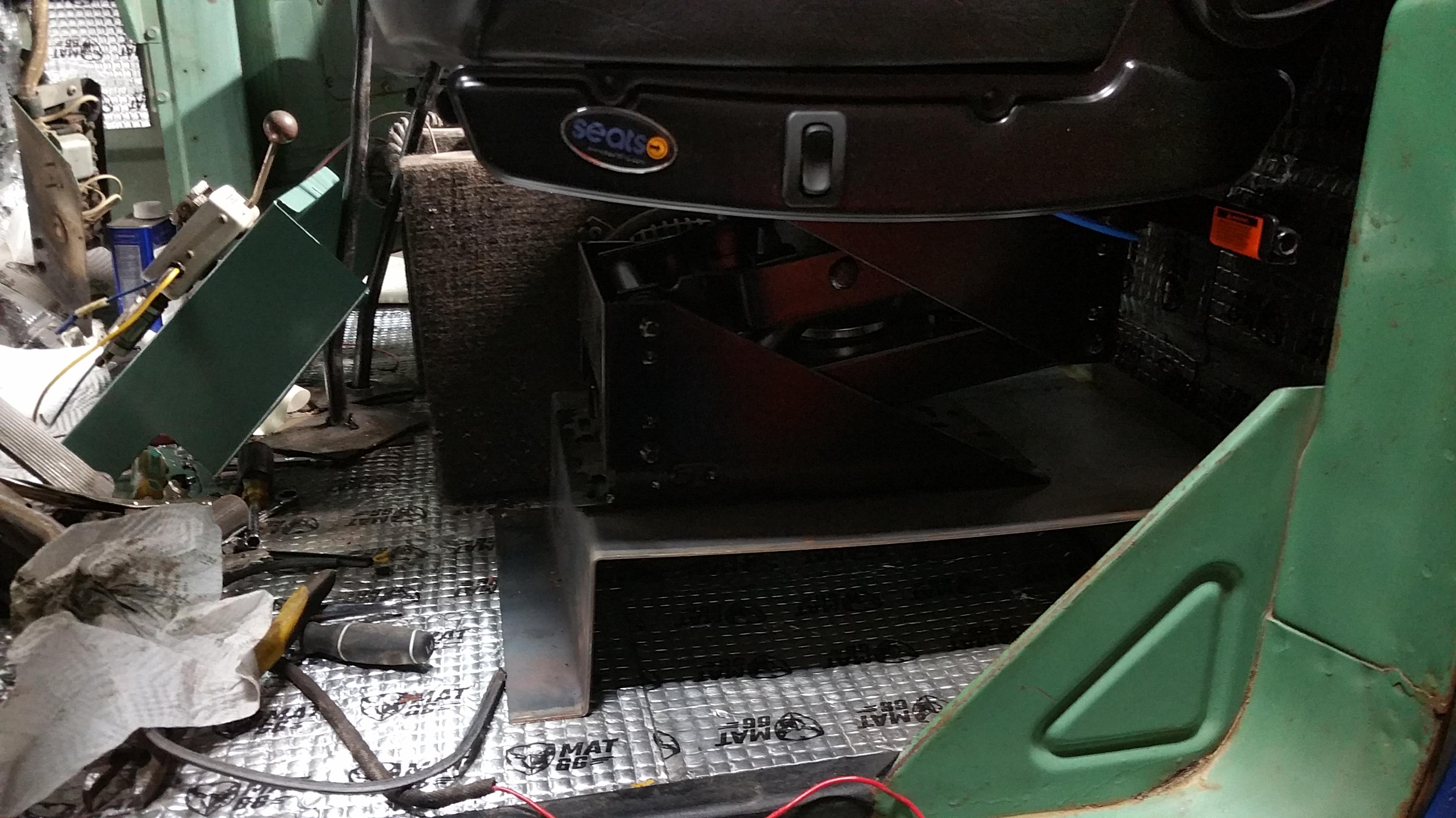

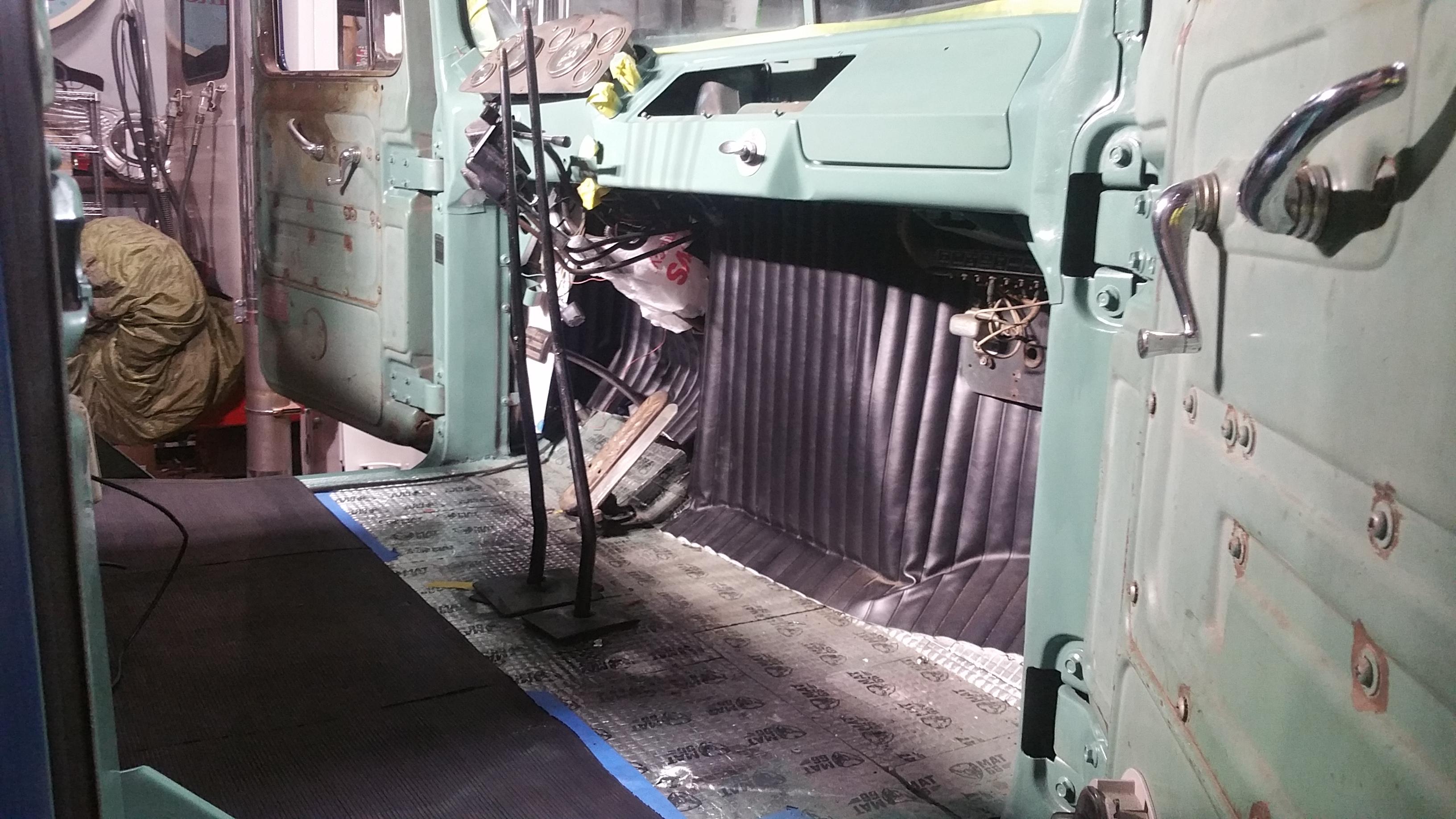

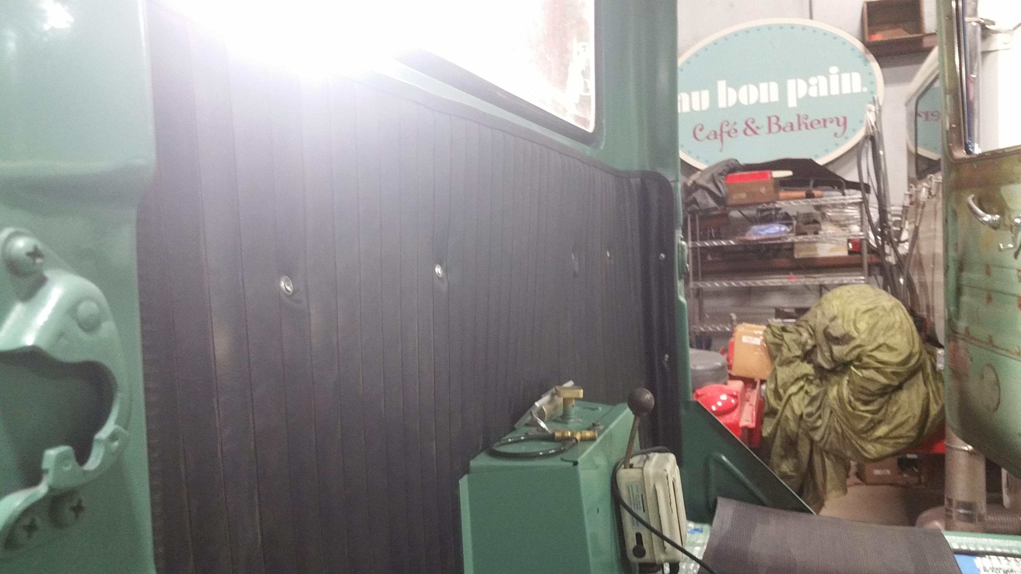

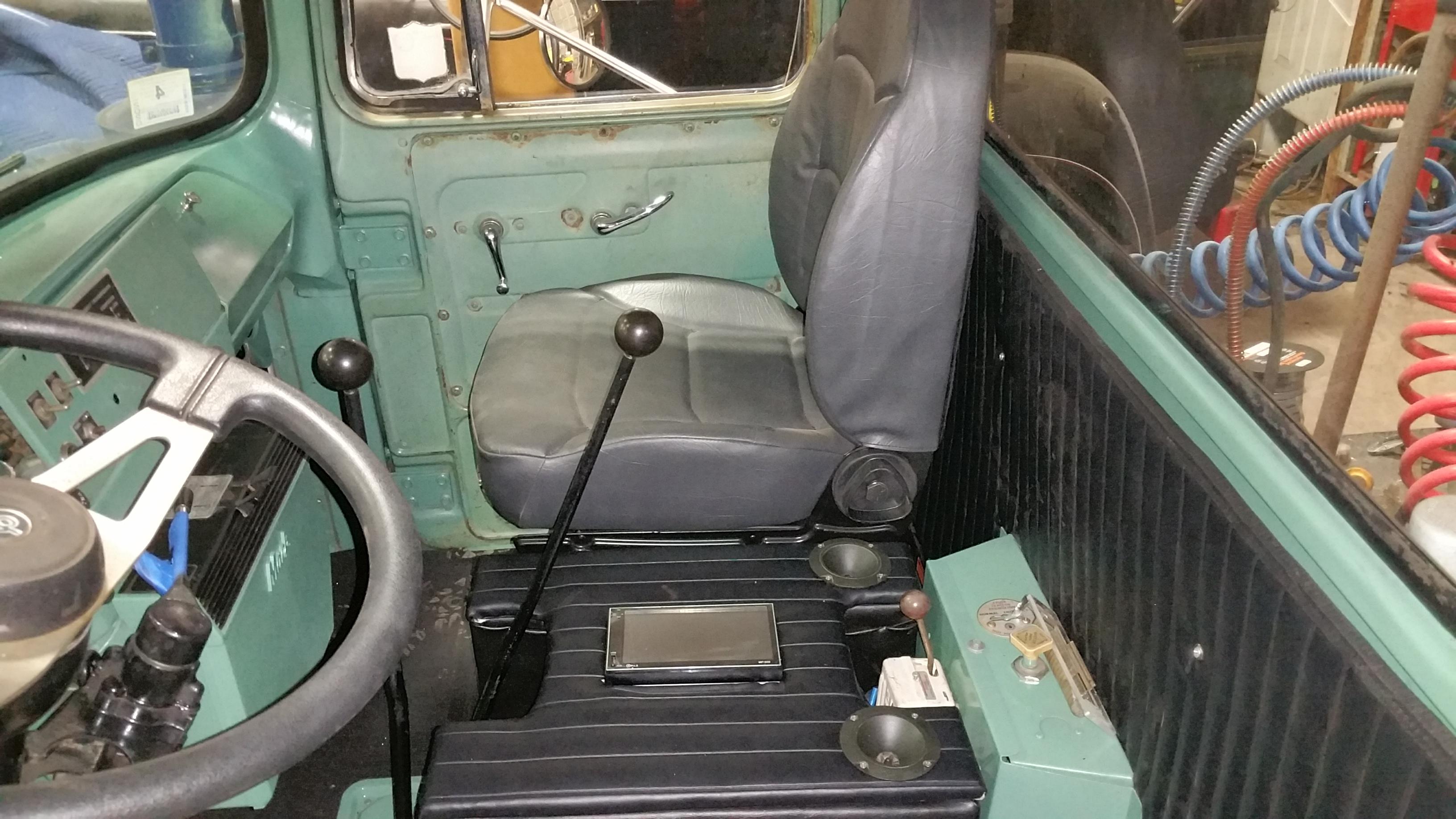

Dynamatting well under way. Ordered 2 new airseats and made up new floor brackets for them. Got some pleated black vinyl material coming for back of cab, door panels and firewall. Going to get a new floormat too, might as well at this point..
Amazing how this stuff can snowball, I really just wanted to get the windshield wipers working again.

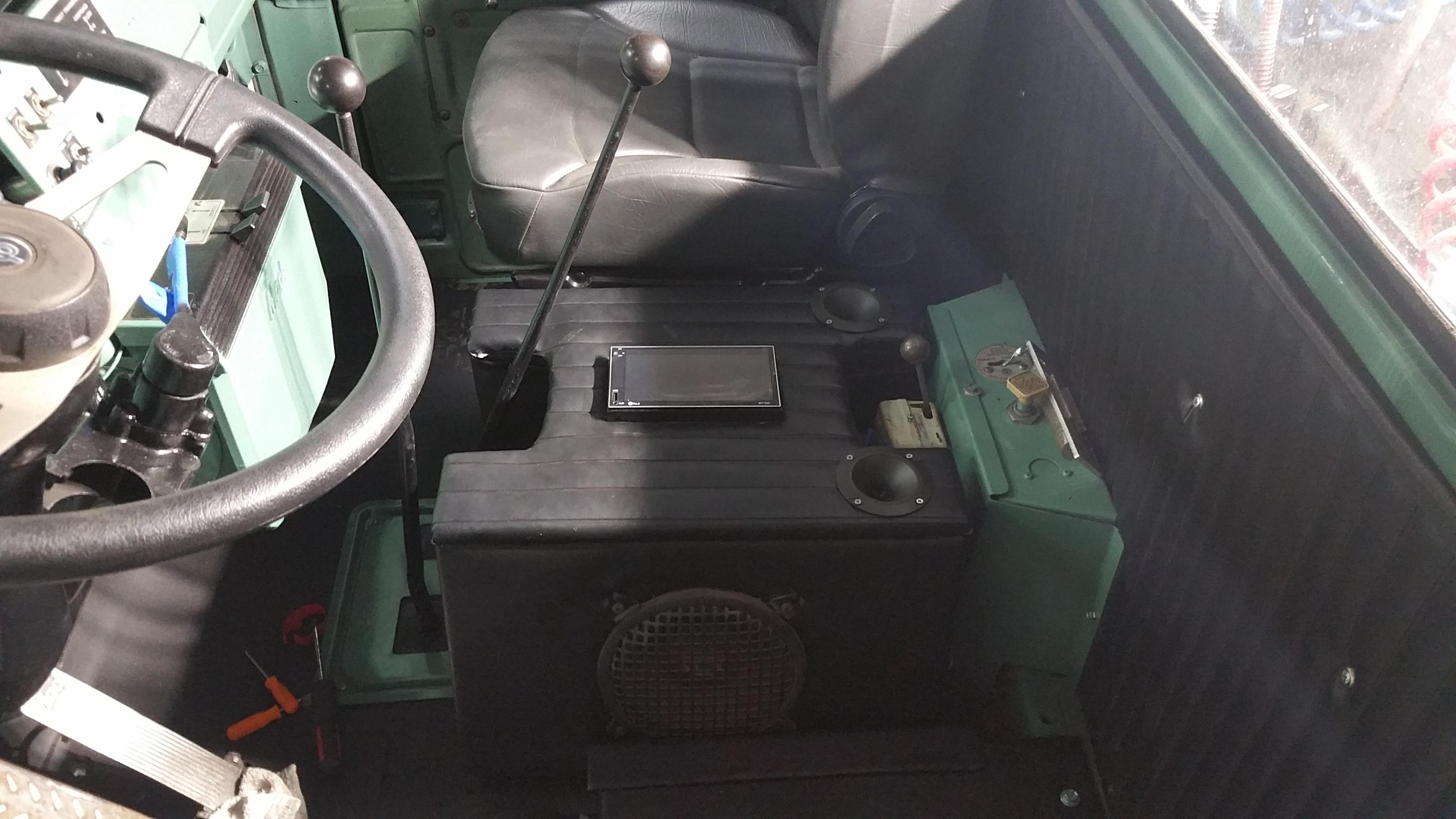

I saw your comment on installing a radio and speakers: check to see if the truck is still positive ground. Mack held on to the positive ground system well into the 70s. The only real issue - besides not reversing the battery cables - was radios. Any of the aftermarket radios were negative ground and just reversing the red and black power wires resulted in making the chassis of the radio hot. Many bad things followed, as you can imagine. I do remember converting several trucks to negative ground but it's been too long to recall if the alternator had to be replaced.
This one is negative ground
