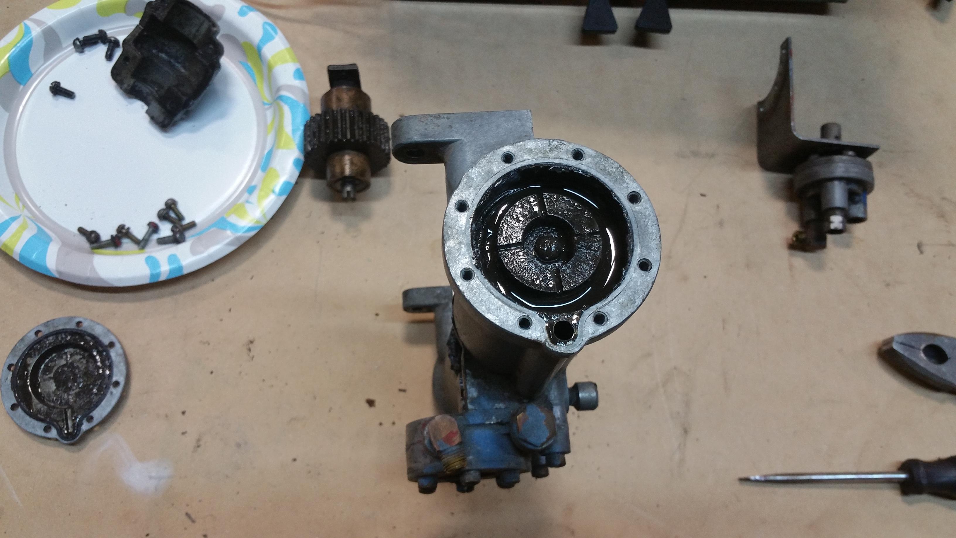

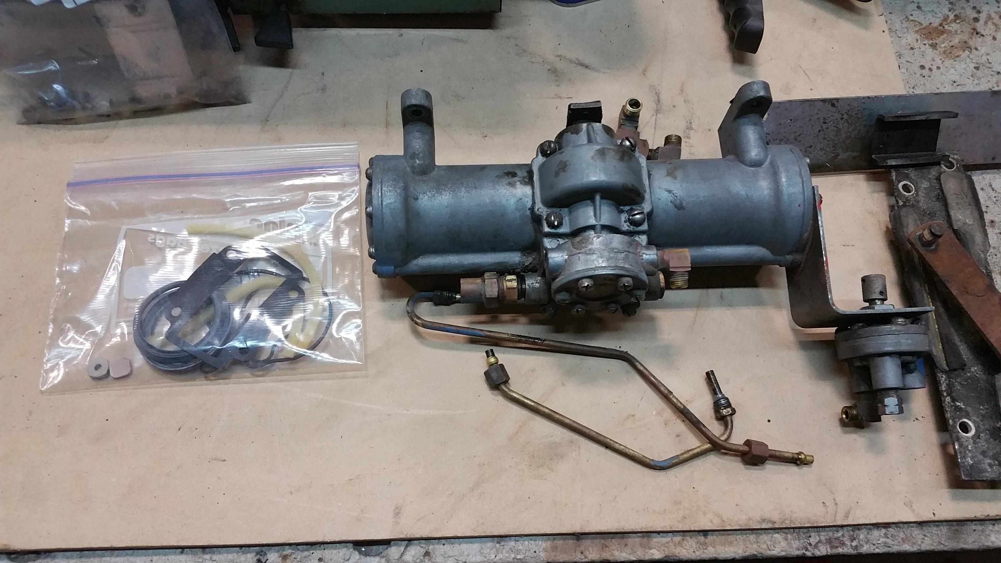

Thanks for the tip on that wiper air motor rebuild kit. I have electrical setup off a RD cab but using original old fashion air driven unit seems more authintic and interesting. Can you share the part # of that kit?

Hi Vlad the kit was a zip lock sandwich bag with the seals and o rings in it, no part number, very informal. I called them and gave them the numbers off the end of the wiper motor and they mailed it out. Their website is rometruckparts.com.

Did the same with my A-40 several years ago. Good people to deal with and straight shooters with information.

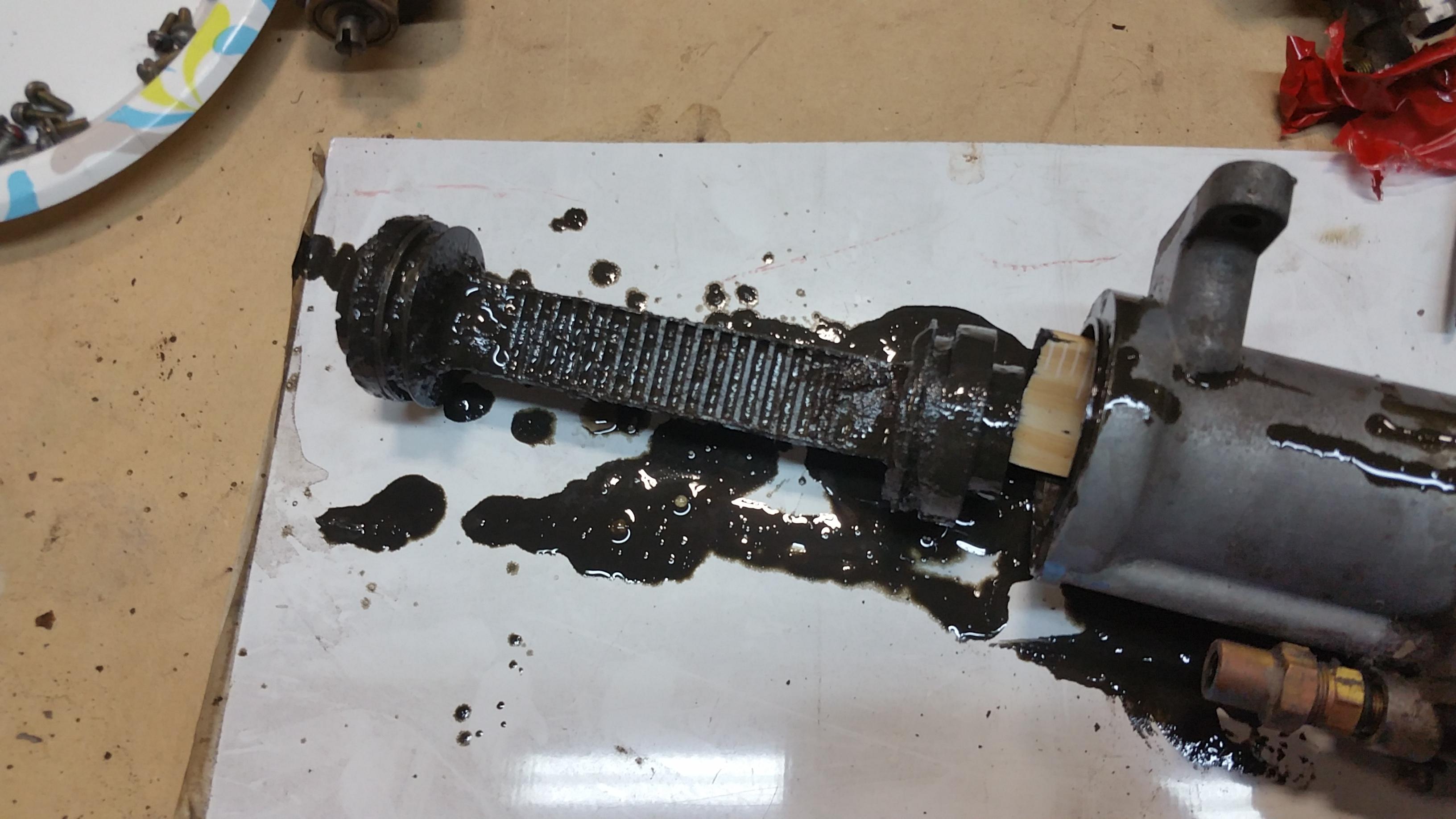

Next on the list of "time to fix up" things that need to be done are the wiper motors. I tried removing the air lines and squirted WD-40 in the motors and air lines before reattaching. No Luck. The wiper might be slightly better but not by much. I looked at that wiper issue for the past 1-1/2 years and was hoping it wouldn't come down to removing and dismantling them but I've given up hope and I still don't feel any better.

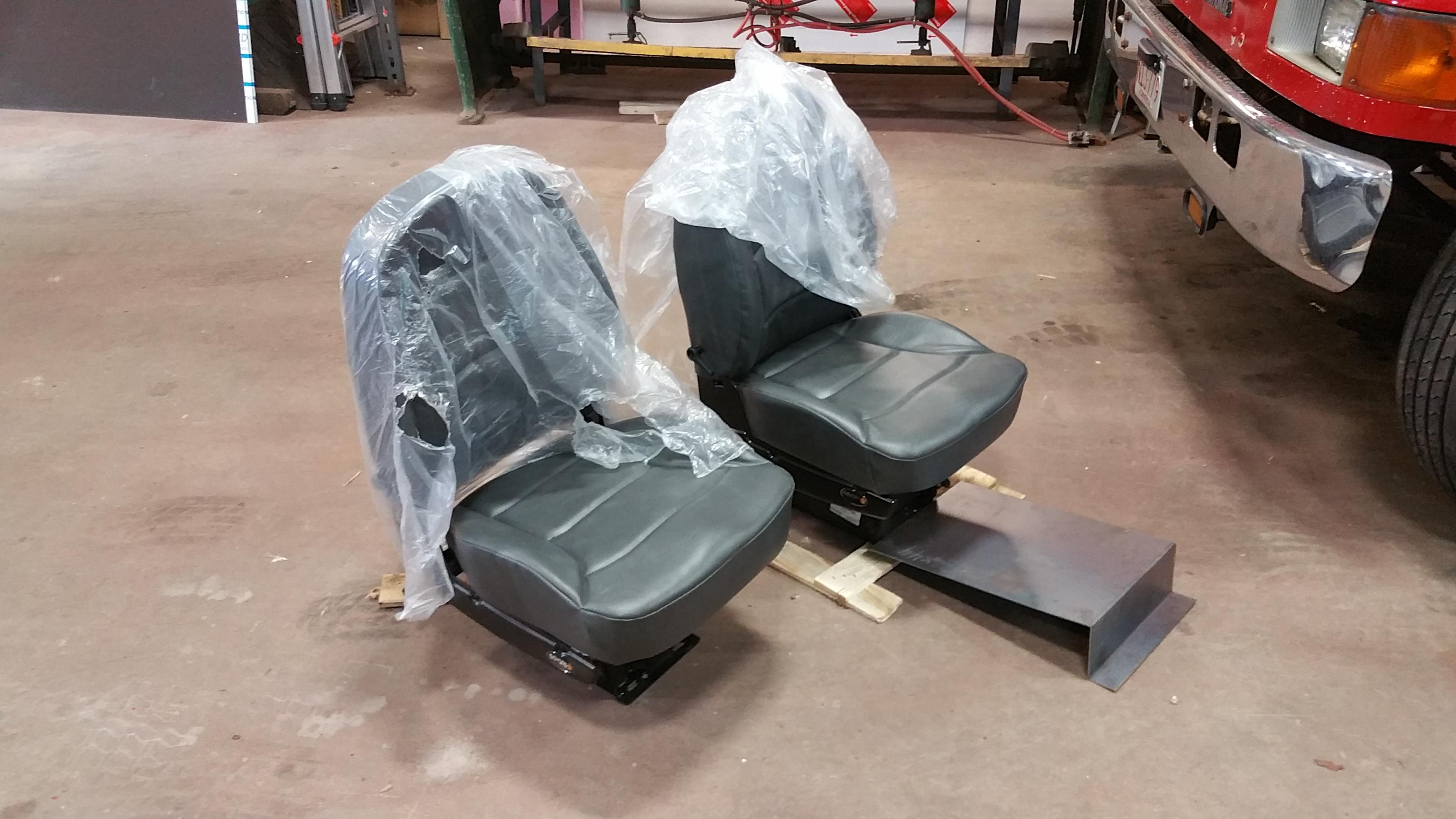

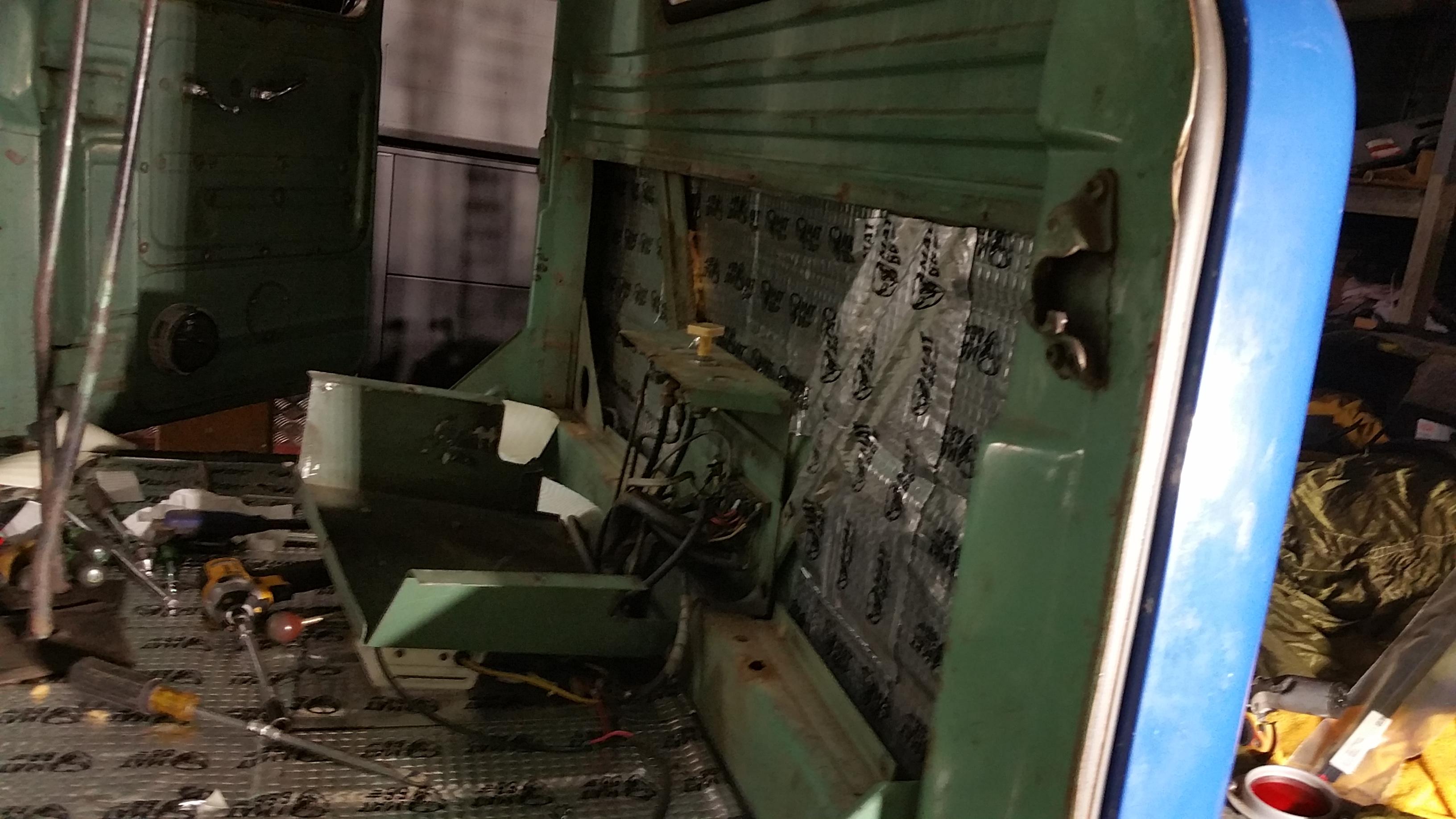

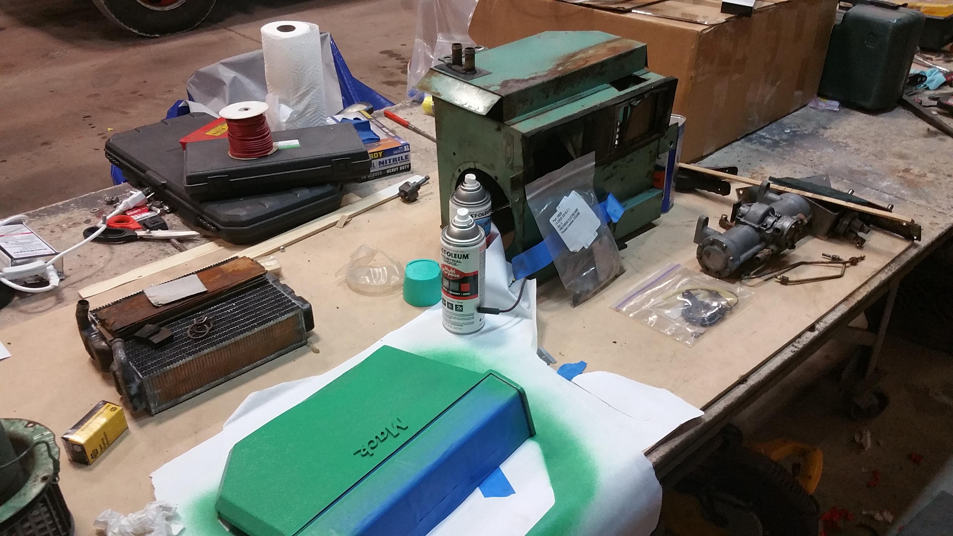

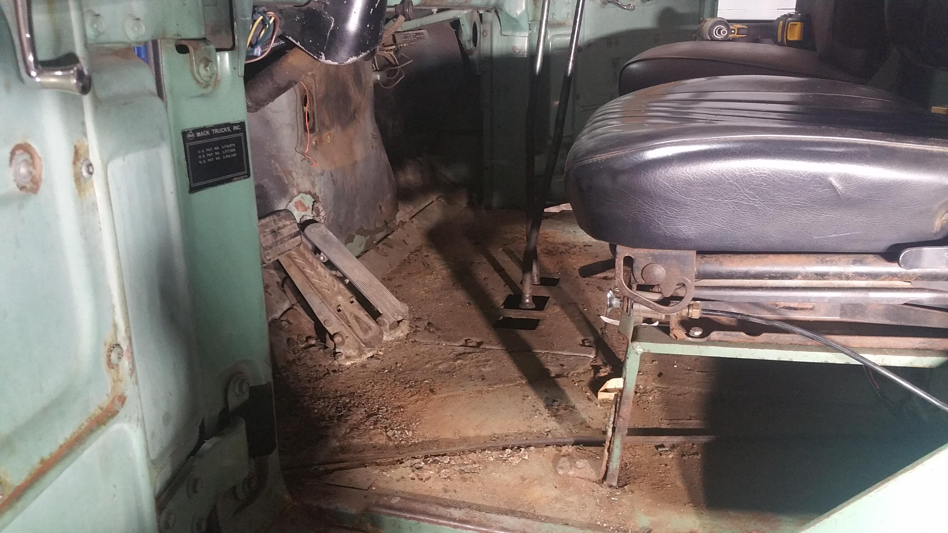

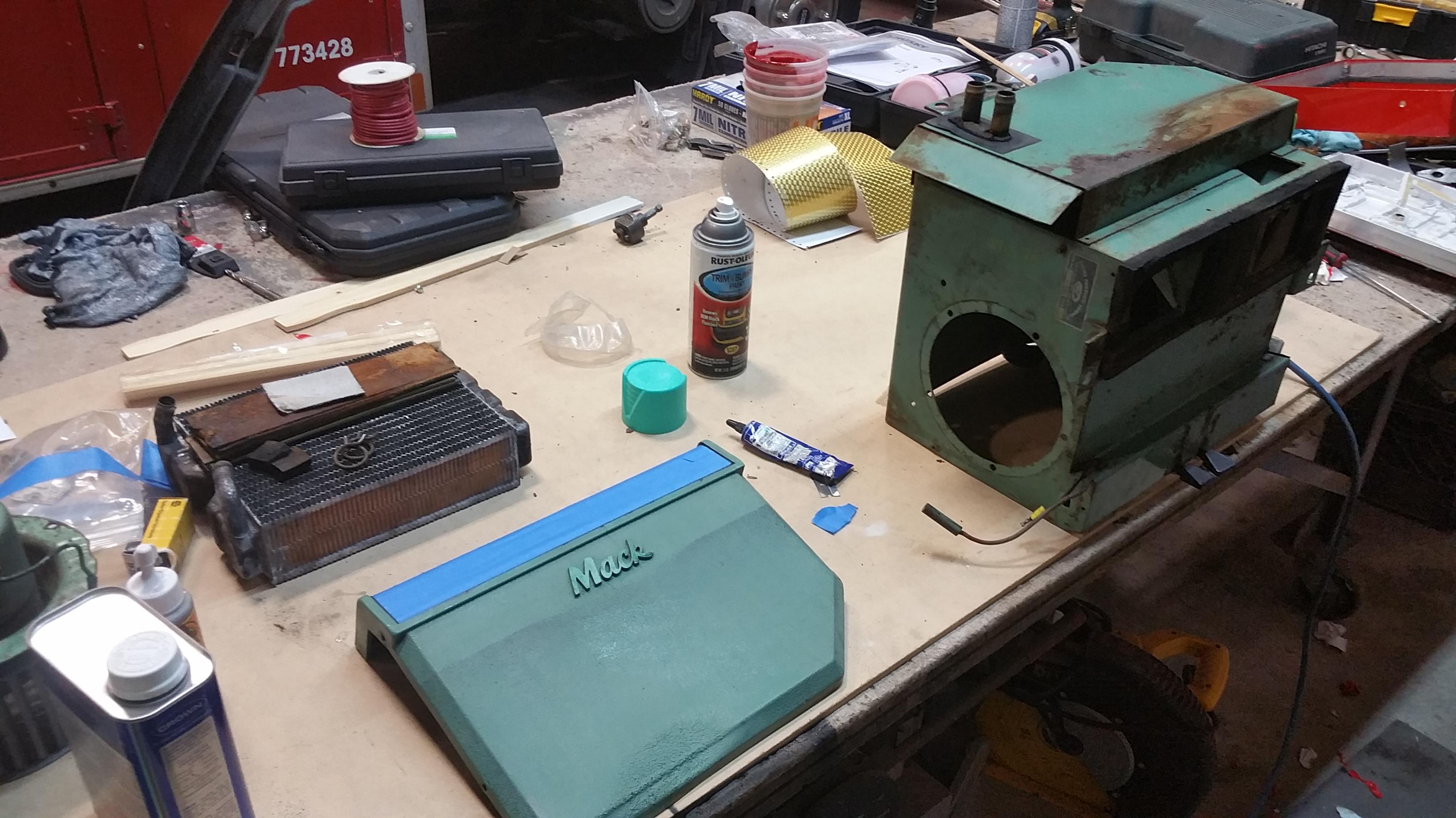

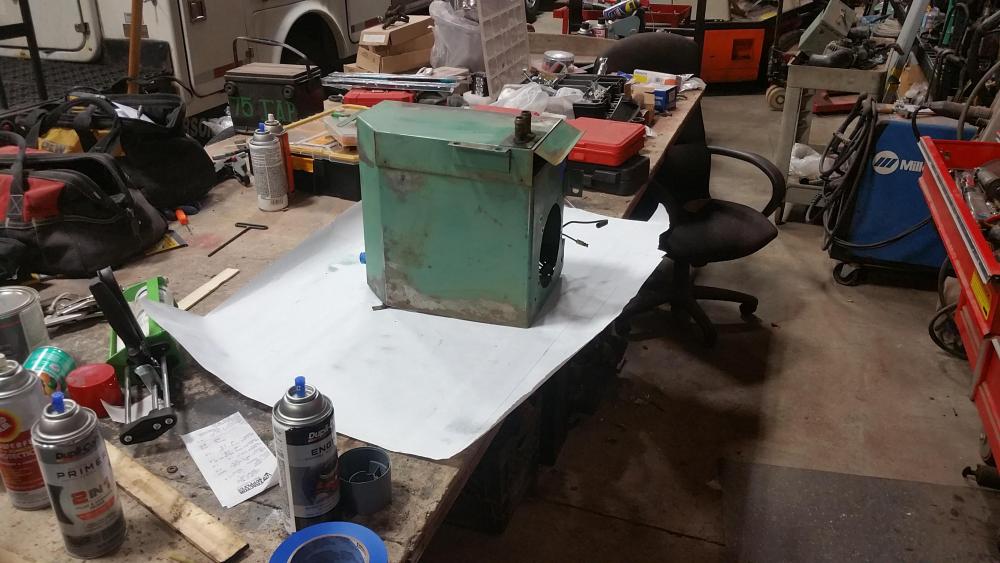

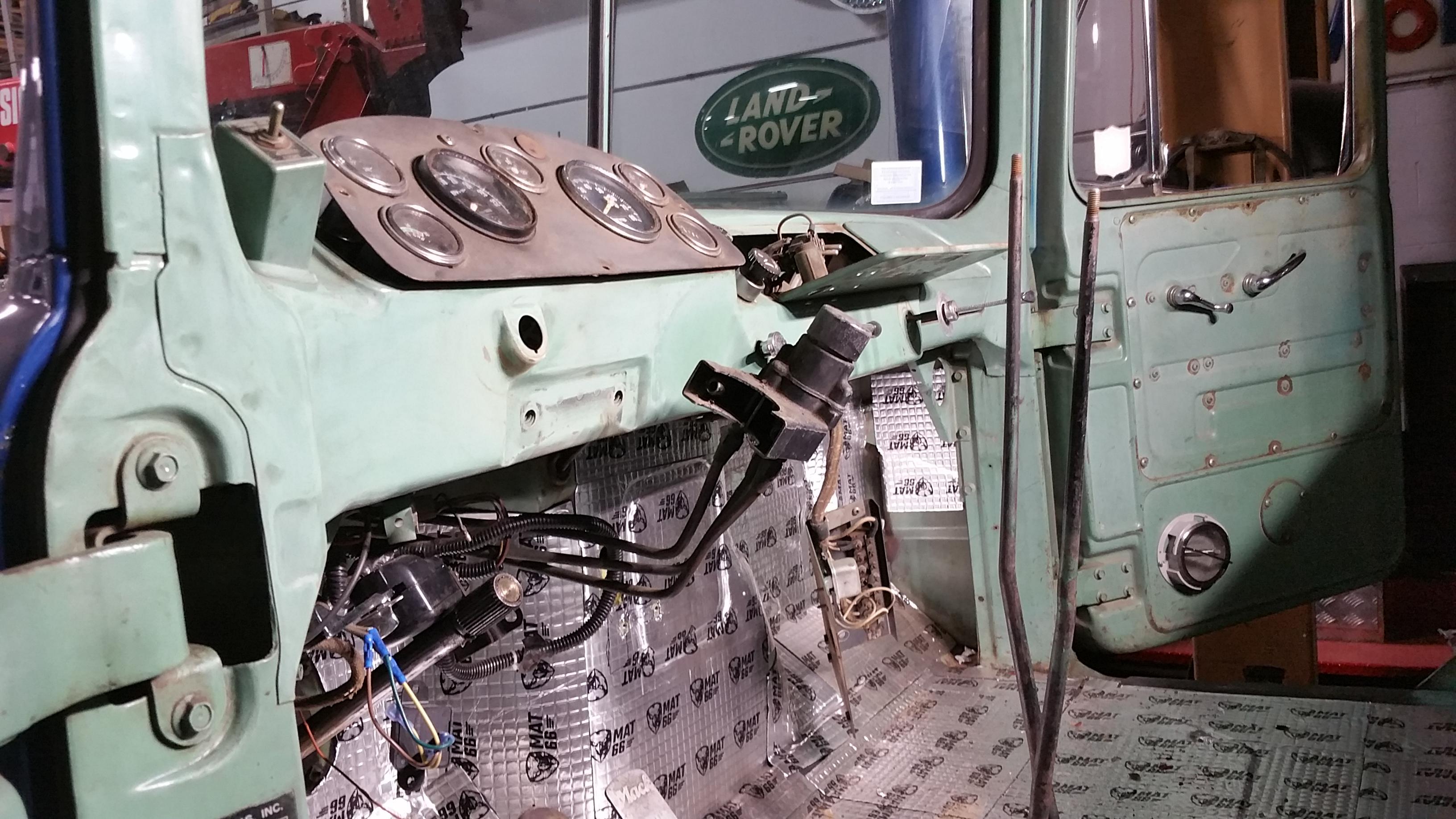

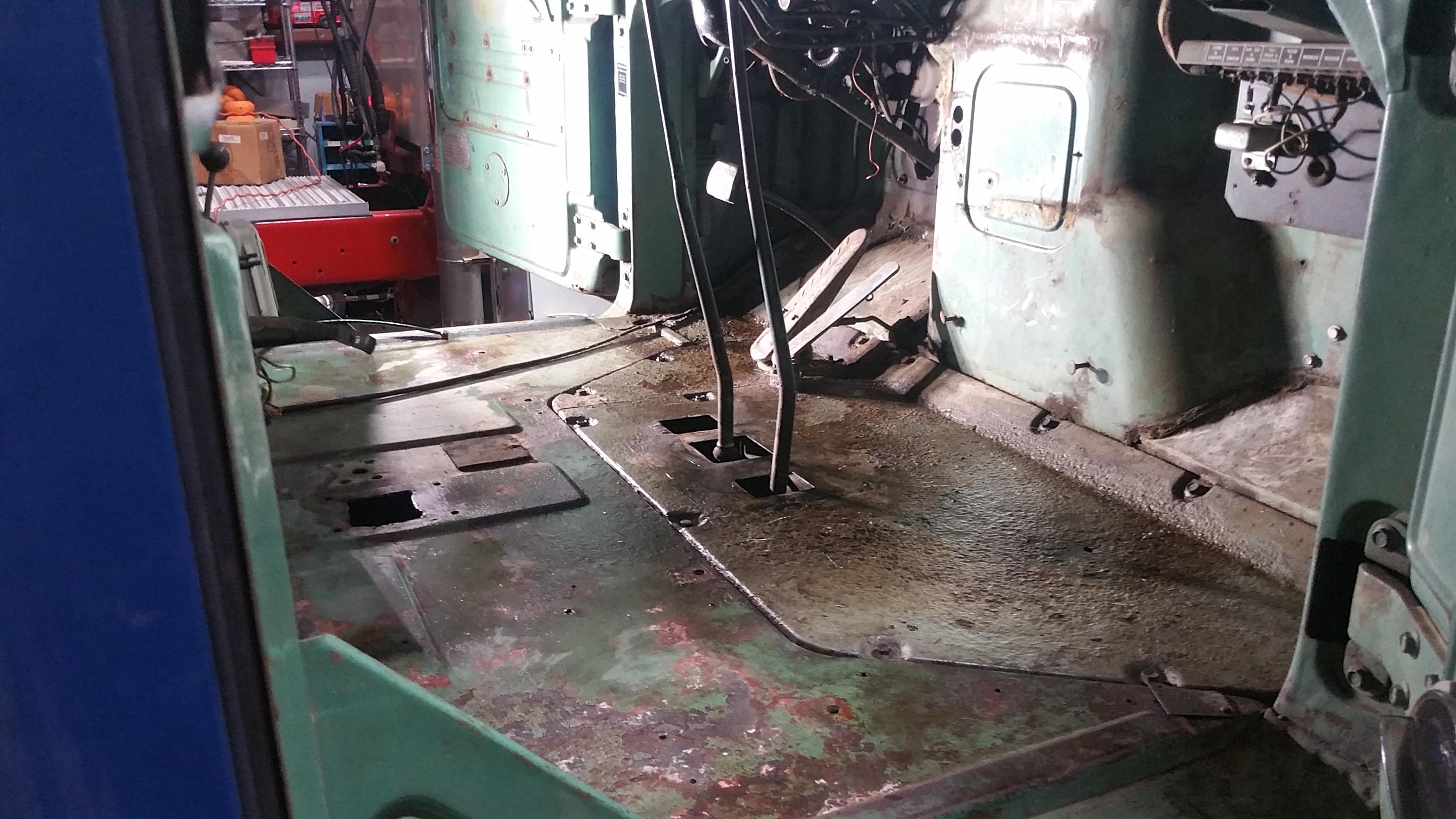

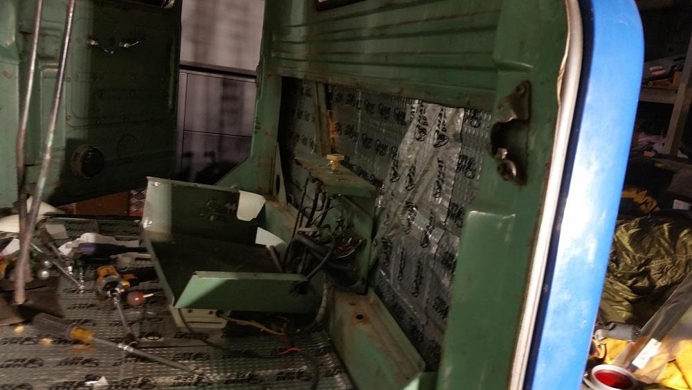

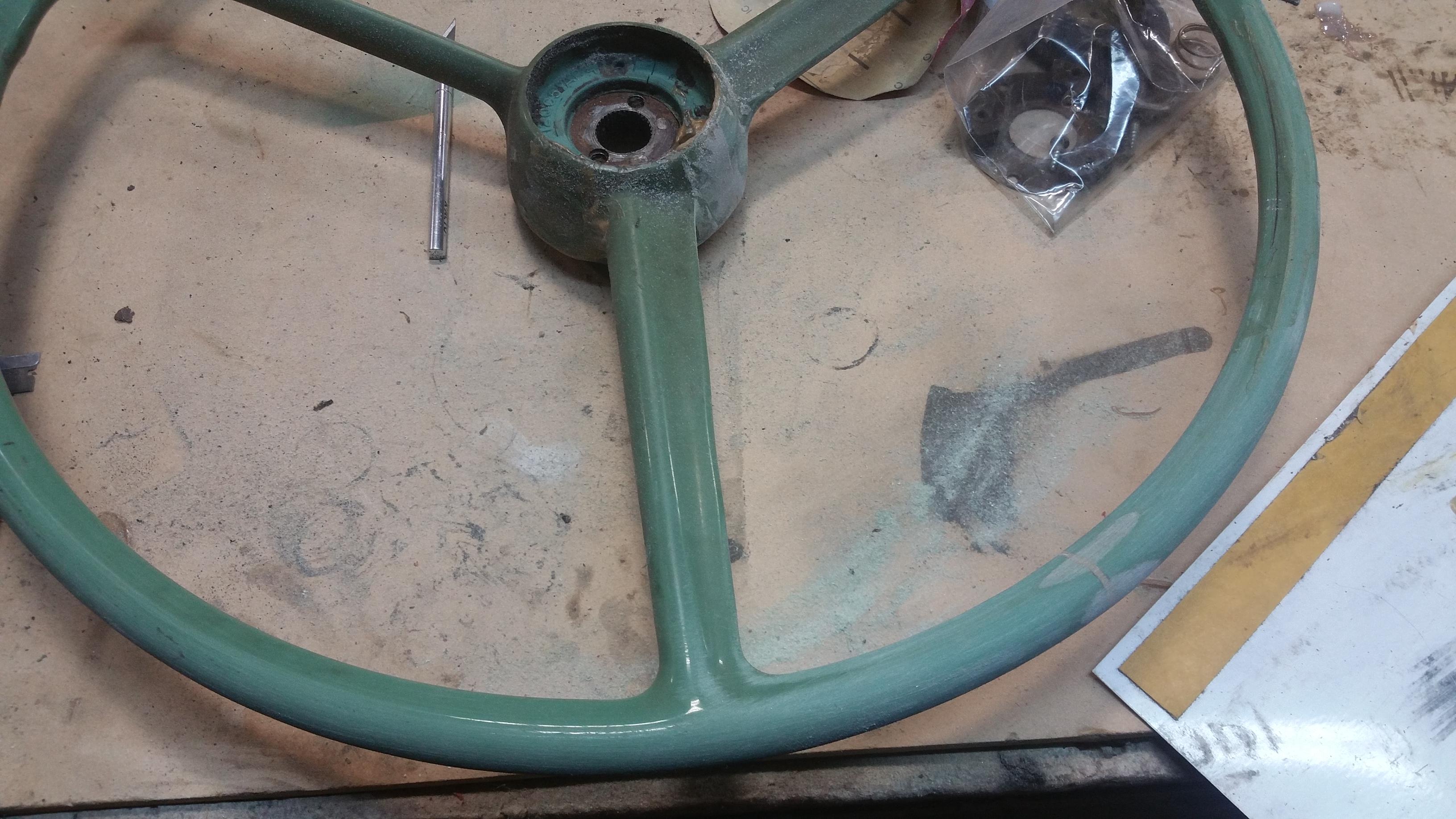

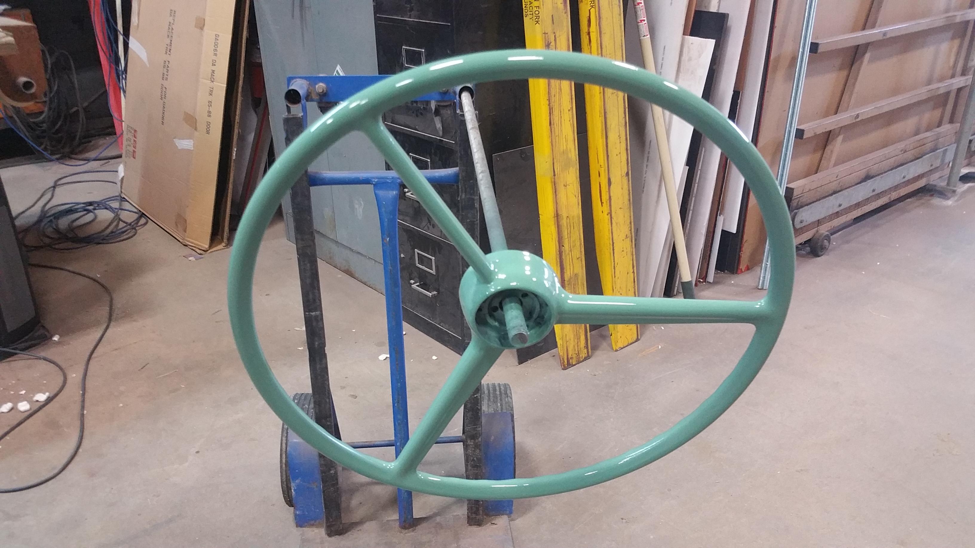

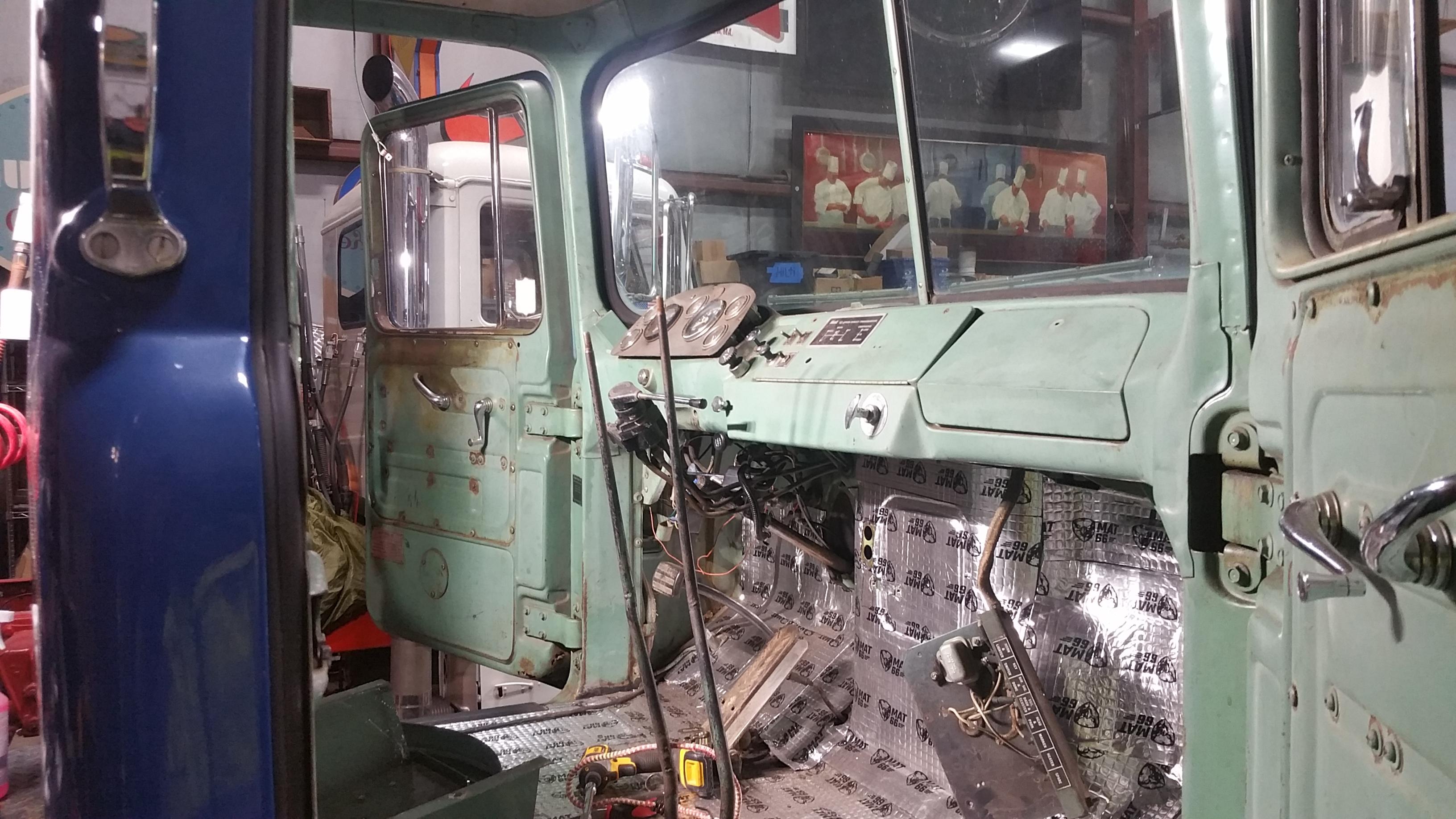

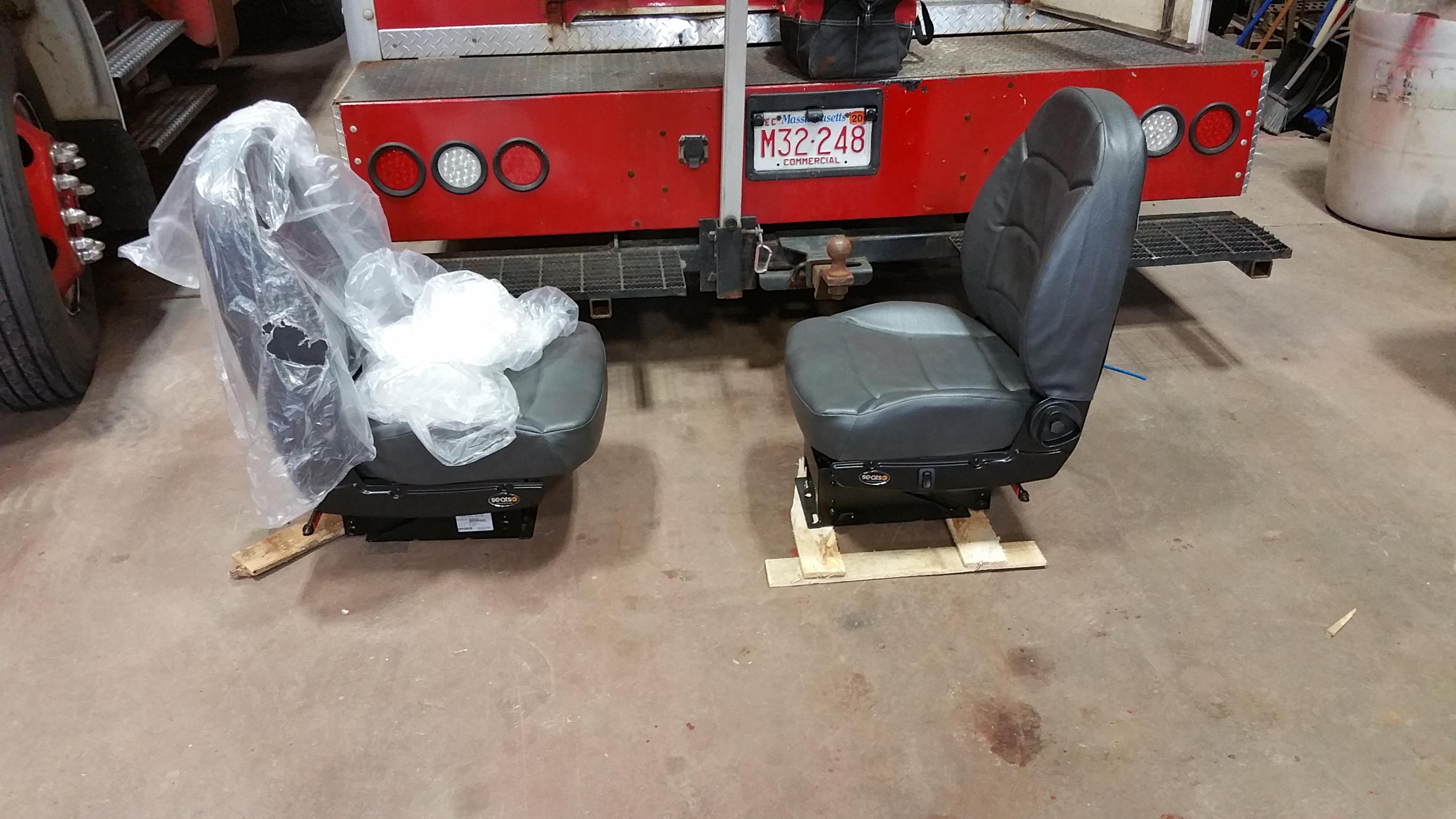

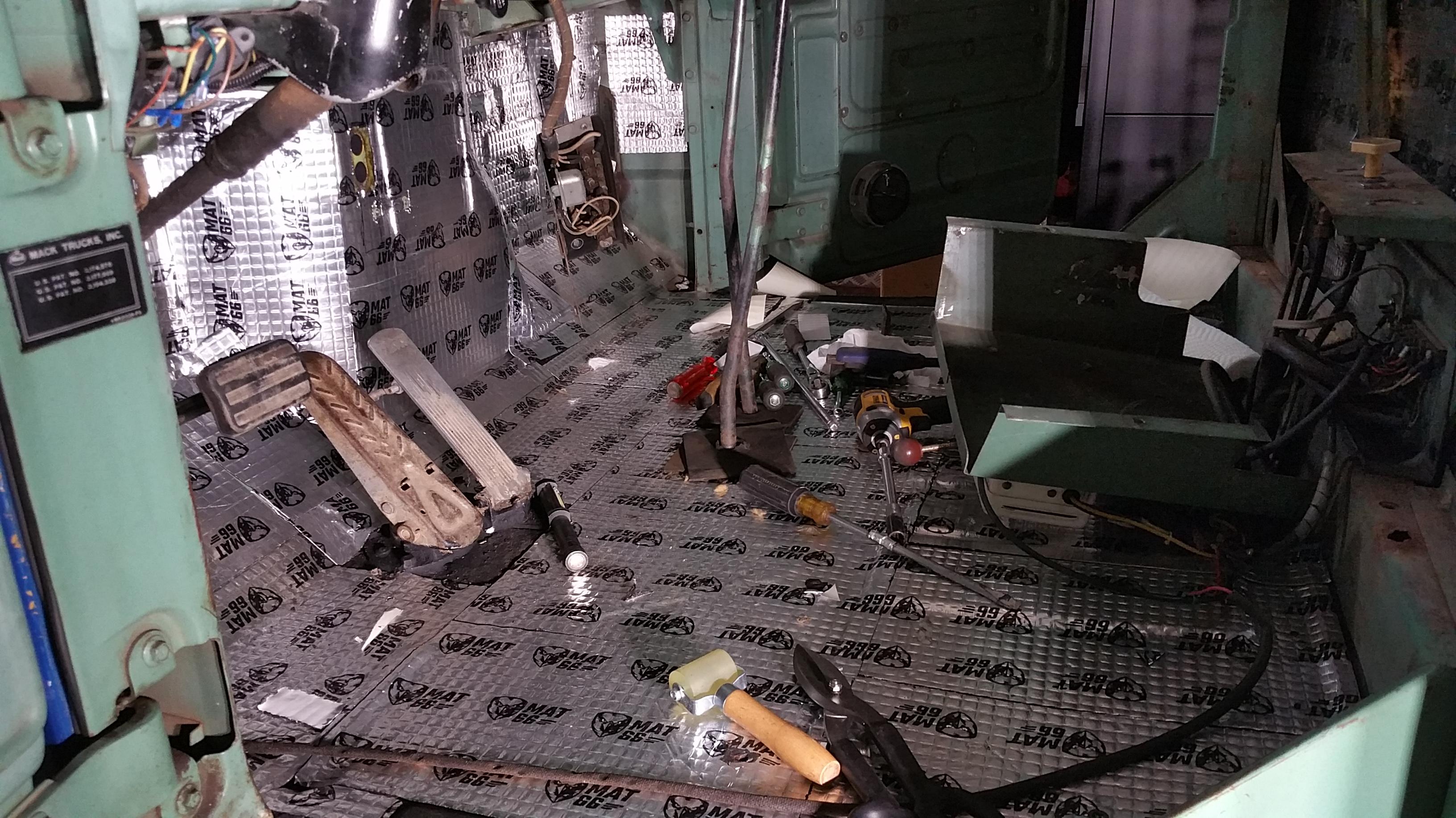

Stripped the interior,  it was pretty grubby and acne scarred under the floor mat. Scraped, chipped and wire brushed it before a heavy coat of rust reformer. Next stop brush on bedliner on the floor and a full covering with dynamat. Ordered 2 new midback air seats today too. Epoxied up the cracked steering wheel and squirted some paint on it.
Awesome work! Thanks for the pics.
My truck has insulation on the firewall, and I’ll just found a rust hole in the engine bay which has started from the inside. So looks like it’s all gotta come out now.
Is the insulation for noise or heat or both? If it’s just for noise then I plan on doing what you done and dynamat the lot.
Thanks Tim, I did it for noise but it might help block some heat, The vinyl that's going on the firewall has some foam bonded to it so that should help too,
