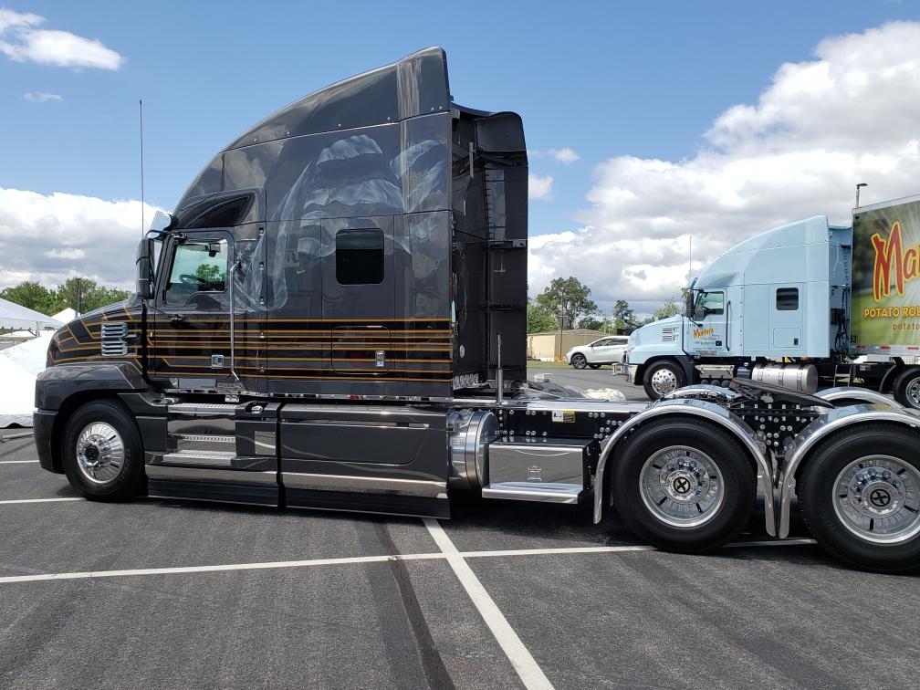

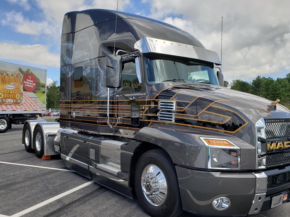

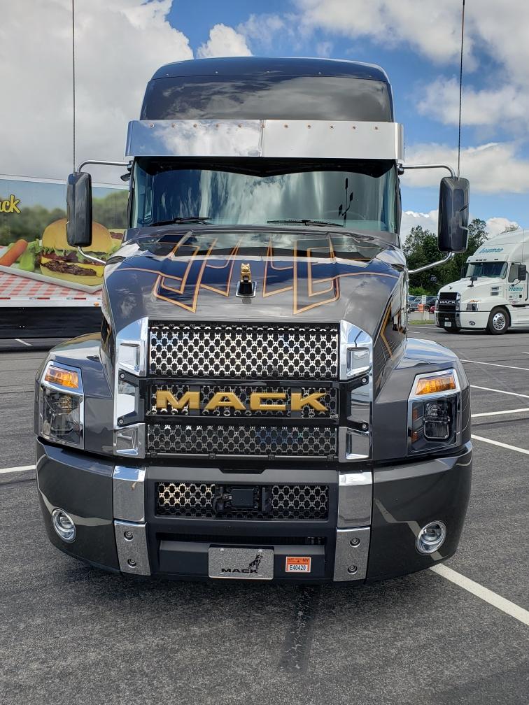

Zach Brown’s new Anthem
Thank god Mack made those snail ears optional. First thing I asked the sales rep was can I get one with out the snail ears.
That stripe job would look nice...on a Pinnacle.
I don't hate everything about the Anthem. They should have put that grill and front bumper on the previous generation Pinnacle and left it like that.
I hate those Anthem headlights and the giant screen doors they stole off someone's cottage for the air intakes on the hood.
