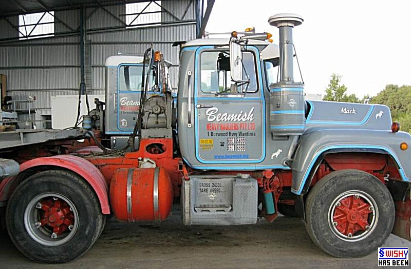

U and DM 600 series rear body panel is bulged and not a full +3 , uses pre 73 roof. That give the more rounded look. The +3 R series in flat as per Hollander Crash books.
Well I  believe the plus as you blokes who call it was a Australian first thought of and produced down under deal
Due to a shortage of cabs from states Mack Australia made its own R model fiberglass cabs  for a while and these were the first to have the buldge in the back of the cabto allow for it to be double skinned
When the US saw this they set about making all R models the same
This story has been told to me several times over the years and l believe it is even mentioned in the book about Leader trucks which were made by the same company  that owned Mack Australia at the time
Paul
I think the U model came with the flat backed cab as standard to preserve the 90 inch BBC but could be specd. with a plus 3 cab if BBC wasn't critical.
I think the body line crease behind the grab handle appeared in the late 70's but wasn't present on the earlier plus 3 cabs. Apart from that I can't see any difference in the curvature of the plus 3 back panel.

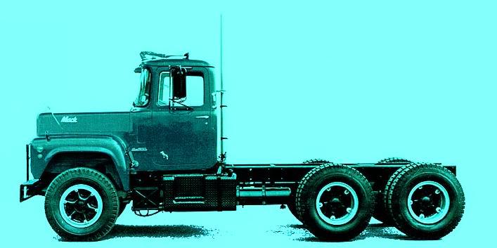

3 hours ago, Rob said:
If I remember correctly the "U" series never got the +3 cab. The "flat back" cabs always had the small grab handles like the B series used, (at least here). This is my 1972 parts R-685, and a B series cab:

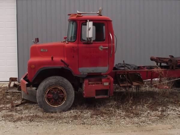

I've got a U single axle dump with the long handles. I forget if it's a + cab or not.
We purchased 4 or 5 of these in the mid 1980's used.  They were late 70's/early 80's models and they had the long grab handle. These were great little city tractors. Power steering, A/C, with a pup you could almost do a u-turn on a city street with them.
If I am not mistaken some of the early U models had the bump for the short handle but used a U shaped long handle that started from the top two bolt holes, then came out and down a ways then doubled back up to connect to the bottom two holes. I believe I had one of these handles out in my shop, I will have look to see if it is still there.     terry:MackLogo:
