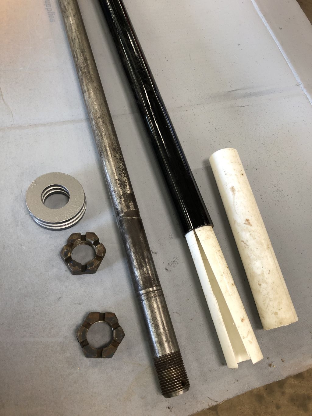

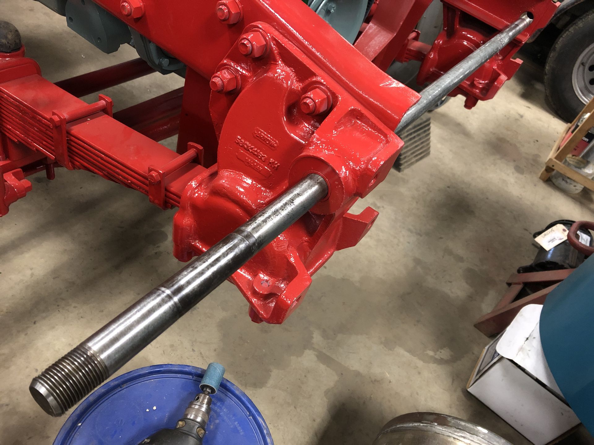

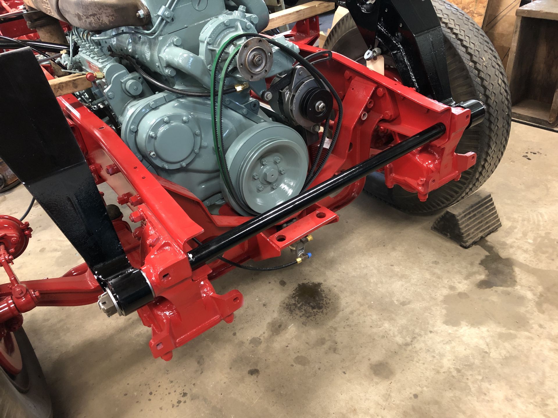

Instead off Die grinding those new Cab Pivot Bushs, I would 've loosened all the Nuts & bolts on both Spring hangers, Installed the Rod & Cab mount Brackets & then Tightened the Spring hanger Bolts Up.
But to each His Own.. You'll have a very Nice Truck when Completed..
PS: I've sent you a PM..

i think the machining was the real issue,,,,,happens quite often on aftermarket purchase i used to ride harleys,,,,alot of thier add on chrome dont fit,,,without alternation...generally shipped in from  china...,,,bob
