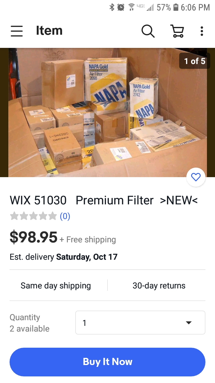

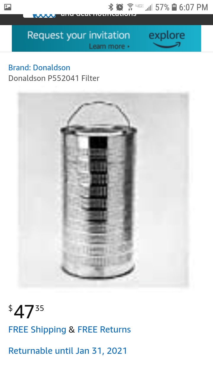

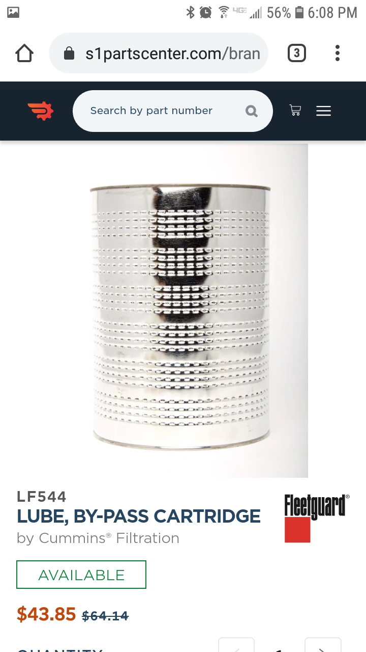

For oil filters it is not uncommon to have several oil filters on a truck. The large one with 1" lines is a full flow filter right from the oil pump. The smaller one is normally a bypass filter for other engine functions.
  • Thanks 1
After I found 3 of the cross reference filter numbers I called it good. You need to find a GOOD parts place. My local napa pretty much refuses to use their books and if they dont want to order you something they will just say it's not available. This is why I mostly deal online. If they dont need to help me I don't need to go there. Find a local big truck shop. They WILL get it for you, if they dont have it.
I'm no expert (far from it in fact) but I'm pretty sure you cant just remove the hoses and plug the ports.
I ordered 4 of these filters off ebay a month ago. They're still being made.

I can post the dimensions of the filter.
If you take the filter element out, it should have the number embossed either on the steel sides or on the top of the filter element.
Mine is a luberfiner 500c and takes a 51554 cartridge.
