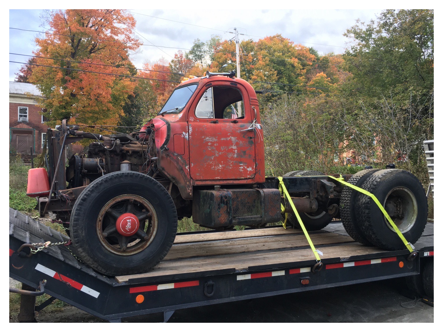

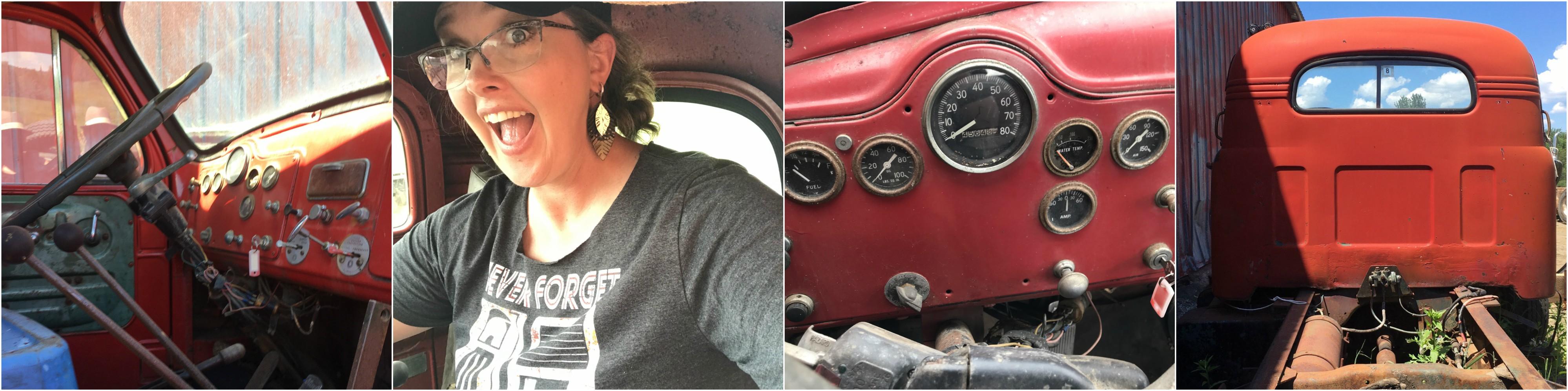

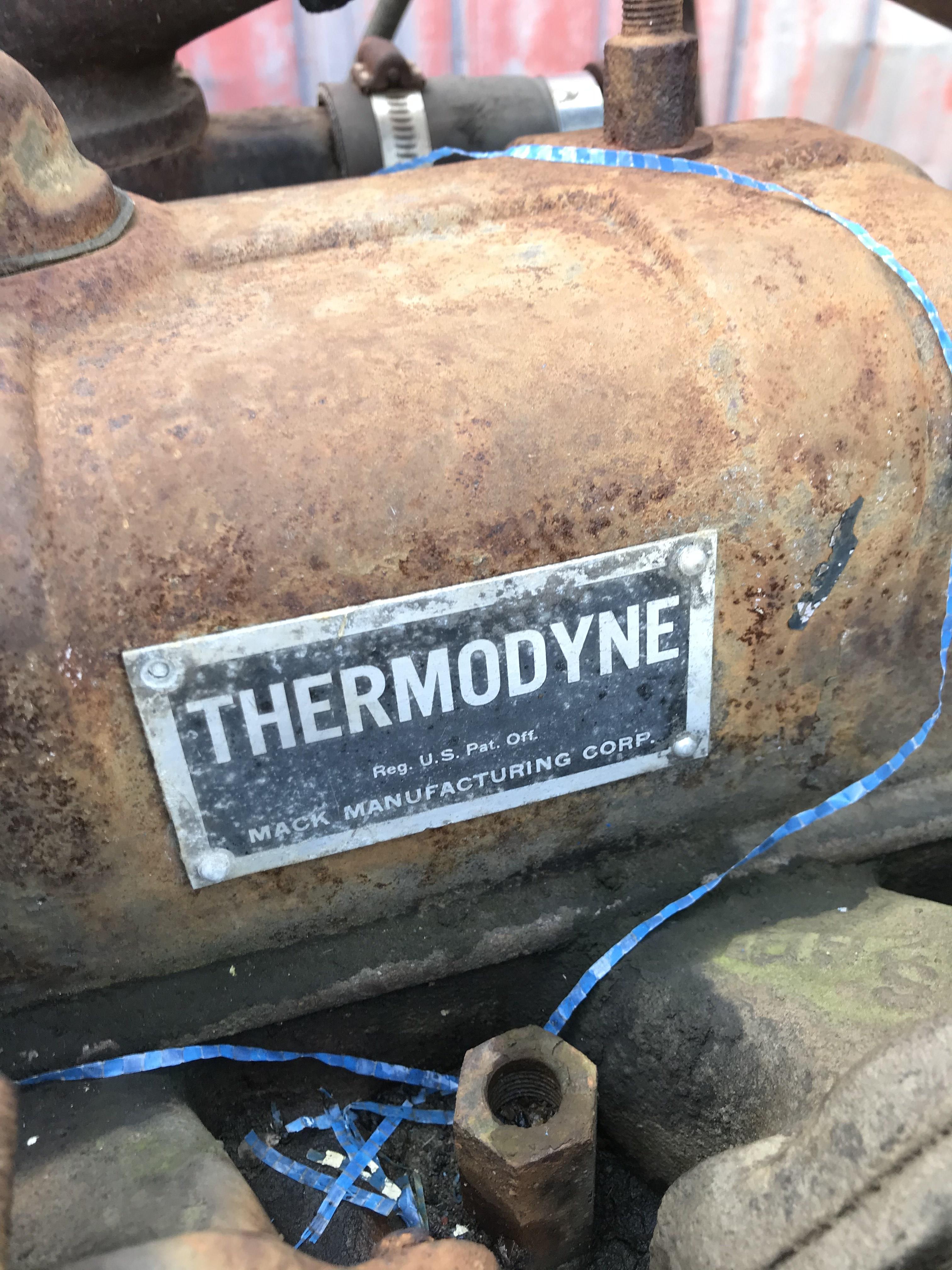

A B60 would have originally been a gas-powered model (Magnadyne?).  The dash suggests this, as well (no tach).
It there is a Thermodyne engine under there, that suggests 2 possibilities; (1) Someone has already swapped out the gas engine for a diesel.  In that case, the rear gearing should have been swapped out to get more speed, as the gassers were typically geared pretty deep.  Or, (2) someone may have put a good, solid B60 cab onto the chassis of a B61 that had had its cab rust away.  Would need to check the serial number on the frame to be sure.
Either way, that sure looks like a great starting point for a project!  I look forward to seeing your progress.
Link to post
B422,B60, 62,68 B70 all had gas Thermodynes. 438 464 540 707. 438 had the baby duplex and quads behind them, 464 and 540 could have had a 67 nor 77 series trans and 707 had the 72 series. the truck in the pic has a 67 series by lookin at the the shifting levers come out more tward the firewall and angle back. a Tach was an option in any B model. we even have a few B42;s that the tach drives off the distributor. that truck looks like an original gas job B60 as it still has the knob lower left by steerin column to switch the fuel tanks from left to right tanks. gas jobs didnt have a crossover like the diesels
Ah!  Learn something every day.  I guess I missed that there was a gas version of the Thermodyne.  Thanks for that!

with the updraft carb @ 170 hp it's a early 55 or older. middle of 55 they went to a side draft carb @185 hp. also has low chassis number. have fun with it.we had a b-60 in march 55 with updraft carb and second b-60 in may 55 with side draft.both mack yellow log trucks

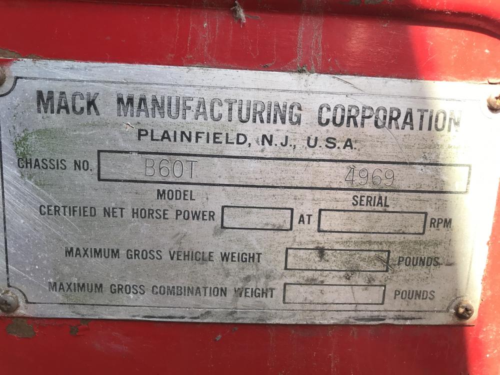

If the truck is 55 or earlier it gives me idea on the chassis number location. In 53 it was stamped at the rear end of the chassis rail not at the front.
I looked tonight and couldn't see anything.  Can you tell me more specifically where I might look on the rear end rail?
Exciting to think I might have an older truck than I originally thought!

pic of the dash and crossmembers in frame would help narrow it down, horns on a pedestal, old style mirror brackers and windshield motor under dash put it at a 58 and older.
