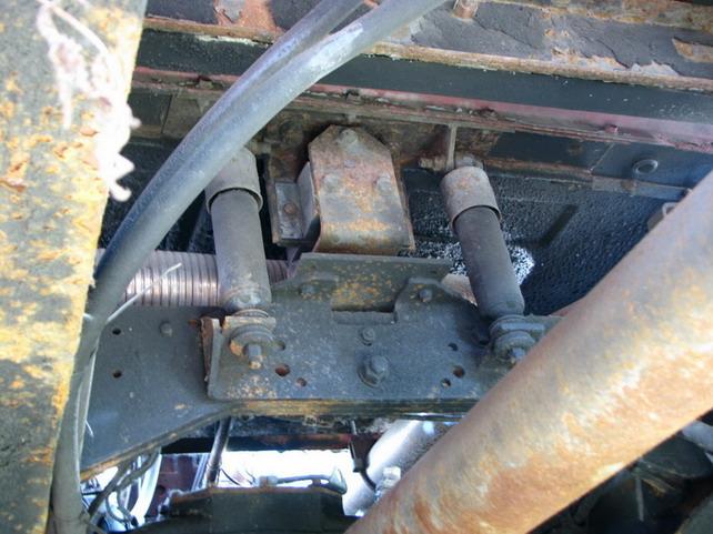

The build sheets for the SuperLiner II Magnum (186) trucks all list "Air Suspended Cab Mounting" as part of the standard package. On all trucks equipped with either size (36" or 60") sleepers, that item is either lined out or marked "deleted".
My truck had the 2 shock absorbers installed as in the picture above and a block of rubber (might as well have been a 2 X 6) mounted where the air bag and control would have been placed.
All of the sleepers I have seen are ridged mounted - just rubber bushings on 6 steel brackets.
I replaced the rubber block on my truck cab with a Mack air bag and control rods and used a modern, flexible cab seal. Seems to work just fine.

Is this what you was talking about? I surprized seeing a non-air suspended cab on a RW. The truck had 36" Able Body.

Vlad- that is the cab suspension (?) that was used with a sleeper compartment - at least on the early trucks.

Yes, that was the cab suspension of 1985 RW613 with E6-350 under the hood. The truck was red with black interior so no possibility seemed it was originated as a Magnum. When I was making the photo I was sure I looked at a cab suspension air bag. And only much later observing the picture I realized there was a solid rubber block not an air cushion. Was too surprizingly to me and your explanation of installing such part to minimize cab to sleeper movements cleared the clouds.
