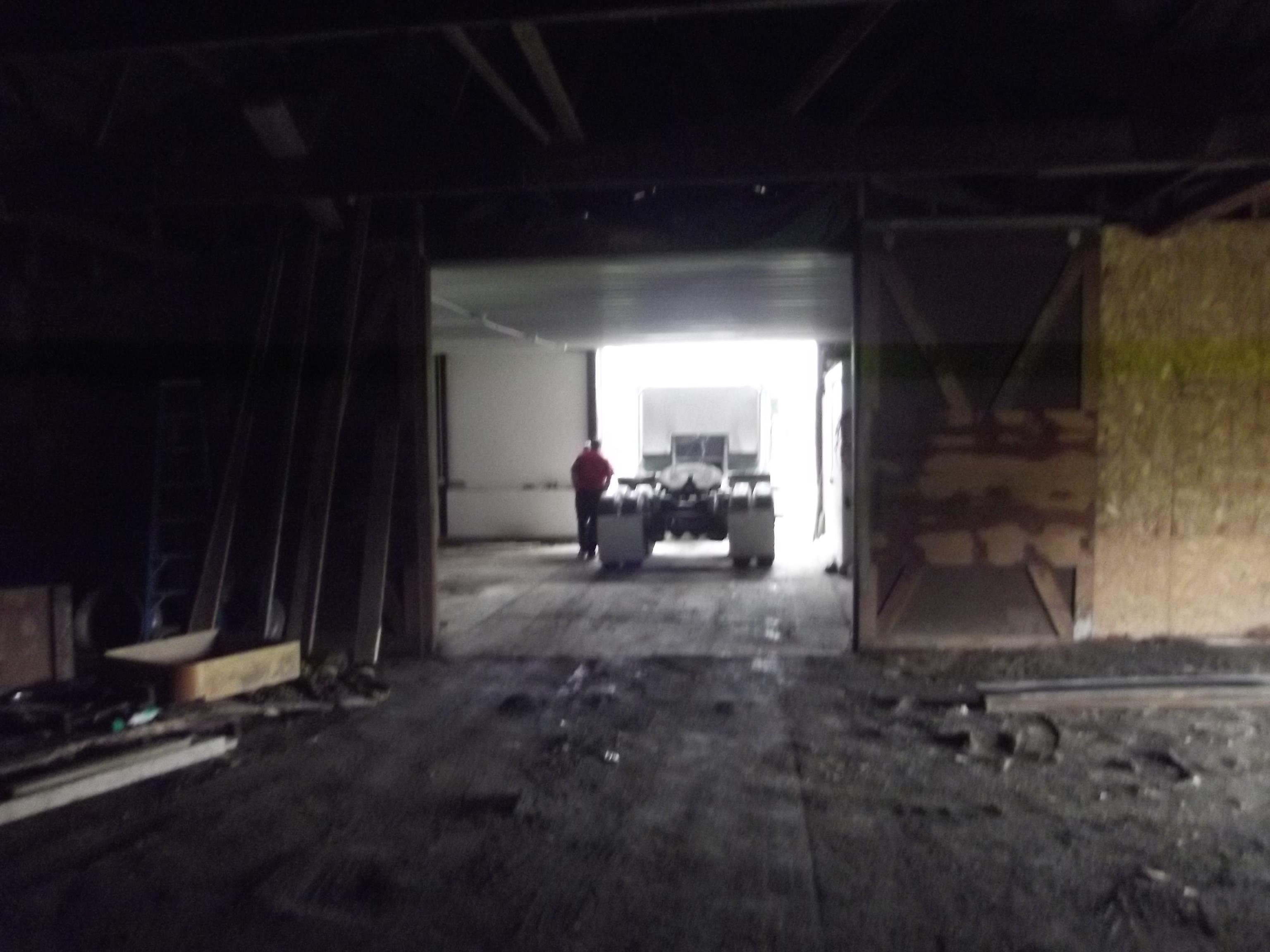

Is that cab as straight in person as the picture looks to be? Looks real nice!!👍👍 terry:MackLogo: On a side note I really like those G models.    Makes want to make an offer on it!!
