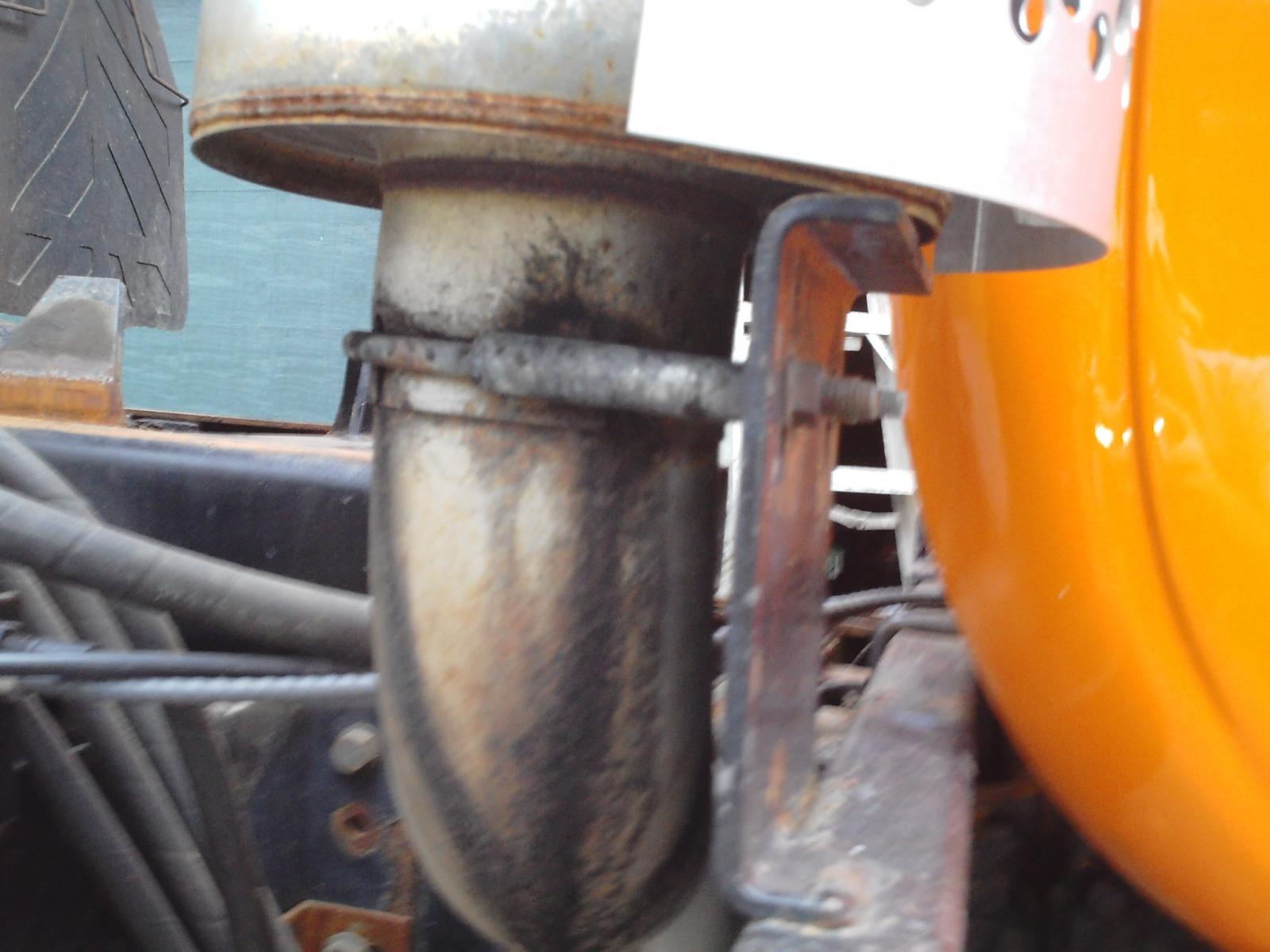

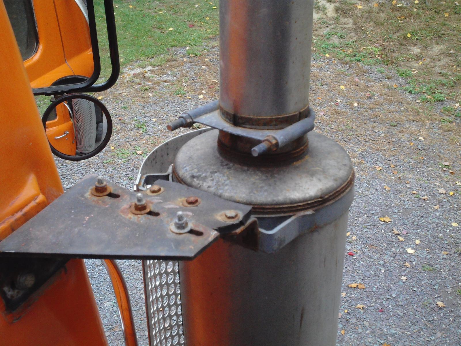

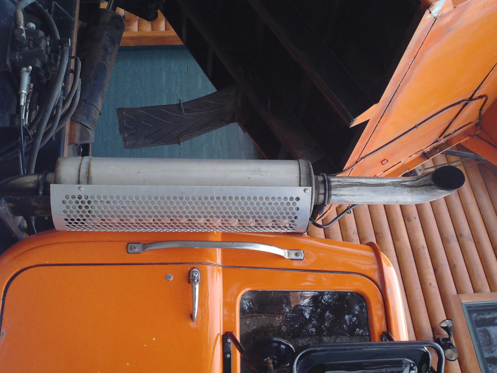

I'd like to replace the stock muffler and exhaust on my 1981 R 600 single axle dump (former state truck) with a 7 inch monster stack. First of all, will this make the truck too loud, and where's a good place to purchase this online ? Raney's Truck Parts has some but they are only reduced to a 5 inch inlet on the bottom and the pipe on my truck is only 4 inch. They don't have any 5 to 4 inch reducers, neither. Any suggestions, guys ?post-12926-0-52350500-1381881738_thumb.jpost-12926-0-63283900-1381881798_thumb.jpost-12926-0-07944600-1381881842_thumb.j
I would step it down to the 4" under the cab maybe so it runs to where the stack connects at 5" and you dont see all adapters, and I have a 5" straight no mufflers on my R model and it is loud but not unbearable(i like a louder truck) personal preference i guess

I got my 4-5" adapter from my local mack dealer, non chrome.
