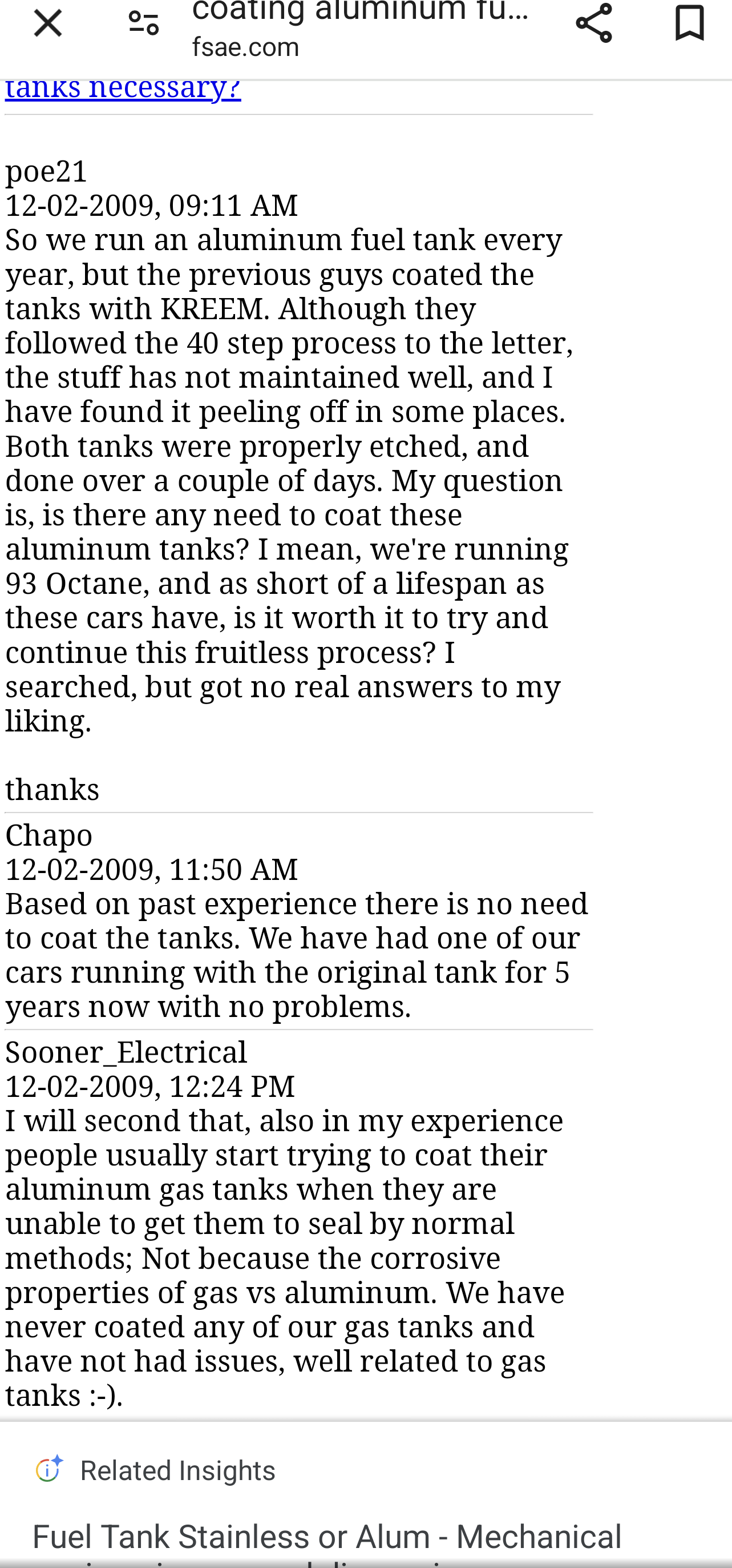

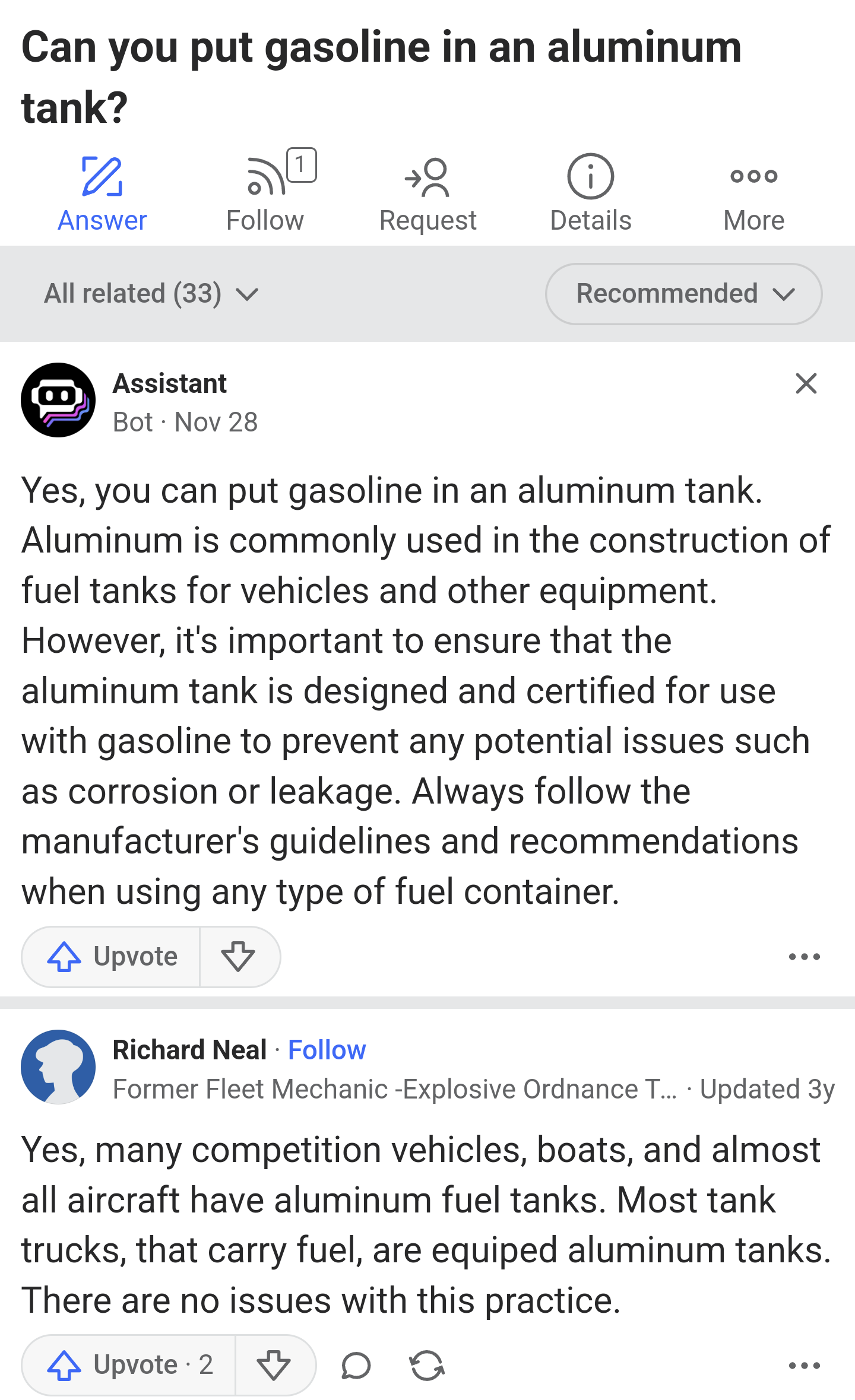

So, my new gas tank came today. And here's the issue-
I called 4 States because they didn't send enough rubber to go under the straps. I misunderstood, I ordered 2 but they sell it by the foot, so I only got 2 feets.
Anyway, the guy asked me if I was using it for gas or diesel. When I told him gas, he said "uh-oh, this tank is only rated for diesel".  I thought it said "gas or diesel" when I ordered it, but apparently it didn't. But it said "fits Ford F600" and they were all gas powered. I don't even know exactly what "rated for diesel" even means, but Dave (maint1) sent me this-
So I'm going to use the tank- any thoughts?
Just now, Joey Mack said:
sounds like you need to put gas tank coating in it while it in a virgin...   sorry, I dont have a picture of a girl in a car..  But I do have this little Peach.. as Bob would put it..  jojo

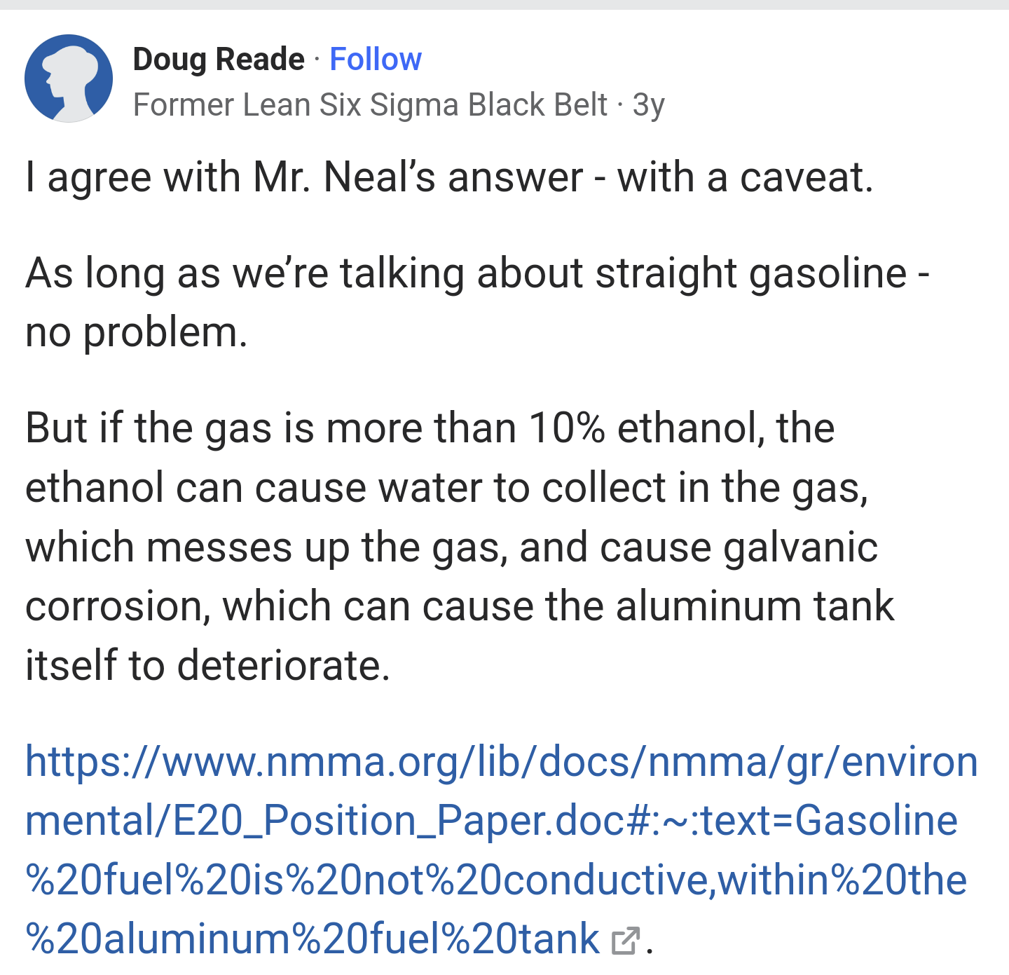

I would, but I heard you don't use sealer in aluminum tanks, maybe it doesn't adhere to the aluminum or something, I don't know. I had 2 quarts of sealer but I already sent it on its way. So I think, from what I'm reading here, if I stick to non-ethanol and use gas treatment I should be ok.
I think you are RIGHT on Non-Ethanol ONLY!!!!!

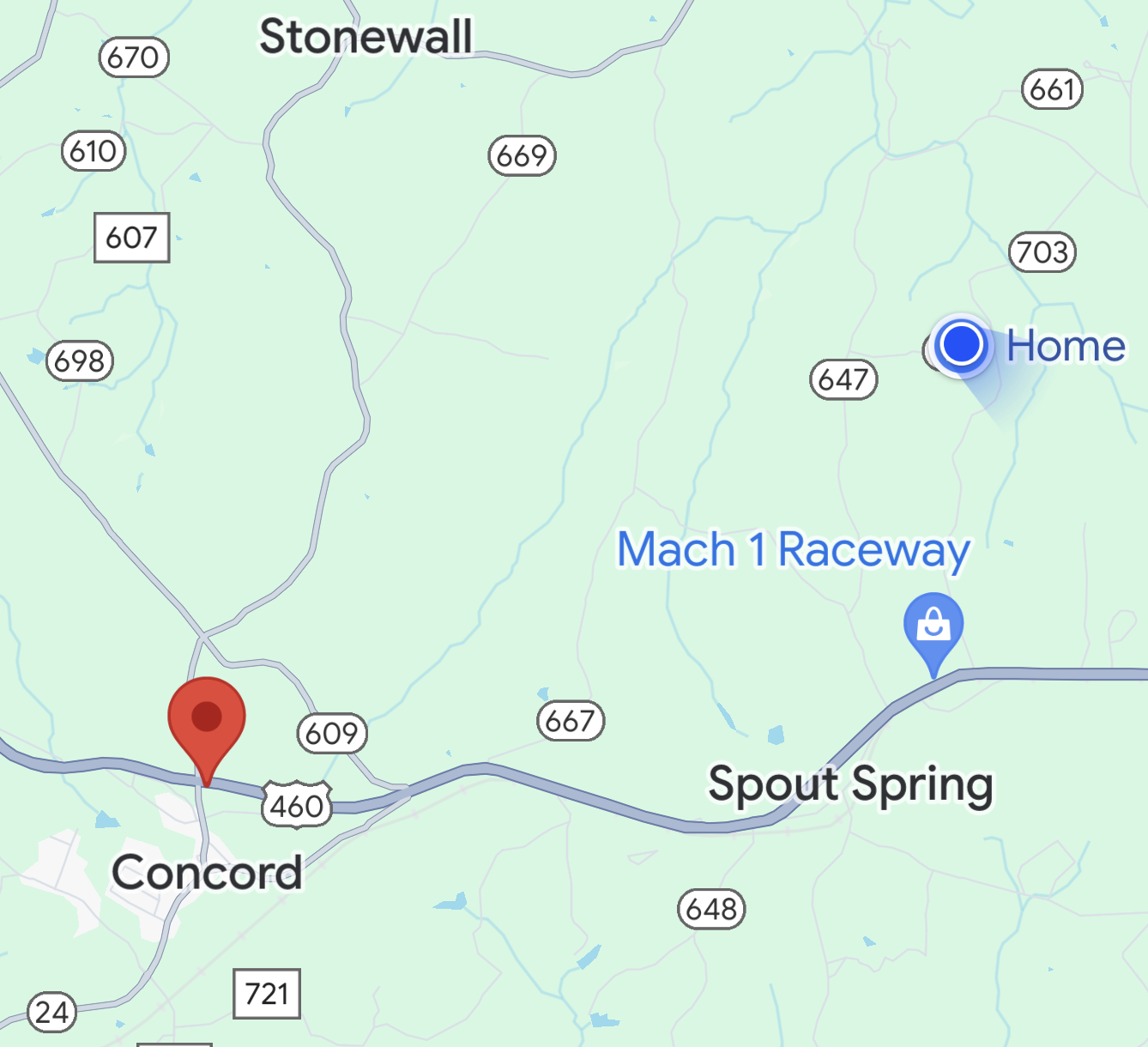

l'm thirty miles away from a non-ethanol pump. We make the trip when needed and come home with twenty five gallons (5/5s) in the back. And top off the pick-up while we are there.    .....Hippy
Wow, I guess I am lucky then. I only have to go from the blue dot to the red balloon to get non-ethanol. It's only a couple inches on the phone.

That idea of putting epoxy sealer (not a DD screamer) into the new tank was floating over my mind. And I didn't point that out since in a case you have a clean brand new tank the straight simple way just installing it seemed very attractive. But on the other hand considering options and adding some reasonable amount of efforts into a deal could pay off in the future.
I don't see any issues applying sealer to a new alu tank. Sure you should check out the particular compound on its applyability to alu. Also you better degrease the inside of the tank with suitable degriaser before sealing and be sure that light evaporating stuff to not poison your breath of make big boom.
On the other hand from those arguments above the worry of use alu tank for gas is water which could get collected in the fuel because of alcohol. But I guess water wouldn't affect aluminium really fast even being poured clean right into the tank. So adding fuel stabilizer and not allowing old gas to take place for a long while should secure you quite enough from notable tank inside corrosion.
This was about all I could find about sealing new aluminum tanks. I think I'll just put the thing on when the strap rubber gets here and hope for the best. If I have issues I'll have to put a tank behind the cab I guess.
