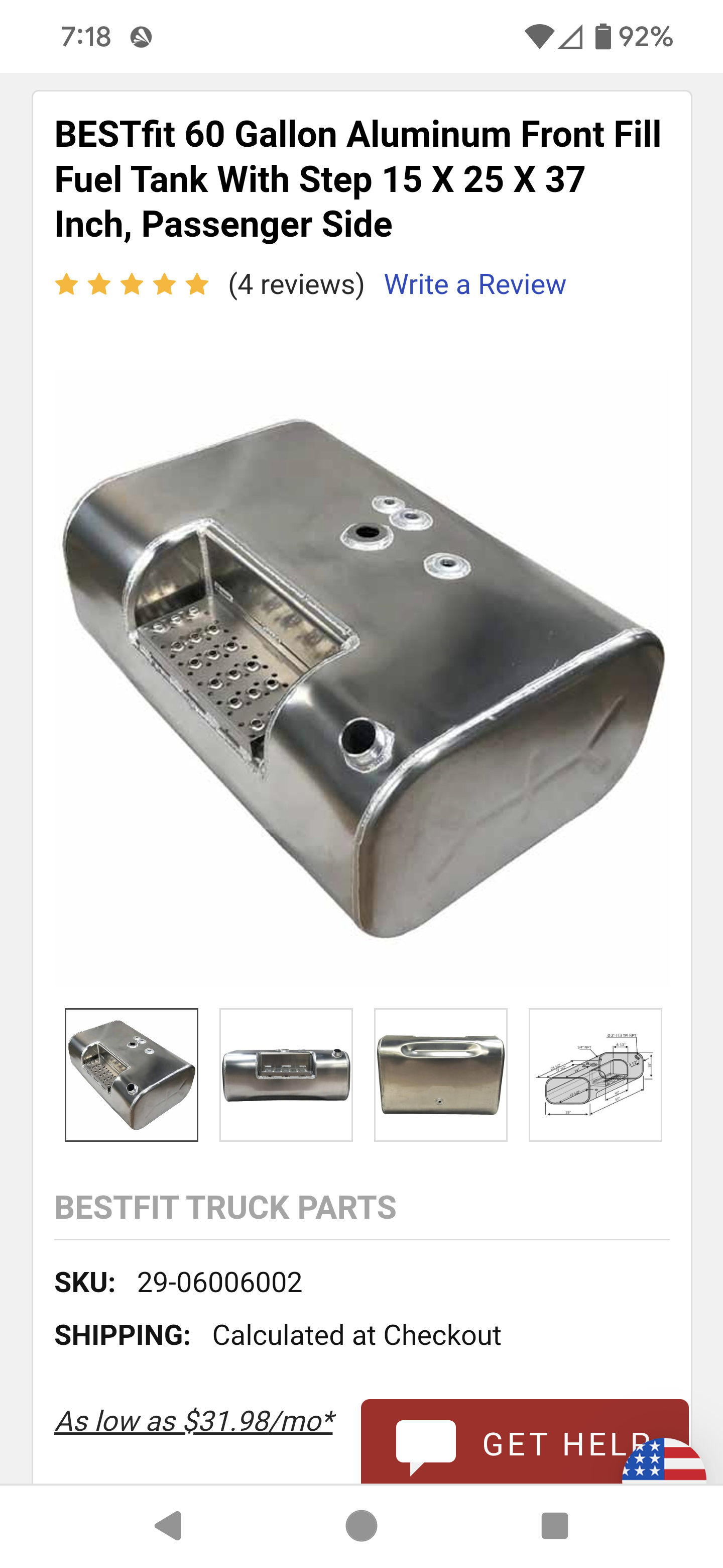

That's a tank off a S series or 4000 series International.  I just put one of the aluminum aftermarket ones like the 4 States  one. The local place here got me for $825 plus tax but it keeps the fuel off the floor much better than the steel one.
It's probably well worth doing a new tank since you've got the old one out.

Yes, it only pulled from that passenger side tank to begin with. 60 gallons will get me up the road a little ways anyway.  And I guess I could put the tank I just cleaned on the driver side if I really wanted to fool with it.

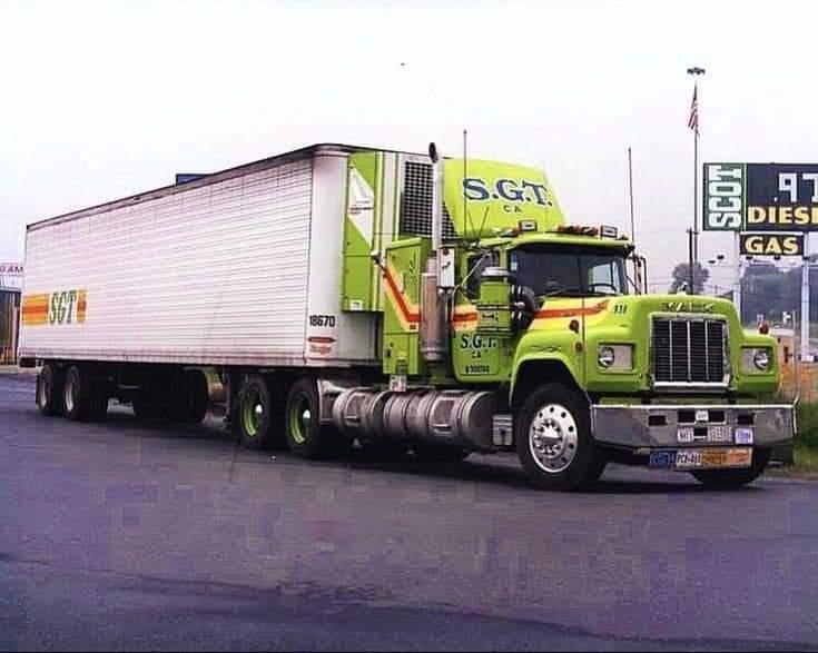

if  picture shows 3 tanks passenger side ;; would it also have 3 driver side ?? that's a lot of fuel. deceptive picture ; could almost be a R-700?? don't see a seam on hood fenders indicating an older R . more and more want to travel to the Australian side to see a positive world.

You talked me into it- new tank, done with it! I went out and measured the tank and this is pretty much the exact same size. The tank on the driver side is steel, so we can just paint it. I ordered this and cancelled the sealer.
Only thing you might need to get would be a tank vent in one of the threaded bunks in the top since it's gas instead of diesel.
I might be wrong but it seems right
Mech, that center one might be an air start???? Also in the 70's - 80's oil shortage and big price jumps a lot of carriers carried more fuel so the could turn a further distance on home terminal fuel..
All my trucks had the starter and air start tank on the drivers side, but they were Cat and Cummins.  I don't think you would put the air start tank on one side the the starter on the other.
 My '89 had dual 150's, but some O/O types ran more than that. Then theft becomes bigger risk.
1 hour ago, Joey Mack said:
Uhhh  fuel was .97 cents a gallon...  what year was that '89??
That is Canada, so likely 0.97 per liter. Gas was not anywhere near .97/gal in 1989.
I think you're right, I thought about that too. Maybe they have an old tank in the junk pile up at FLM I can get.

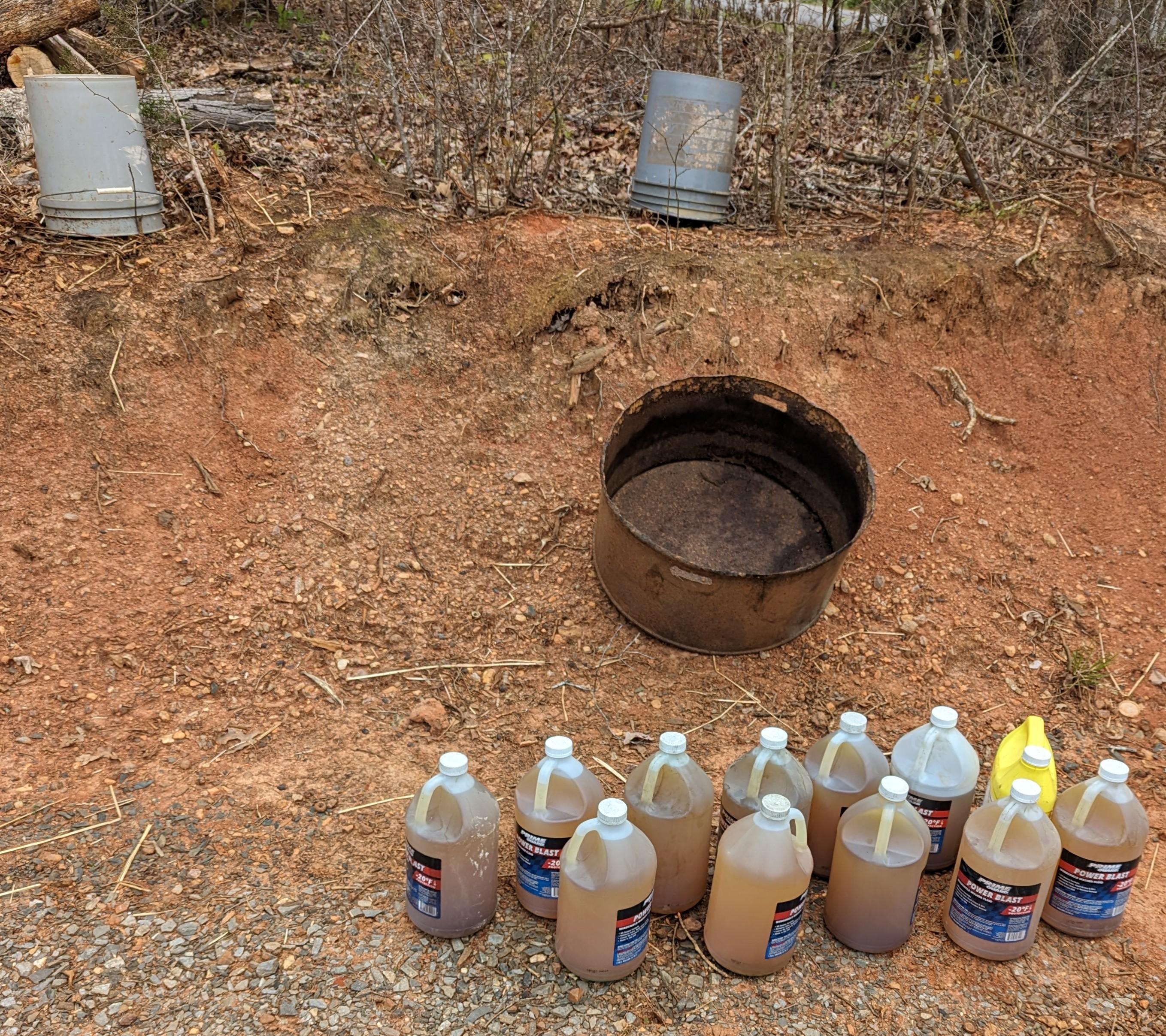

I remember a guy on here a couple years ago that was messing with some fuel and burned his legs??   I cant seem to remember who he was though,,,  Hmmm?? I wonder..
  • Haha 1
28 minutes ago, Joey Mack said:
Watch This, Here, Hold My BEER...  :)

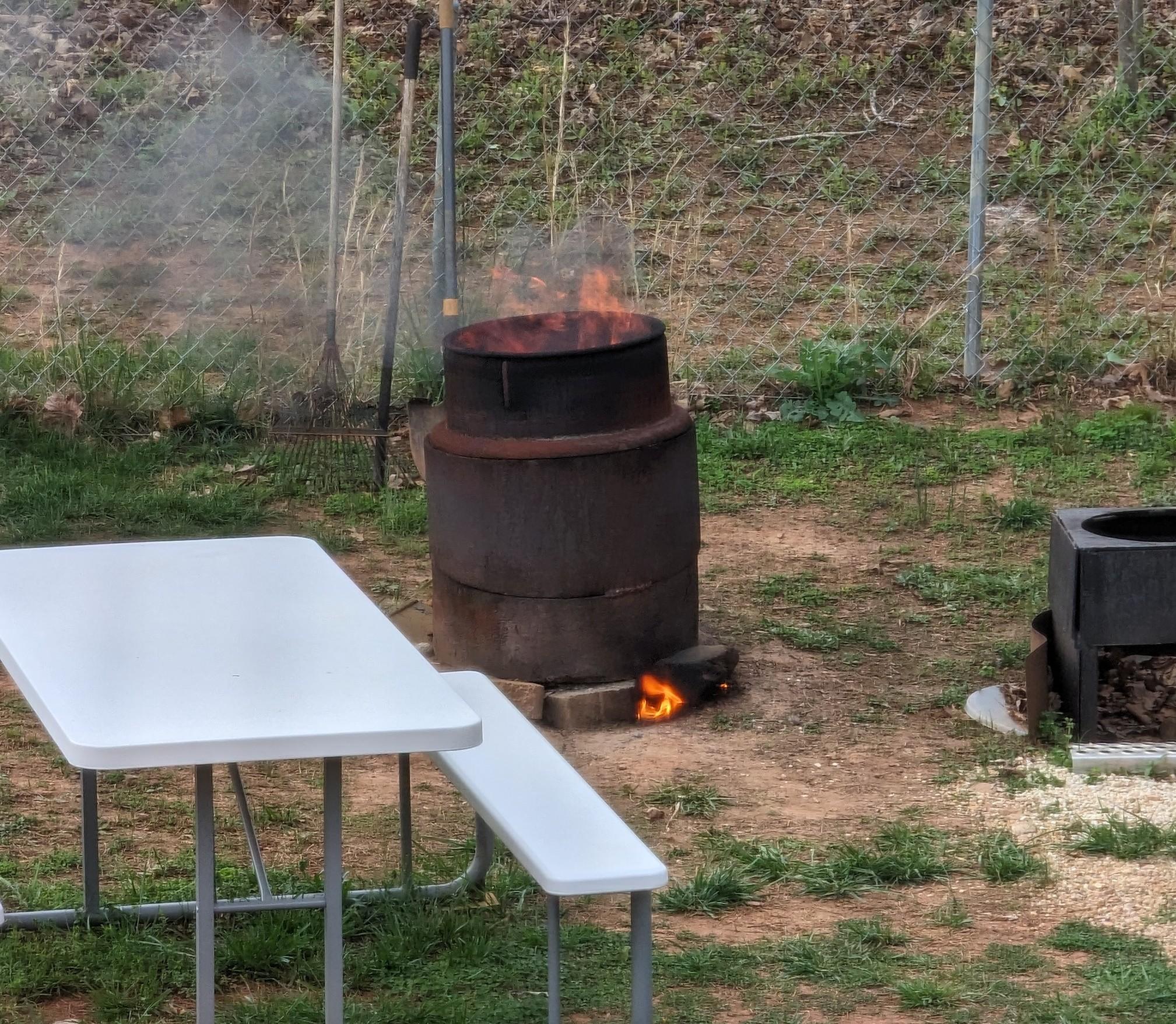

Gallon no. 2 disposed of, set a full jug in the barrel, put a small bag of trash in alongside it, poured a little more gas in, lit it, and this. PXL_20240410_215854085.thumb.jpg.c964c3506af64314eddcf1bf49f625d3.jpg
No big boom, no big suplosions, just a fire. I won't have much trouble disposing of that gas. No wonder the truck wouldn't run.
Every time I'm burning trash I think of that guy .  🤔  Who the heck was that guy....

22 hours ago, 70mackMB said:
That's a Canadian company and truck with the spread axles of the drives and trailer. l think there are only two tanks on the curb side.    .....Hippy
after trying to enlarge photo, which didn't do much  I will agree .looks like 3  it's only two. that first one is held by 4 straps. fuel fill might be under sleeper close to strap 3 making it look like a seam. has the inserts for headlight panels also.
