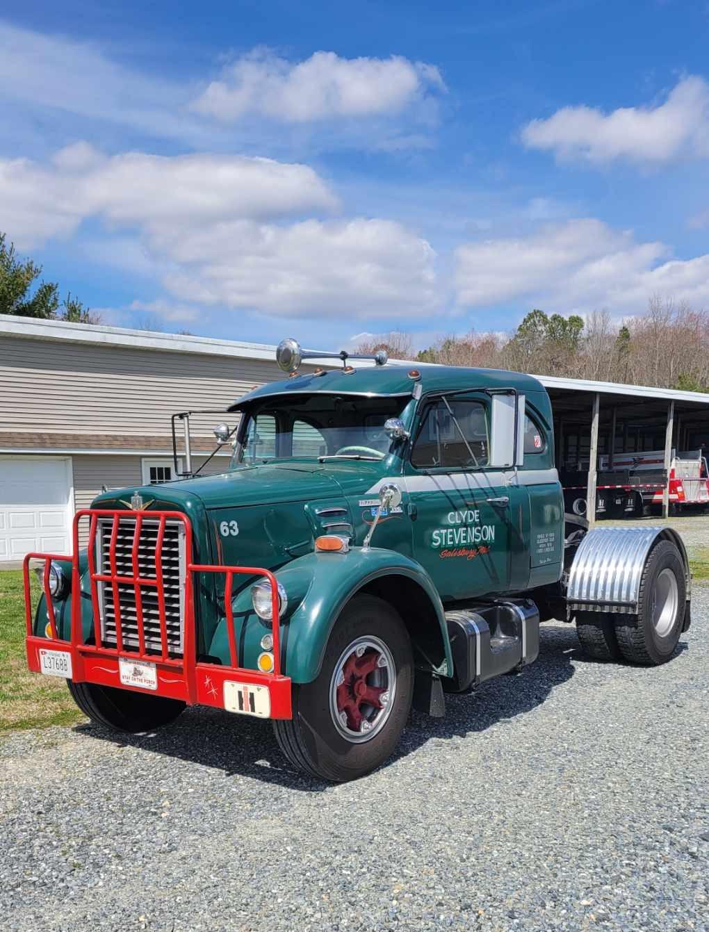

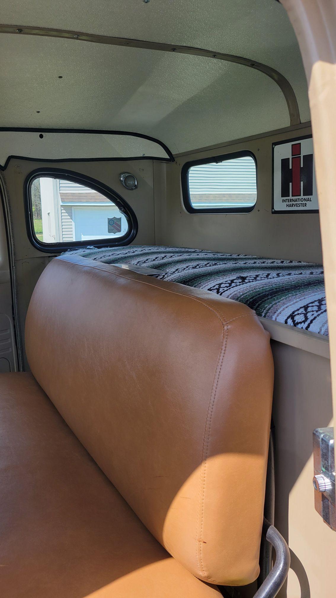

We've been wanting another old truck for a while, Zina kept saying "you need to find us a truck", but nothing really suitable came along. I told her we really needed a single axle unit with a sleeper so we'd have some room in it, like an old fleet truck. Then I saw this on marketplace one day and showed it to her and said "that's a neat looking truck". And she said "you should call".
I said "but it's really small, we need something with a walk in sleeper"...
"That's a neat looking truck, you should call the guy".
So, anyway, his check is in the mail. Dave Couto, "maint1" on BMT approved.
I actually saw this truck at Winchester a couple of times but I never really paid much attention to it.

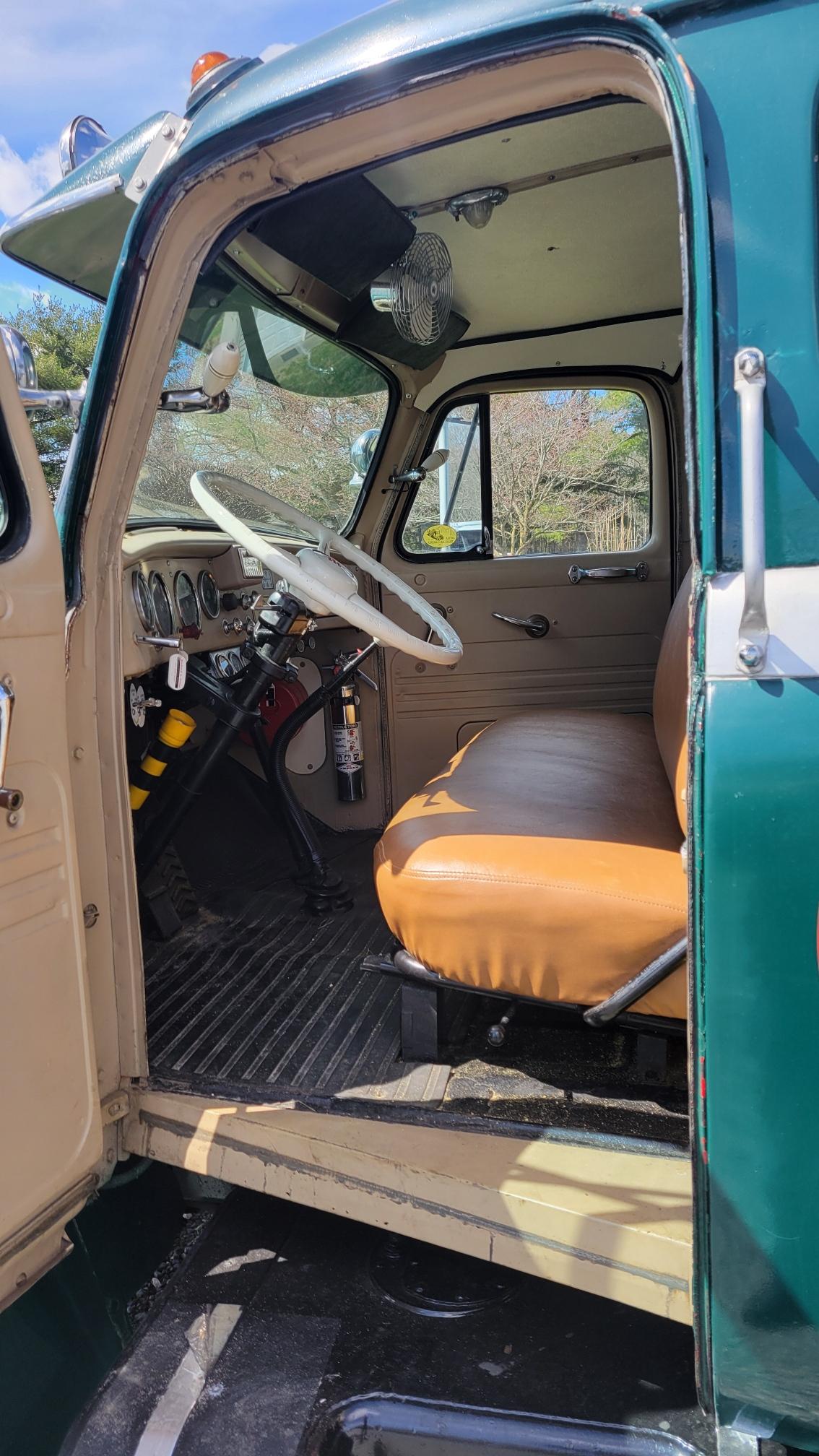

It has a 401 gas engine with a 5 speed transmission and 2 speed rear.
This man used to own it, he sold it to the late Jerry Howard, Keith Jones from the Keystone Antique Truck and Tractor Museum bought it when they auctioned the Jerry Howard collection, and Dave called him to see if he wanted it back. He did, bought it, and he said he spent about $4,000 on it putting a fuel tank on it, tuning it up, rebuilding the carburetor,etc.  The gas tank had rust in it and kept stopping the filter up so he put a tank that had only held diesel on it.  He sold it for $1,000 more than he gave Keith for it. He said he would drive it pretty much anywhere.
I called Dave and asked him about it and he verified everything and said he liked it, so we bought it.
Almost- his check is in the mail.

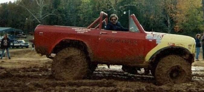

51 minutes ago, mowerman said:
Isn’t that Tom? I am not sure that thing would look better under me ha ha… bob
Yes, that's when I was young and handsome. That picture was taken about 30 years ago.
Oh gotcha I thought that was a recent photo and yes, I had a 67 4 x 4 with a snow plow but that was also a long time ago. Hadda a lot of rot  on it. But it ran real well  sold it around 77 and bought  a 70 Chevy 4 x 4 also snow plow..: bob
