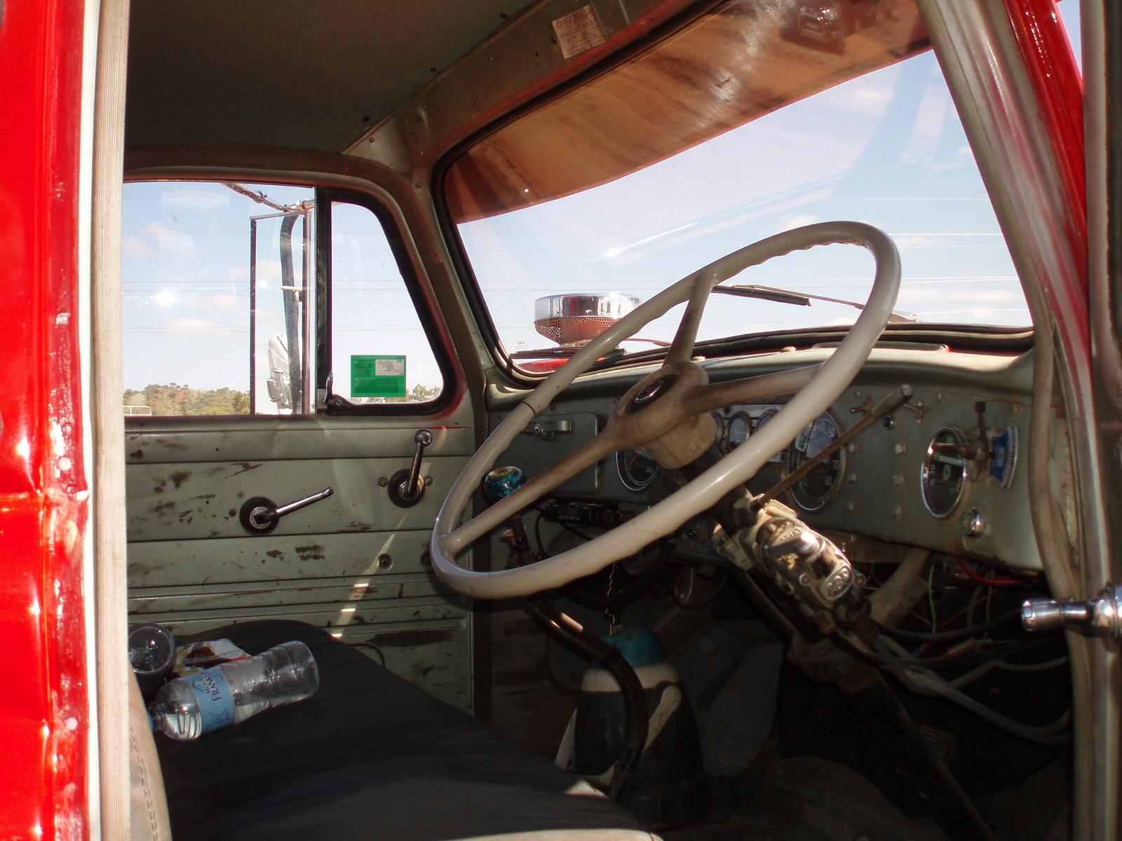

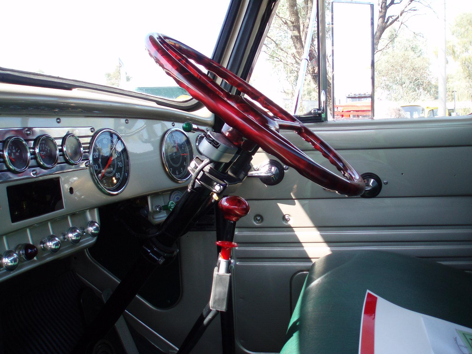

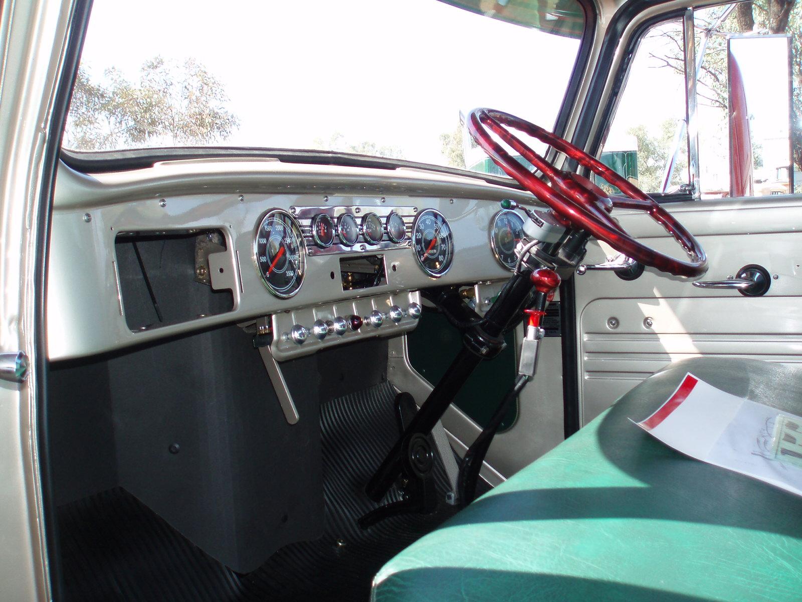

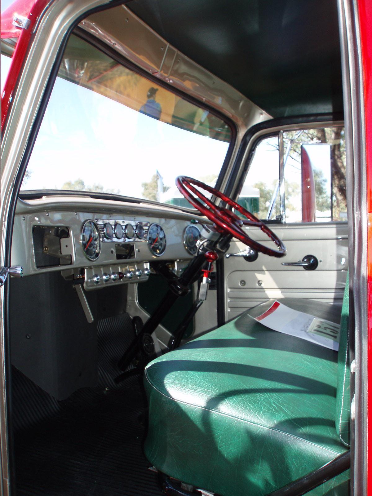

two examples of the gear lever bent upwards, the red steering cab is a Diamond T with the Inter comfo vision cab and 4th picture is an Inter with same cab
nice unit. question I have is location of two speed  button on shift lever? it's on left side closer to driver. sitting here splitting the make believe button and trying to recall; buttons were mounted on right side of lever making it easy for 3rd and 4th fingers to pull lever up/ down. guess using thumb works .

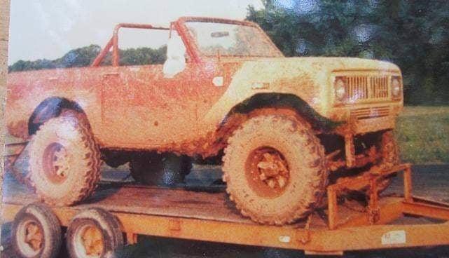

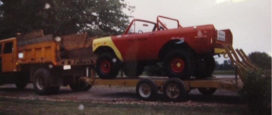

The tyres look no less than 37". Must be a cool dirt cruiser with so small chassis weight.

Many Inter R 190 and 200 owners in Australia used to bend that gear lever up near vertical from about 3-4 inches below the 2 spd button, so the lever would not touch the seat base and more user friendly for shifting gears. It was bent enough to not touch the dash board. I will see if I can find a picture of a bent lever.

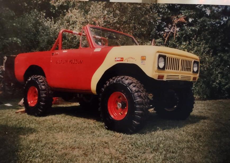

Those were the 12.50/38 Super Swampers. I had a set of 38s and a set of 36" Swampers so I could run it in 2 different classes.
That's cool. I never drove anything larger than 33x12.5R15. Macks don't count. But I drove those for whole 10 years everywhere, both in a forest and on highways in Europe :)
