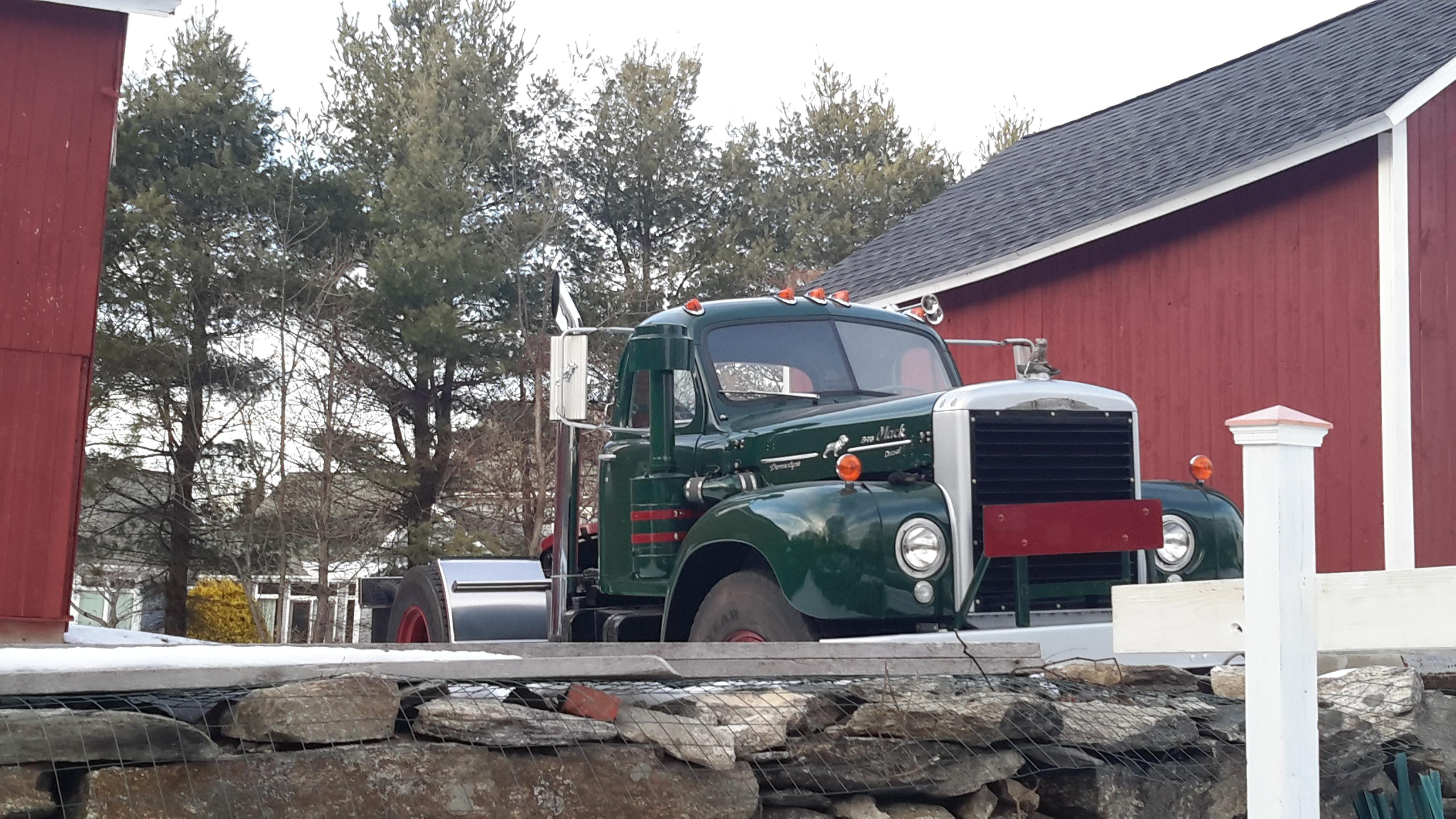

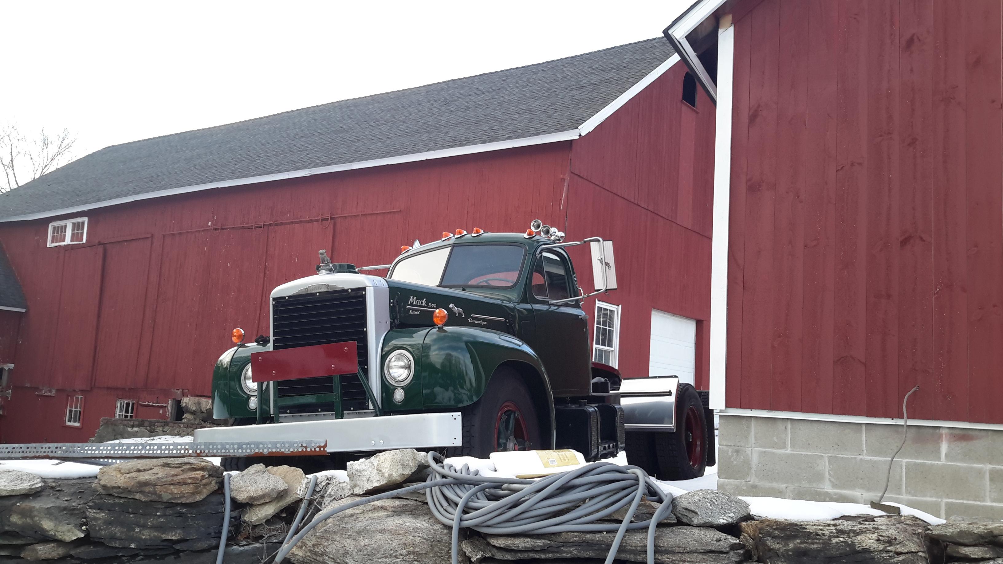

Just started up the mack to take a nice Sunday drive with my 3 year old daughter to get ice cream and it ran away. Ran beautiful when I parked it in the barn last year.  Oh man did I go into scramble mode. Got intake pipe off and stuffed my t shirt in there. Danm thing wouldn't stall. Just set down to a low idle. Had to find plastic to wrap over the t shirt to get it to stall. Got it idled down quick enough but took good time too get the dam thing to stall out. Any ideas? Fuel is probably 2 if not 3 years old, Startin to smell like kerosene. Injection pump problem? Or running off oil that leaked down? Never had issues before.  It's a 711 turbo in a b75 with triplex. Old pics but pics are always good to look at
