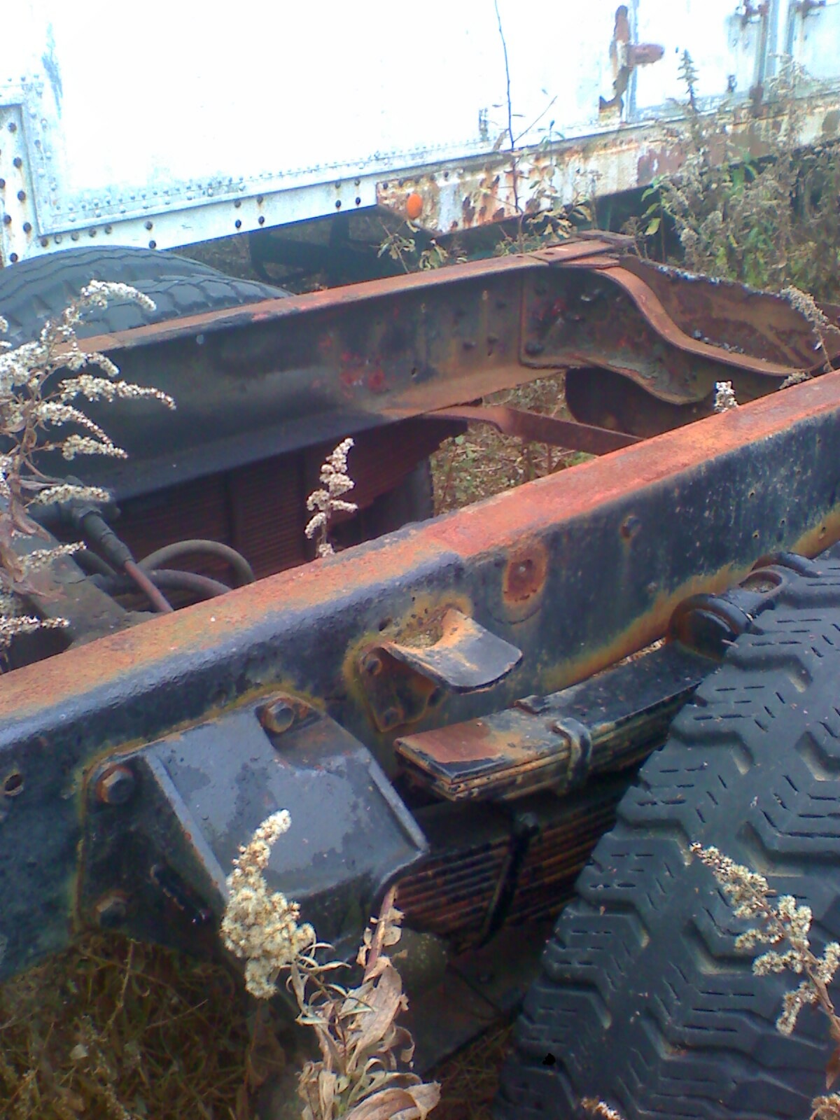

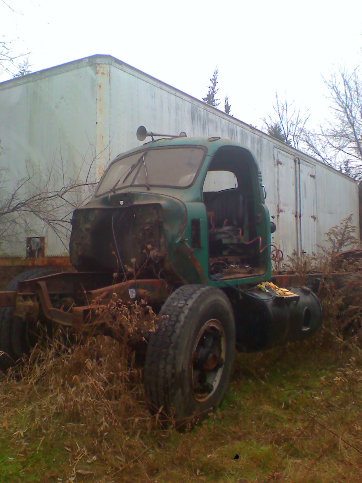

  15. I have a B61(SX?) frame that is in good condition. light surface rust here and there but not even close to having heavy rust or rot, It is in very good shape for a solid start for a project truck. The cab is off of a b75 and is in good shape but the floor is gone. Also has 1 round aluminum fuel tanks. I can help load onto a trailer with a machine. Please call if interested. Looking to get rid of it sooner than later. Located in Newtown, CT. Call (203) 948-2486 $1200

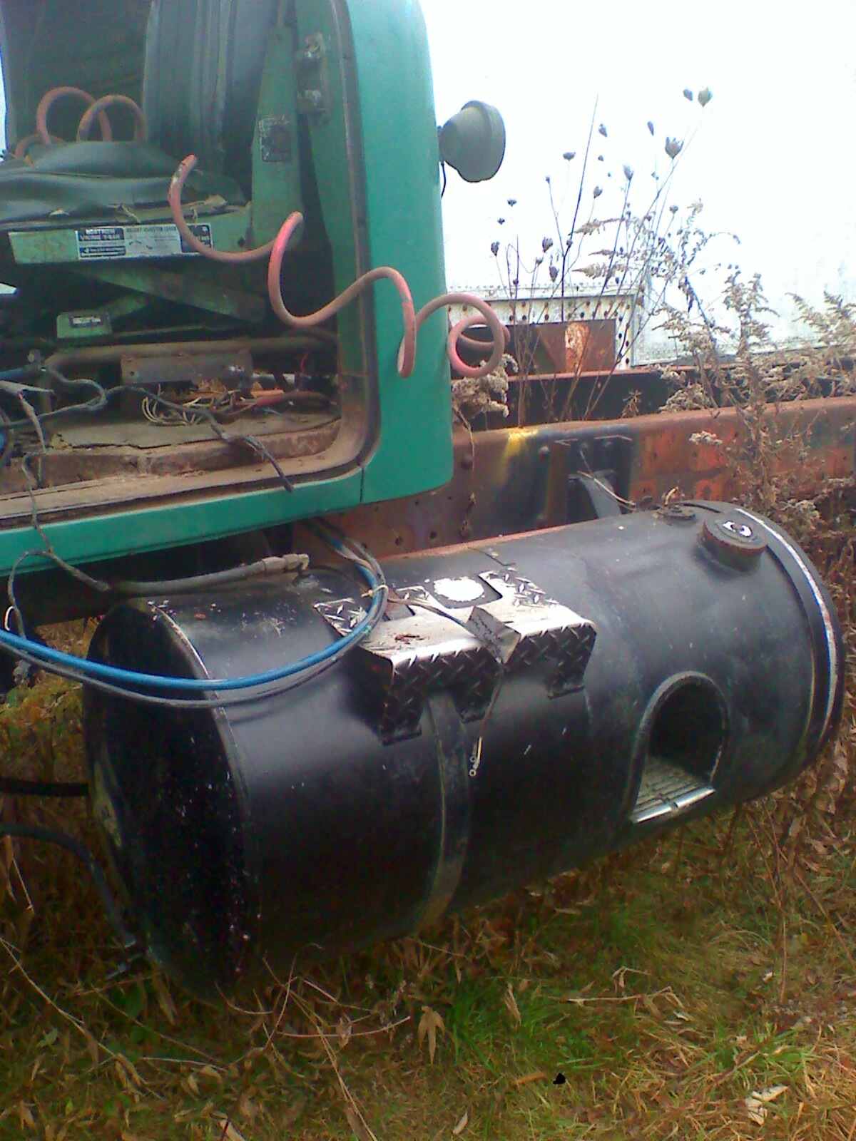

  16. I have a B61(sx?) frame that is in good shape, some surface rust on the back but is not even close to being a rusty rotten frame. The cab is from a B75. cab isn't in bad shape but the floor is gone. Frame has 1 of the round style fuel tanks, I believe they are aluminum but have been painted black at some point in time. Looking to get $1000. I can assist loading it onto a trailer with a machine. Looking to get rid of it sooner than later. Please call if interested. (203) 948 2486. Located in Newtown, CT
