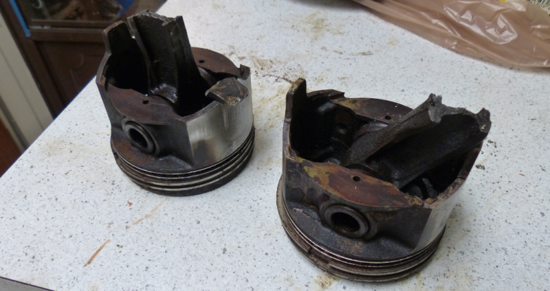

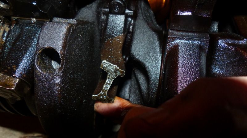

Since the end of April up in been Maine, Nova Scotia and New Hampshire. Needed a bit time to sort things out where no one would look for me. Even blew up the engine in my 55 Chevy gasser at New England Raceway at the Northeastern Gasser meet. Literally poured out the bottom end. Felt good as hell to  make four and a quarter runs it that hard. Note to all, never, never ever launch a blown injected ethanol fueled small block at 6500 rpm.

Don't believe in rev limiters most times never even look at the tach after launch. Been racing that car since 1968 it's like second sense. Running the same 4 speed and 57 Olds rear since 1974 just eat engines. One point in the late 70's I was blowing up an engine a week street racing, all big block chevies. .
Red line was 7800 small journal 327 destroked to 302. 11.75 to 1 comp. 60% overdrive on the 4/71 blower drive for around 25lbs boost and 6500 rpm launches and never lift to the lights.  7500 rpm shifts seemed to stress the bottom end.  Got almost a year out of it so all's good.
Guess the blower did the damage? Those small journal’s good for that rpm & compression?

Small journal will take the revs long as you run a girdle and ARP studs, Brodex heads 1.5 and 1.7 roller rockers exhaust and intake ,ancient Crower roller cam, Jessel gear drive and Wiseco Pro True blower pistons. Running  ethanol and 25 of boost not so much if you run it over 6000. 4;56 airlock with 31.5 tall 11inch Goodyears
