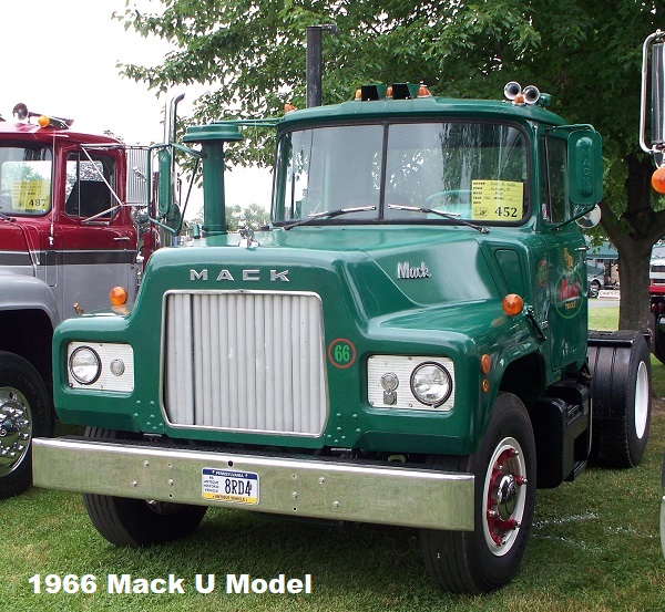

Jim, where did you spotted it?

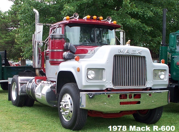

The truck at the left (to the right to the U) is a nice looking R I saw a picture of once.
But I don't remember showing it out in anybody's reports along the East coast.
The U-400 platform had a couple of options.
U-401  END-475 Scania diesel
U-403  END-465 Thermodyne diesel
U-410  EN-414 Chrysler 413 V8 gasoline
U-487  ENDT-475 Scania turbo diesel
U-492  CAT 3208 diesel
The engines listed above were not available in the U-600 platform.  I have only seen two U-400 models of the 316 units built and the frame dimensions and spring packages appeared to be the same as the U-600.
Jim
