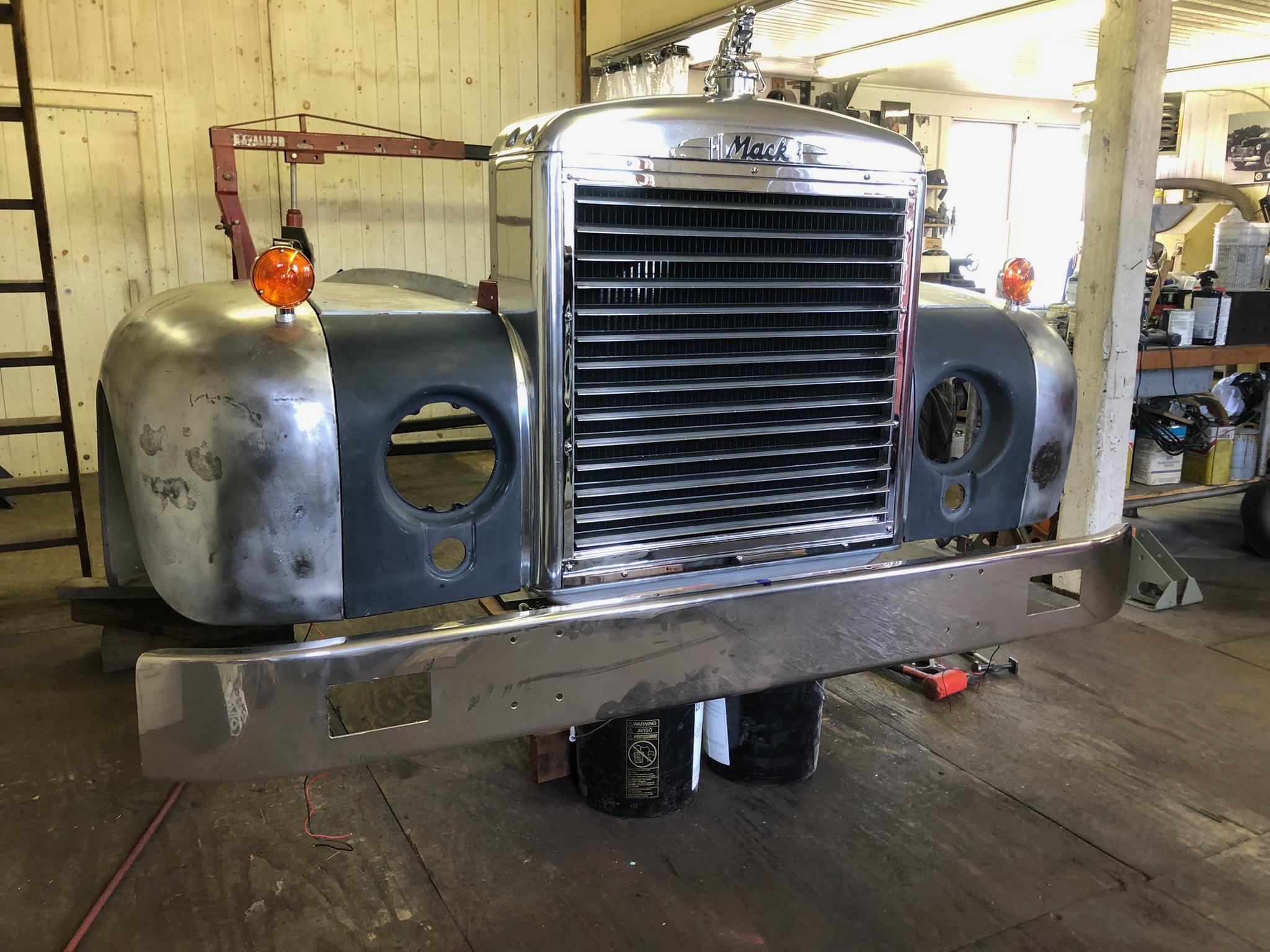

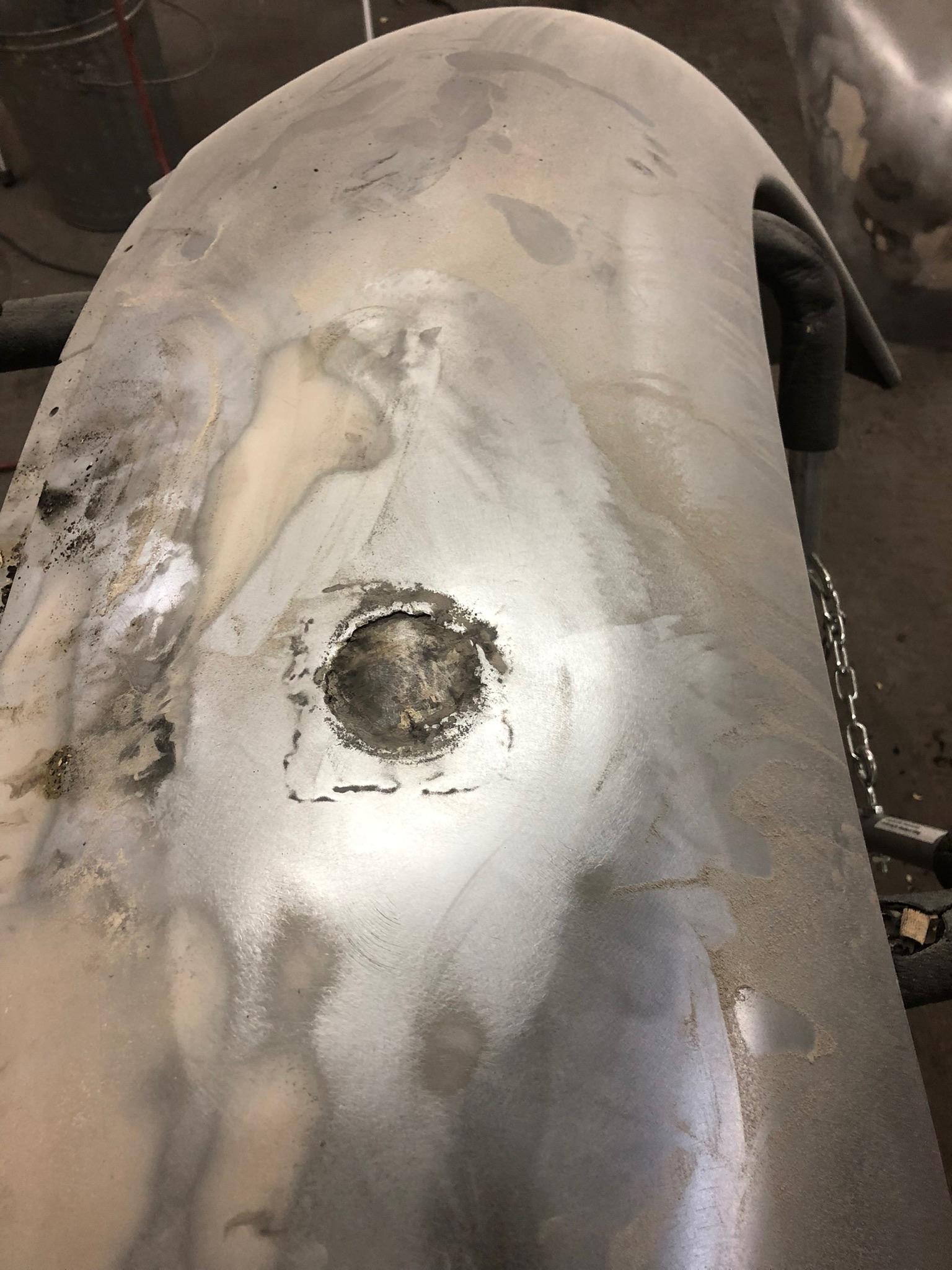

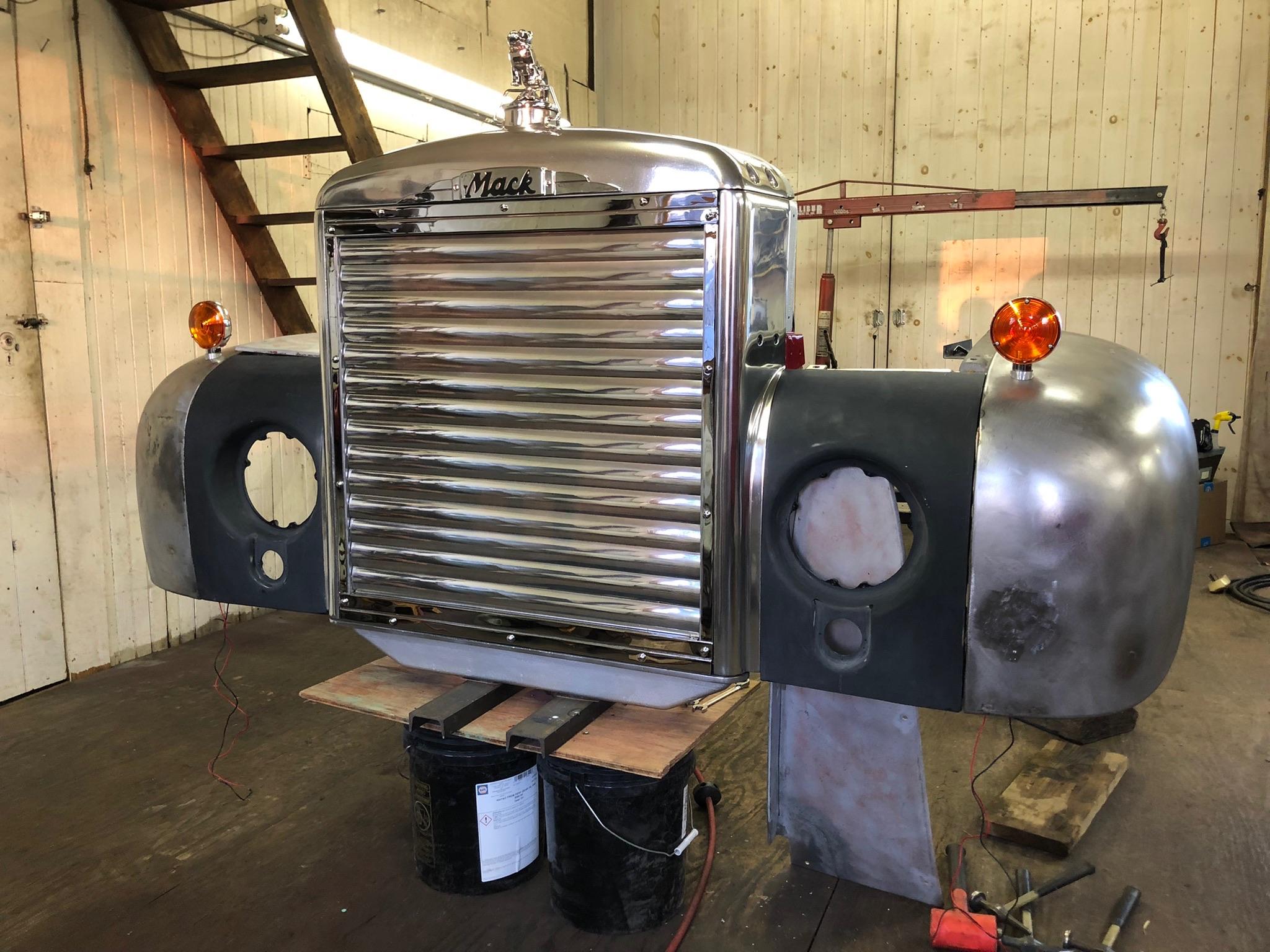

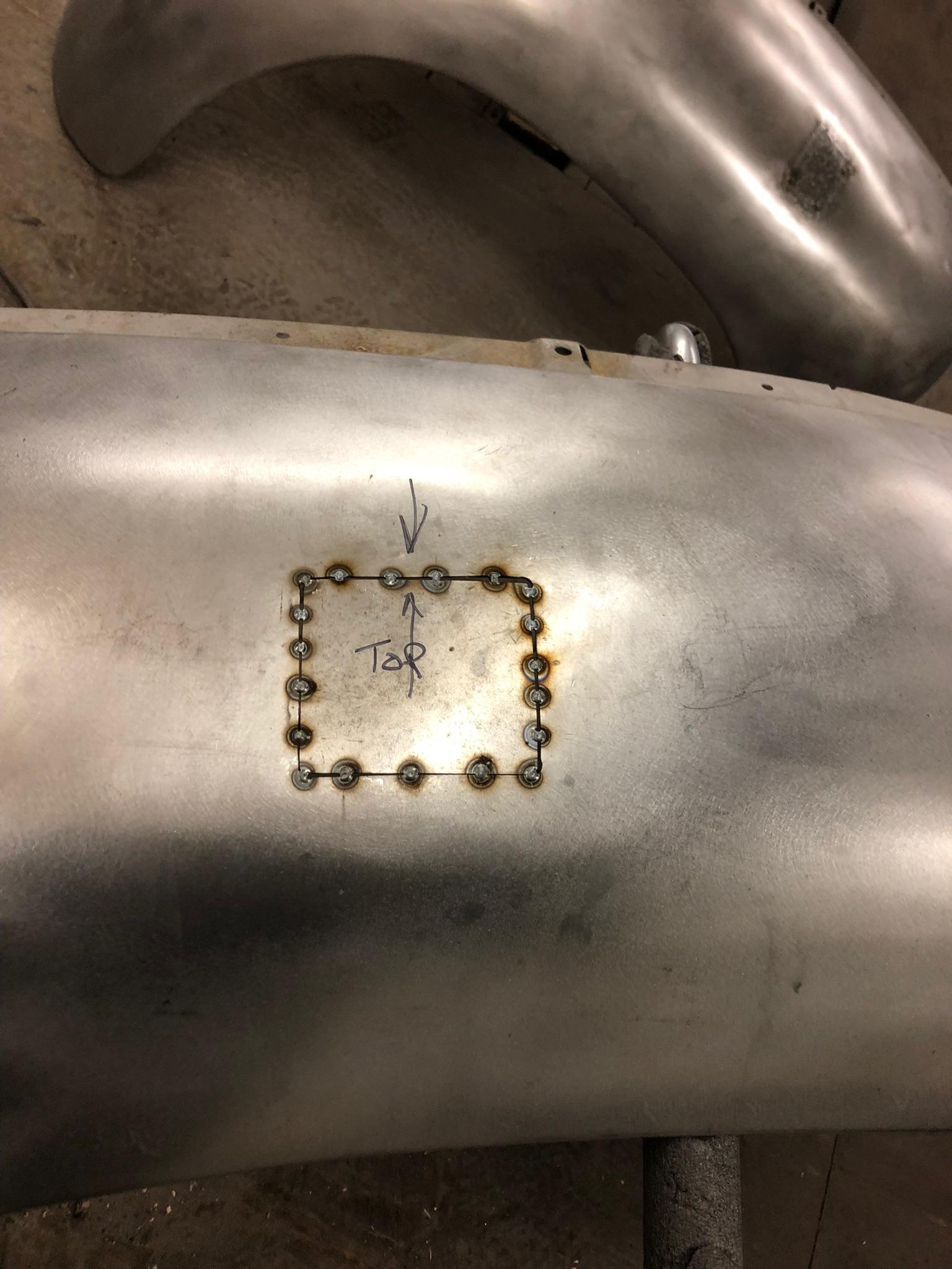

In the 4th and 5th pic with the D/S fender, are you using lead filler, or is that just from massaging the fender back to shape?
BTW, beautiful job so far!
Thanks for the complements!
Probably from massaging them. These were donor fenders from a truck I parted out. Better than what was on it due to rot, but the repair work that was done to them was less than stellar. There's also some pitting from corrosion that discolors the metal. That'll all be fixed before paint, though.

Lots of irons in the fire, parts on order, hardware coming in and some stuff still on order or awaiting return from being repaired. Accomplishing a lot of little detail stuff and finishing off some smaller projects on it. Waiting for the weather to warm up a little for body work and paint, but have been doing a lot of metal work on the front end items and fenders. I've got a couple of loads of paint to do, also. The goal is to get all this stuff done so when the weather improves to work outside, I can jump back on the frame to finish all the plumbing, wiring and mechanical work and then start final assembly!! So much to get done. I did finish off my wiper system by adding some covers to the motors. All the wiring is hidden and they really neaten up the installation. Today I was mocking up the front end to get the fender profiles right before final body work. The front end looks pretty cool temporarily back together. Nothing really earth shattering, but a lot of little stuff done.

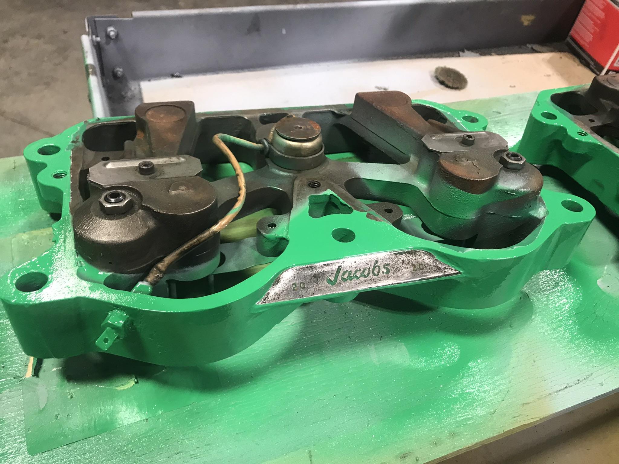

Matt , That Truck is Absolutely Beautiful! Thanks again for your help on my Cab ,, it’s coming along pretty good, I got sidetracked when I found a set of Model 20 Jakes for the 220 , I have been messing around with that Detour for a couple of weeks.
Wow, that’s awesome! I’m so glad that those parts are helping you out. The work looks great, by the way.

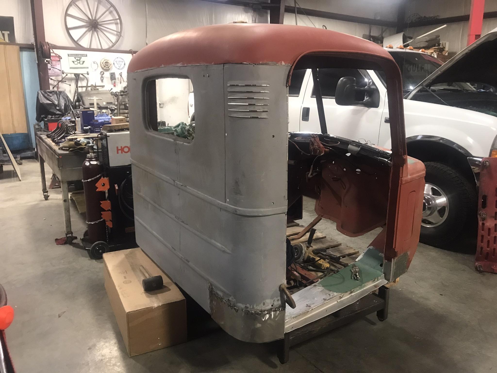

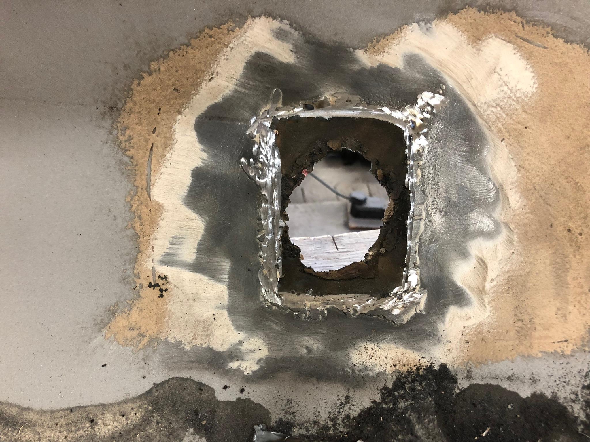

Love those little patches with no overlap. When you have the spots ground off the part gets back it its very original condition. Bad thing is when plenty of weld is required and the sheet is thin. Hammering back to the shape could be a trouble or require professionalizm. And I'm not a professional with that:)
23 minutes ago, tjc transport said:
Vlad, the trick is small spot welds, and stagger the weld. one side, than go to the other side. do not come back to the first side until it has cooled off.
by making a LOT of small welds, the metal has time to cool off and will not heat warp.
Yep this is pretty much what I do and I'm no expert at this stuff
I find it is a lot quicker to wait for it fully cool now and then, just keeping it at blood temperature than it is to try and beat back into shape
Paul
It’s called stitching. Once aligned and tacked in place, you work your way around the repair. No more than an inch at a time, depending on thickness of material and never next to the last weld. I usually work several separate repairs at once, so I don’t heat an individual repair excessively and cause warping.
