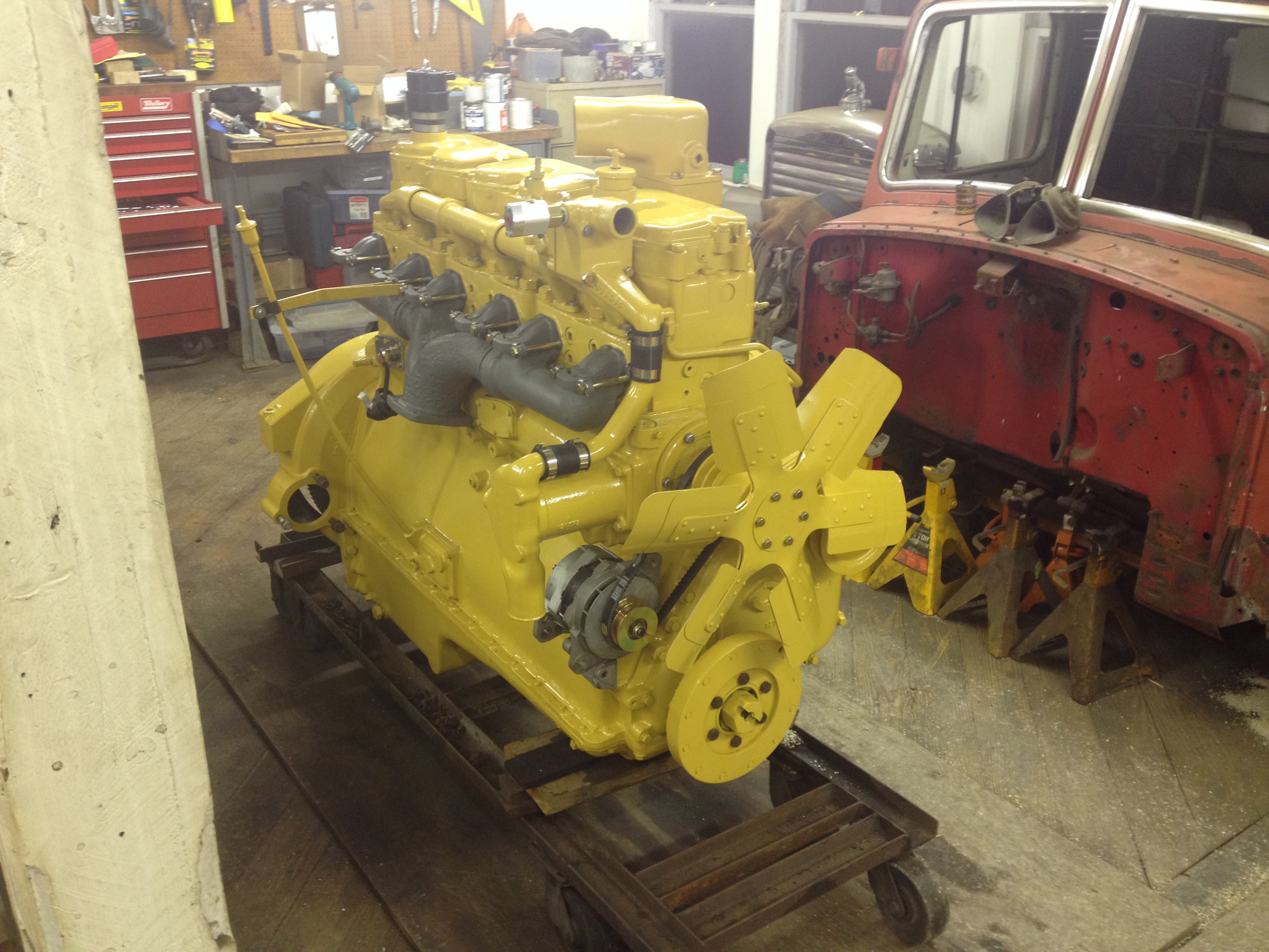

ahhhh an old 220 proud to see that gettin all spiffed up   like that tandem dolly to                       that engine calls for a backdrop manifold into dual 5 in straights and with a jake to boot what a tunnel shaker         :):thumb:

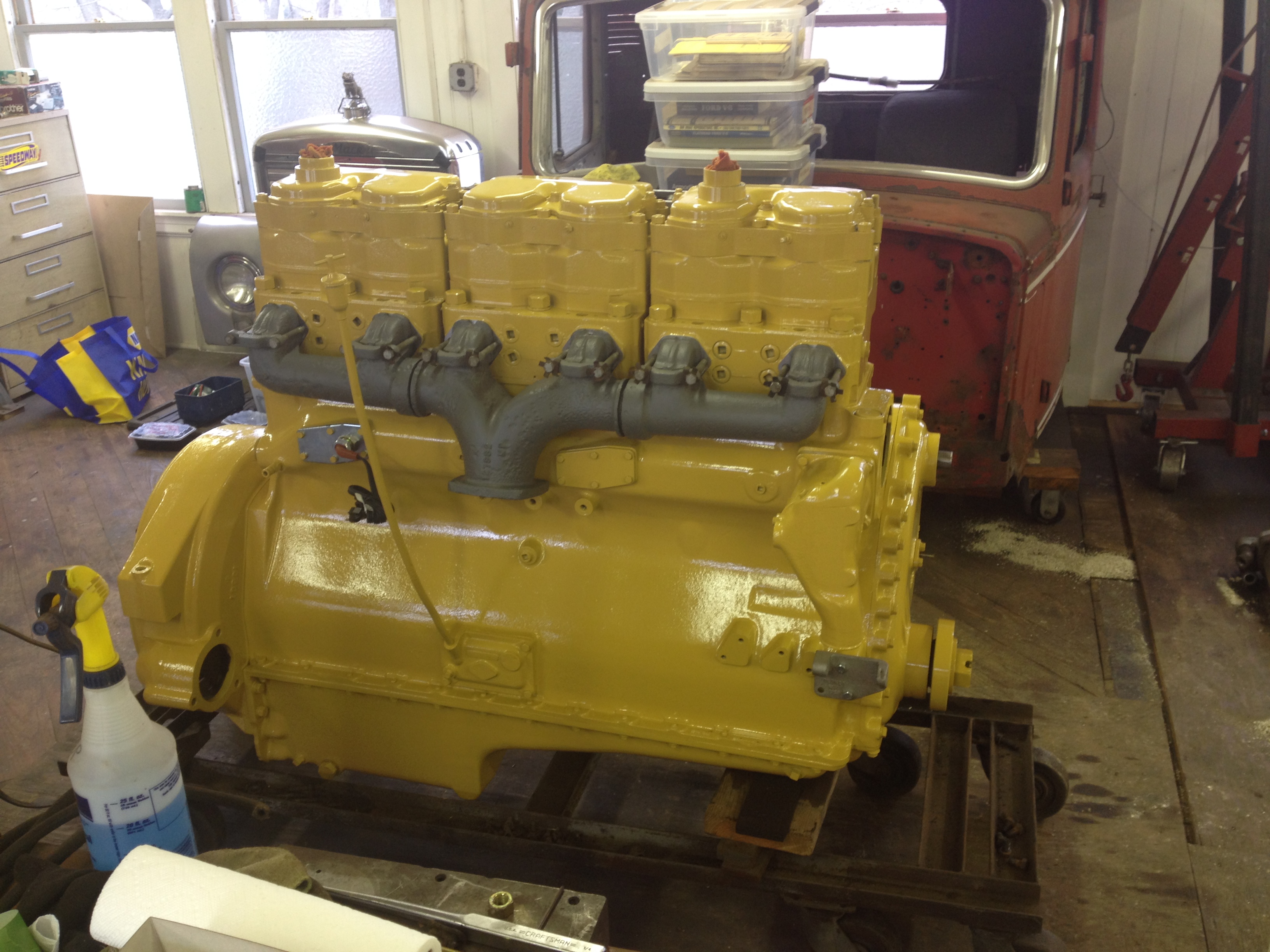

Loved the old flathead caddys, The porcelain exhaust manifolds were one of a kind! My dad rebuilt a 48 wreck, I can still  remember rubbing out the black lacquer! I was about 14! He wanted to keep it, but my mother said it looked too much like a hearse😁

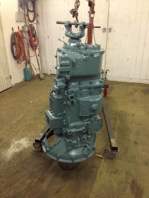

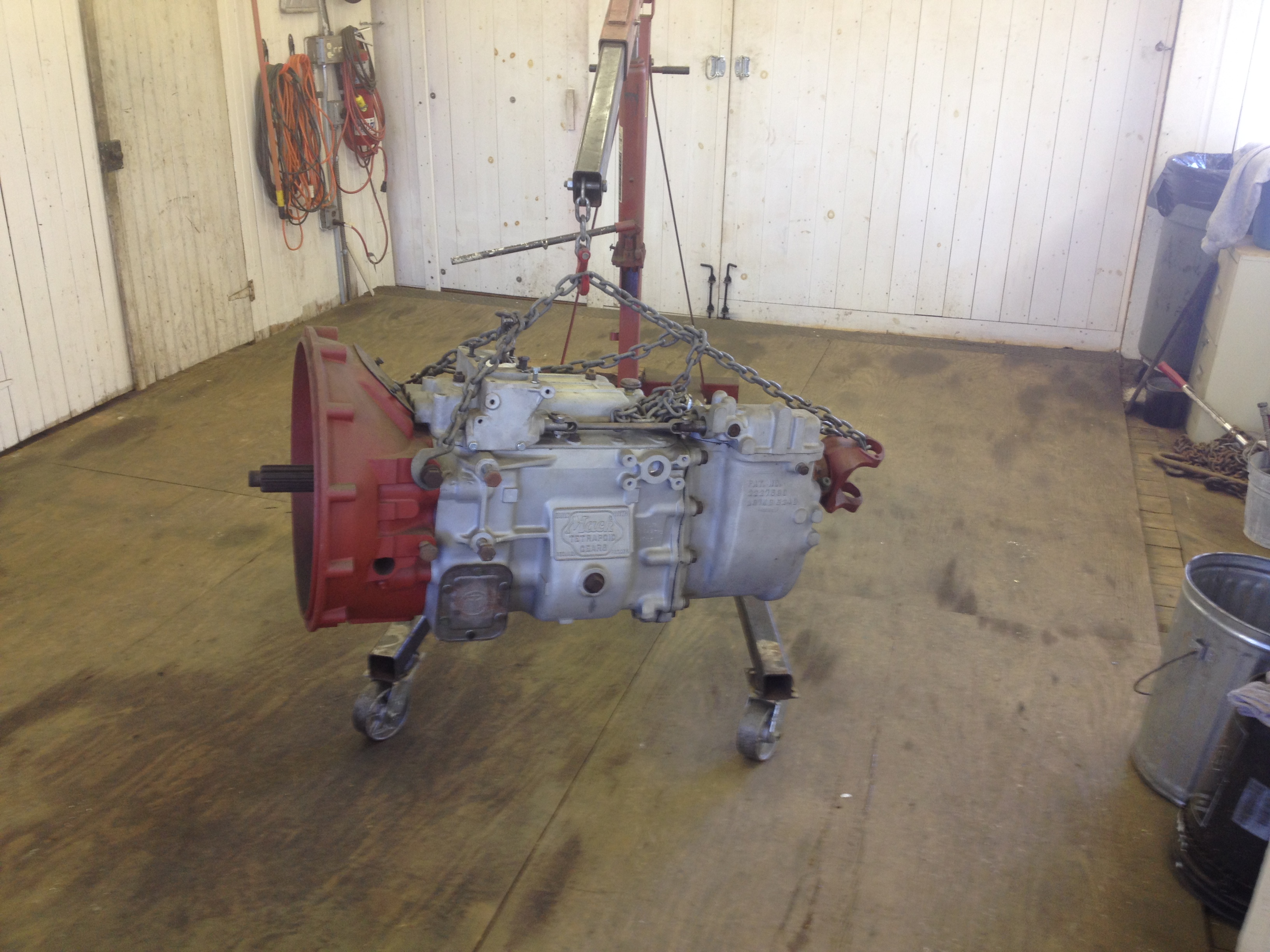

On to the transmission. Rebuilt this in 2005, bearings,seals. Replaced the bell housing with a steel one, the original was cracked and was welded and cracked again, when I got it. Working on the clutch linkages now. All the pivot points are egged out from use. Welded them up yesterday and remachined the ends to tighten everything up. Just have to finish them and the top covers before paint.

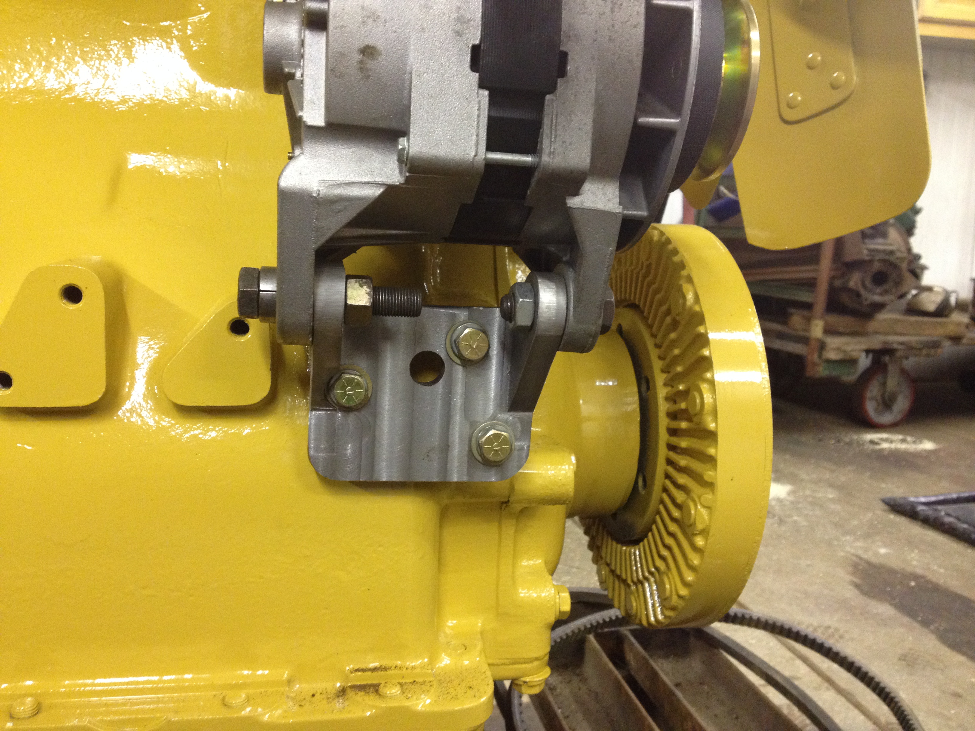

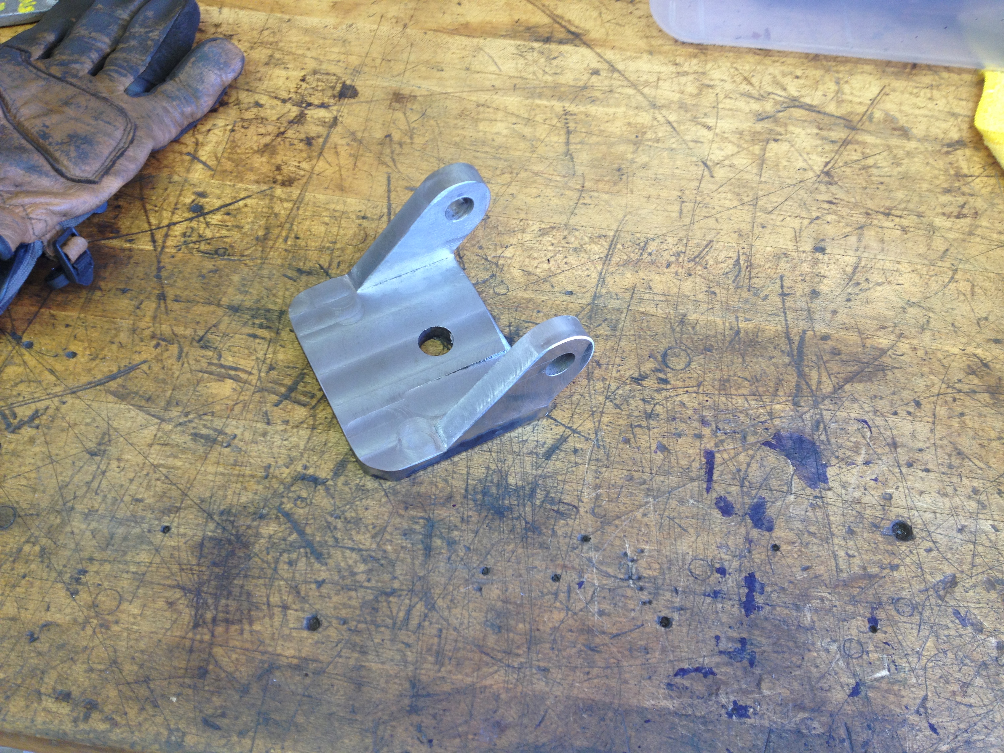

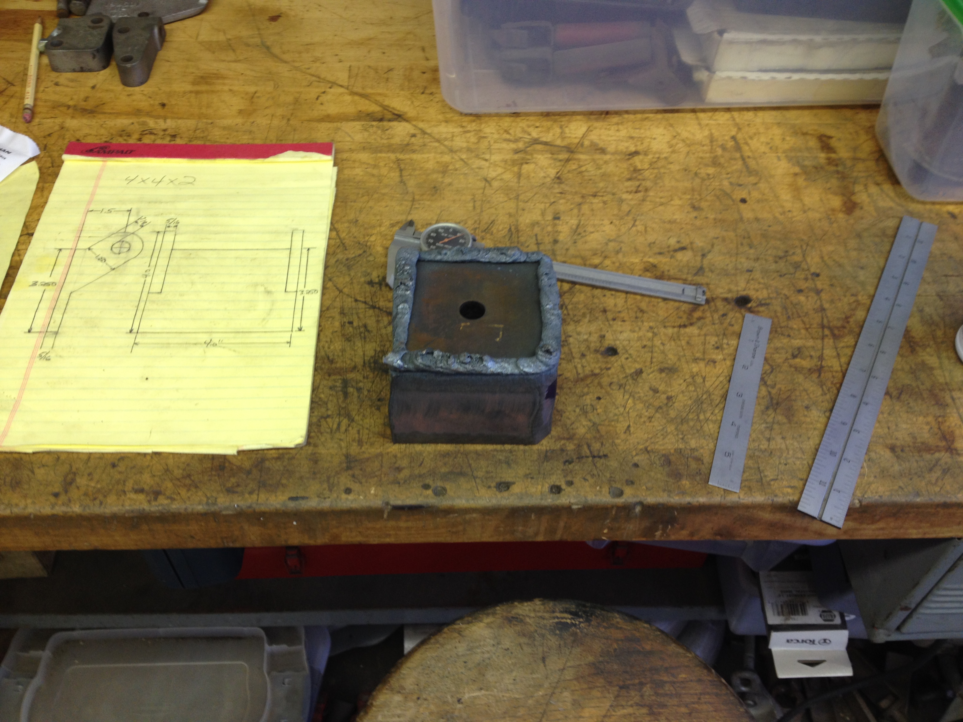

I hope you hogged some of that out on a bandsaw. Some would say it's just an old mount for an alternator But in the eyes of a craftsman it is a work of art. I ran a job shop for 20 years on the side and no one could afford that bracket at todays shop prices it would be a weldment. I say nice job.
