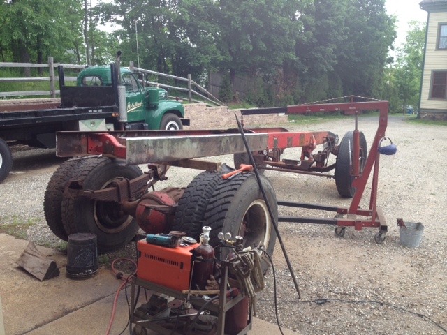

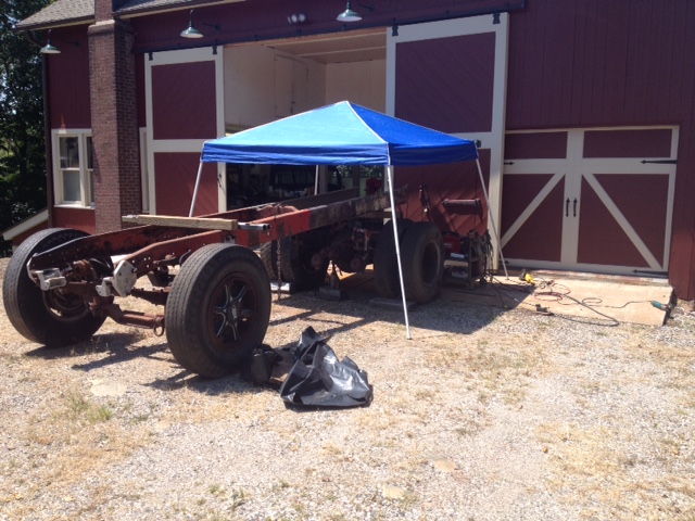

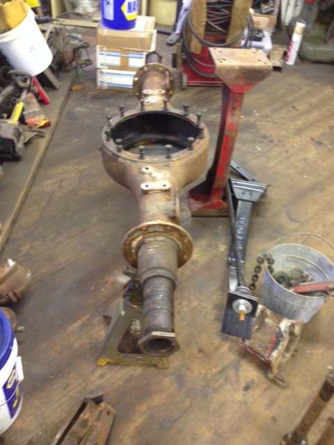

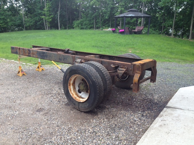

Stripped the new rear axle housing completely. I had robbed the gear set out of it for the original axle, after a friend gave it to me years ago. I was going to scrap it until I found some cracks welded up on the axle under the frame now. Lucked out there. It all came apart with some effort, but nothing broke. Some corrosion found on some of the aluminum castings. If they're too far gone, I can rob the other axle.

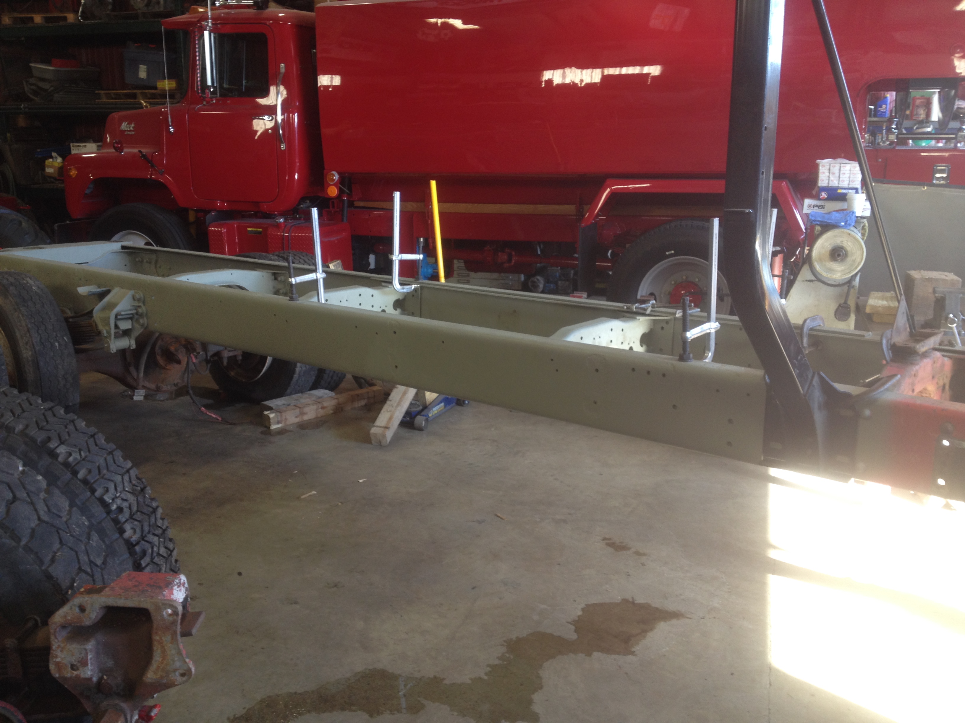

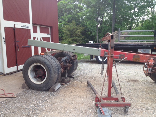

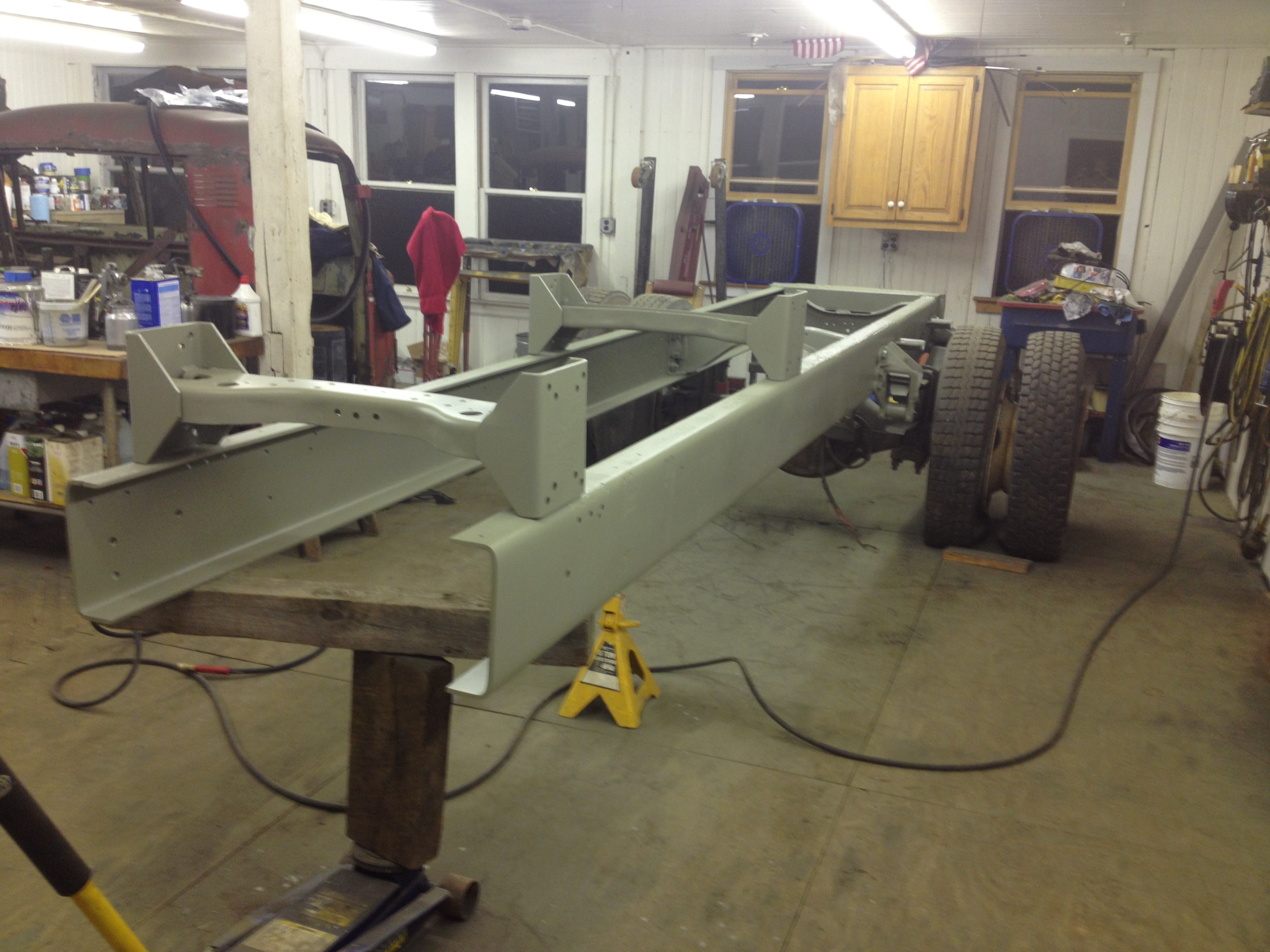

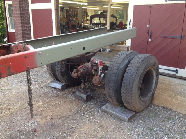

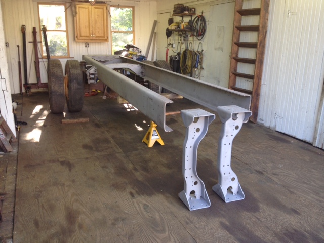

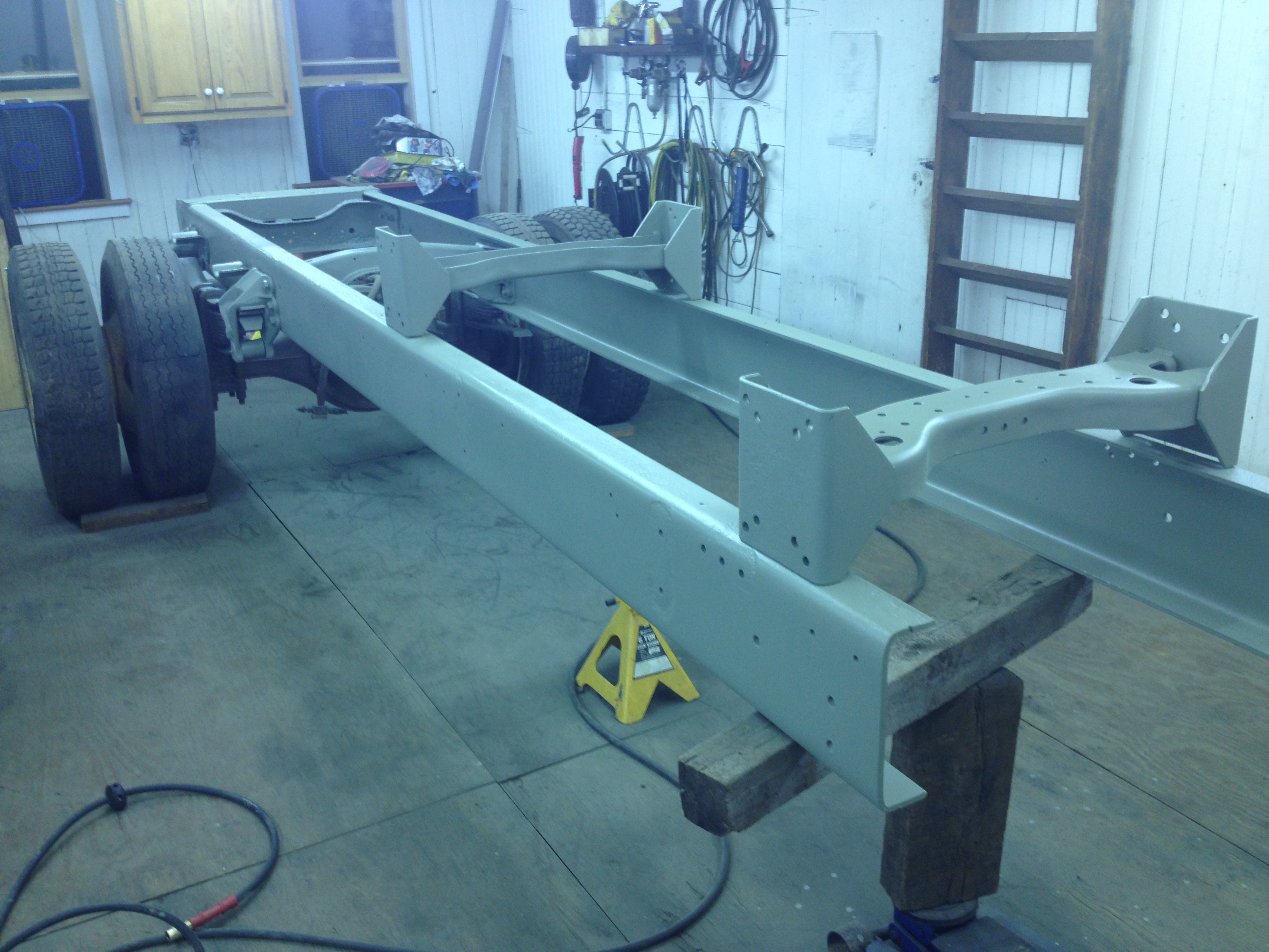

Well, my text disappeared when I posted those pics. But, it's been two months since I touched this, didn't think I would be that busy. Finally got on it this weekend, finished all the welding and primed the frame. Got the donor frame to the sandblaster and into the shop for primer.

2 hours ago, Freightrain said:

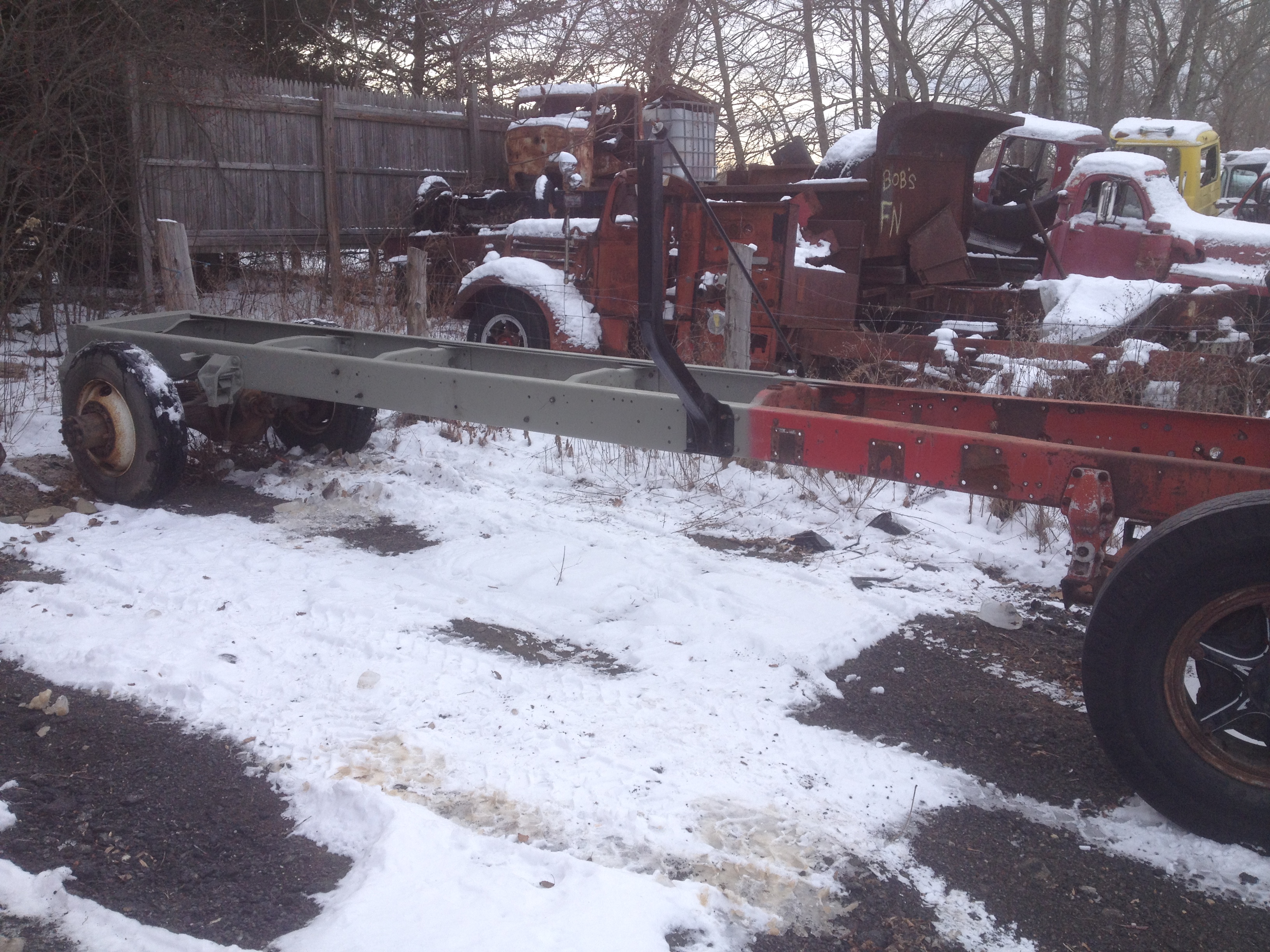

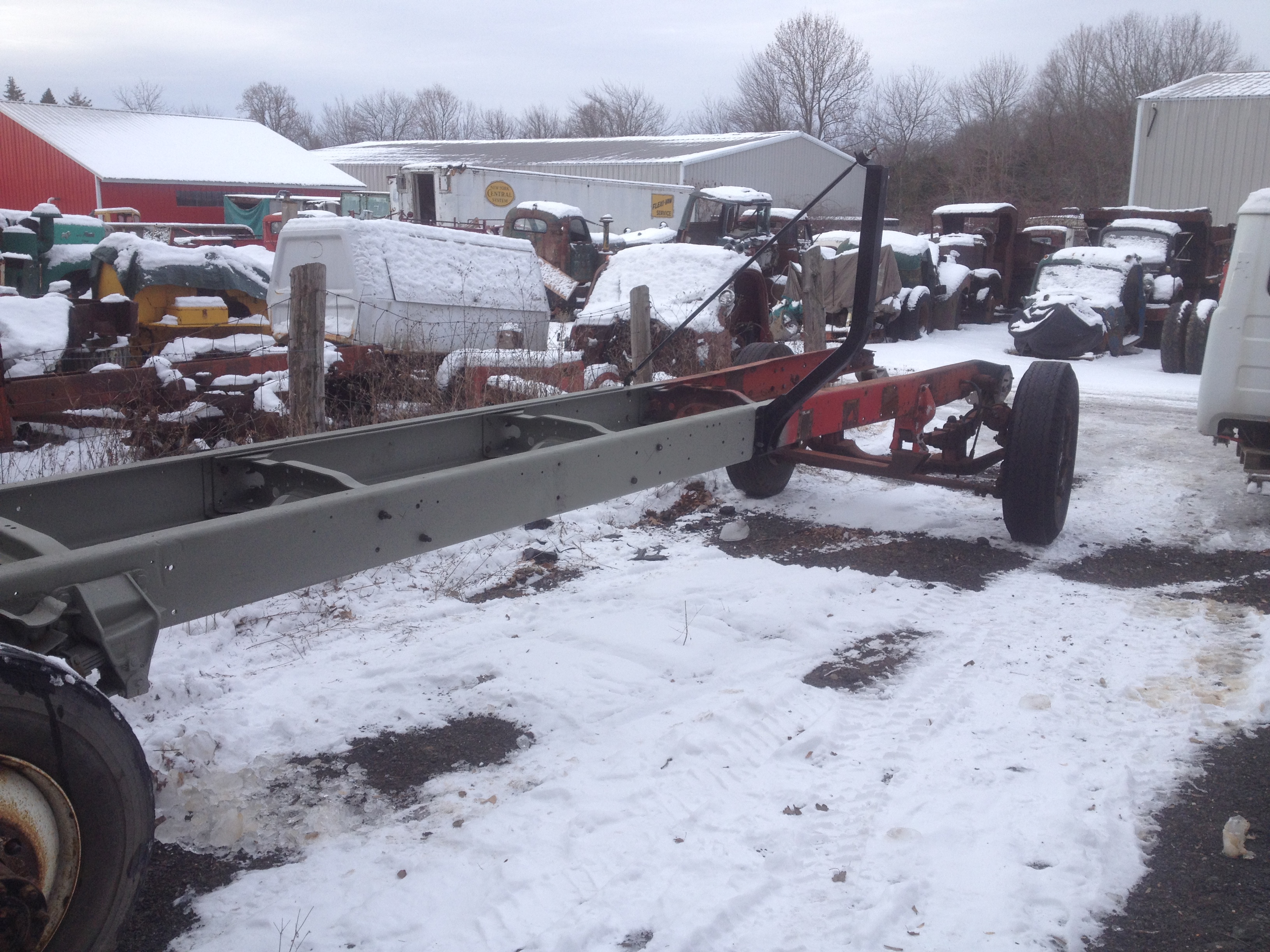

Looks good.  My frame came from a '91 Ford also.  With as much wiggle on the frames, the closest measurement came out near perfect slip fit.    With twelve 5/8" bolts on each side, plus all the other misc stuff bolted through it is not coming apart any time soon.
I made some careful measurements yesterday and I'm going to forego the shims I was going to make. This is also a Ford donor and a very close slip fit, like about 1/16" difference.
Mine was 1" taller then the Mack frame, so I just clamped the top rail and left the bottom be what it was.
Same here with my freightliner rails.   My splice is behind my stack brackets and under deck plate so it's hid from outside viewing.
I used rustoleum red oxide primer and there  profesional grade gloss black.   Figured it would be easy for touchups.

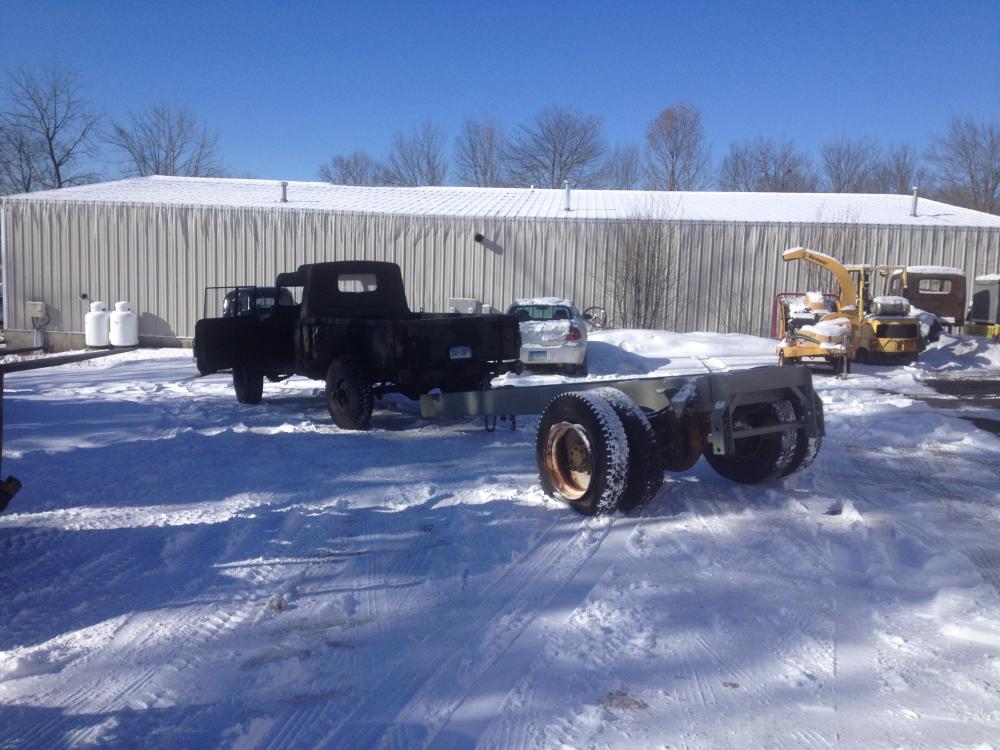

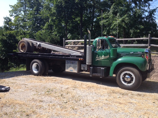

On ‎2‎/‎6‎/‎2018 at 12:24 PM, Freightrain said:
So what is the wheelbase going to be?  Mine is long even at 206" for a single axle.  Makes it look like a 240ish if it was a tandem.
Good guess!! Just threw a tape on it today, looks like right around 249". It's getting a 24' Jerr-Dan rollback equipment body.
