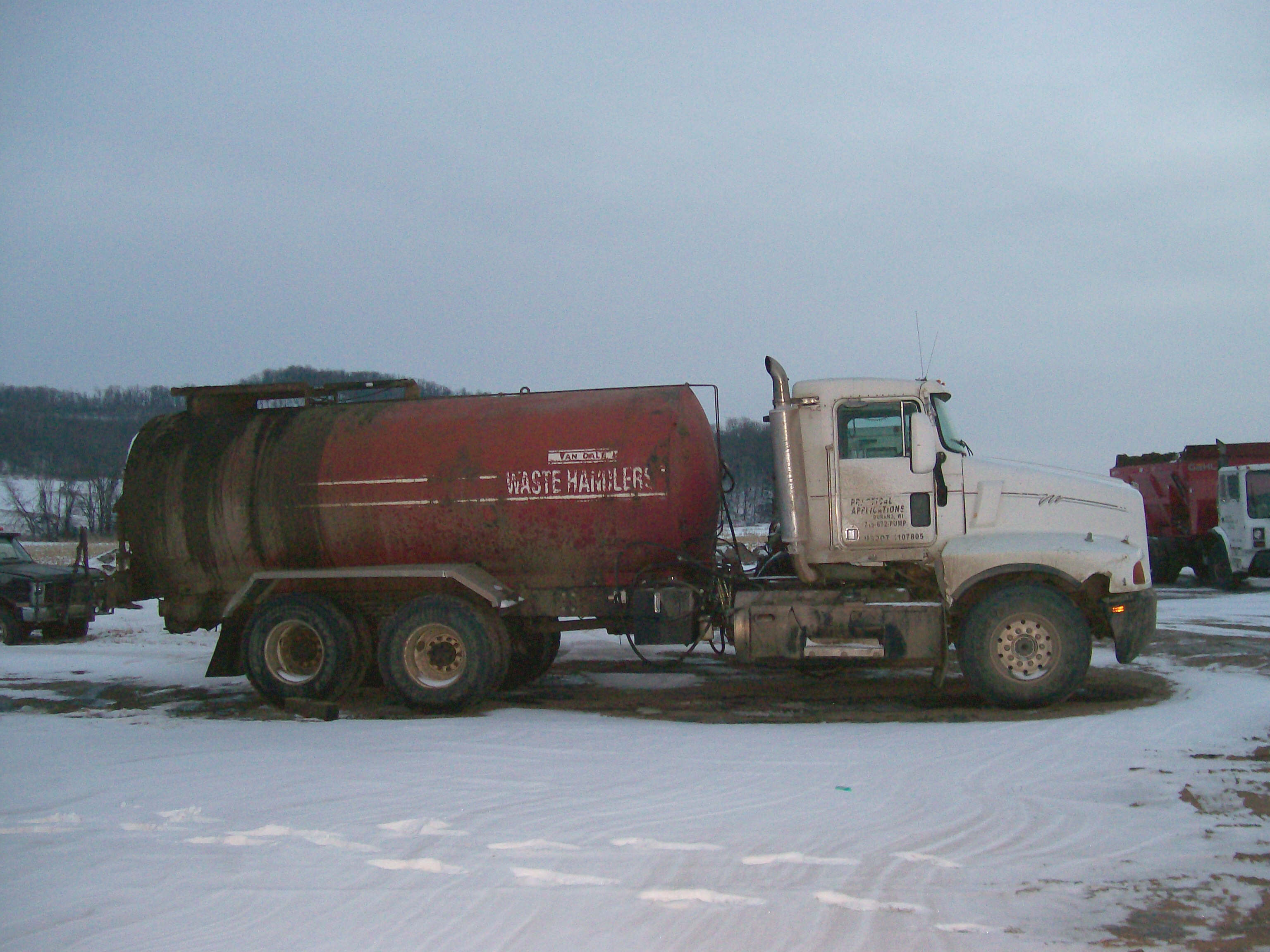

I have camelback on my dumps and have very little problem off road compared to my tractor with air ride. I use the tractor with a dump trailer for hauling stumps and when I get off road, you have to be carefull where you go. It works great on the blacktop when I haul water for swimming pools, and it rides better but seems to have less axle travel witch leads to getting stuck more. Camelback is the way to go for dump trucks, hands down.
