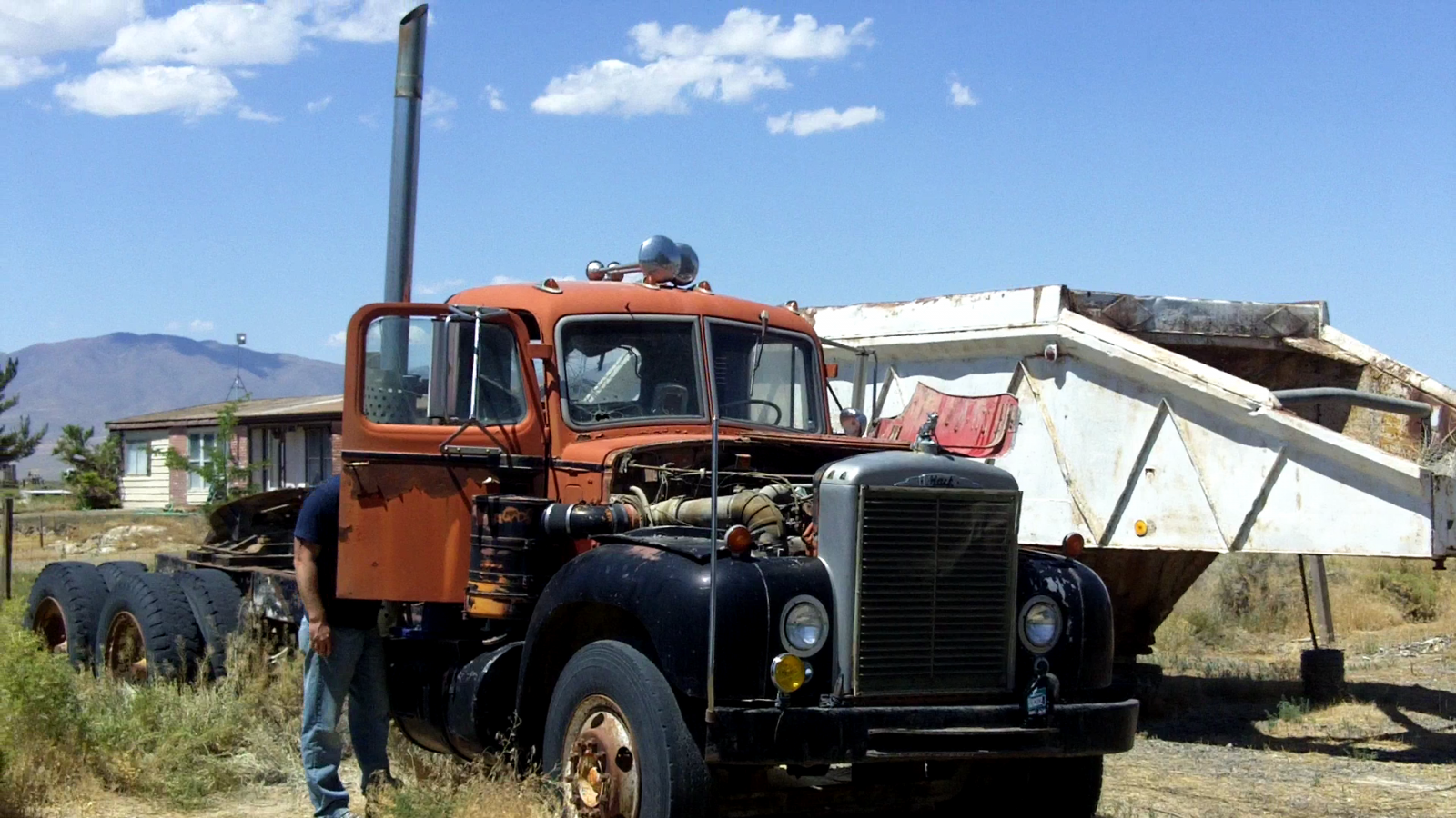

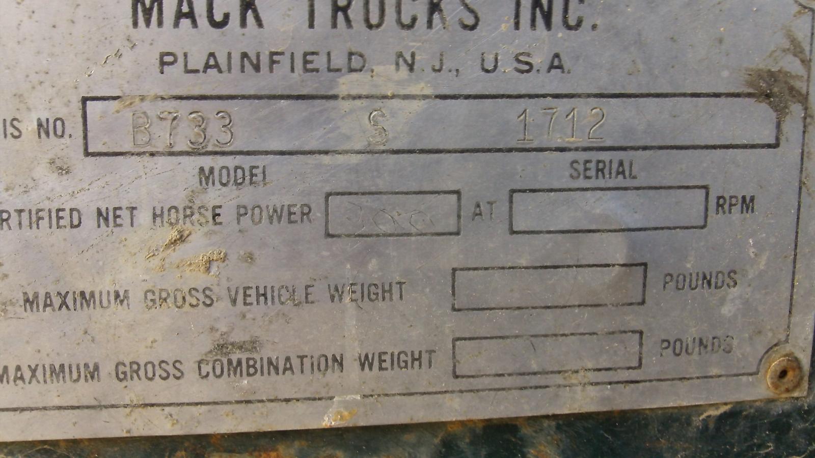

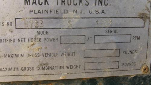

I think this is my first post here after brousing for the last few years. I tried to buy this truck about six years ago but didn't have the funds. I would like to get a little information on this truck if anyone can help me out. The hood has a B77 emblem on it, but the door tag says B733 S 1712. I started the truck when I first looked at it and it sounded good. It has only been started once or twice since then. Would this truck be a possitive or negative ground? I believe he said it was a 1965 model. It will not build air due to what he called a dime valve in the compressor. Are these a common problem and does this sound like it could be the issue? The guy is asking $3000 for the truck and a stone age belly dump that is in rough shape. Do you think that this is in the correct ball park? Sorry for the rambling, any help would be greatly appreciated.

If the door tag is the correct serial #,a B-733 had a 262 Cummins in it.You'd have to check the frame stamp to make sure that is the correct VIN.It'll be stamped on the right side,under the front fender near the rear spring hanger.
$3000 for that truck and the trailer would be a steal,you could scrap the trailer and almost have a free truck.

If that truck was near me for $3000 I'd buy it immediately. Like was said, check the frame rail behind the rear spring hanger on the front axle to decide if the door plate or the hood is correct. I do not know the difference in the models, but either way it is a great looking truck. Buy it quick before someone else takes a trip to Nevada.

I thought the price wasn't to bad, but wanted to check. I went by today again to start it, and same thing as the last time. It would spin very very slow and every thing got hot. Do any of you know when they switched to a negative ground? Is there an easy way to tell if the batteries are long gone. The only place on the frame that is covered in baked on grease is from the top of the front axle to about two feet behind it. Can anyone give me a more precise location for the vin to check against the door tag?

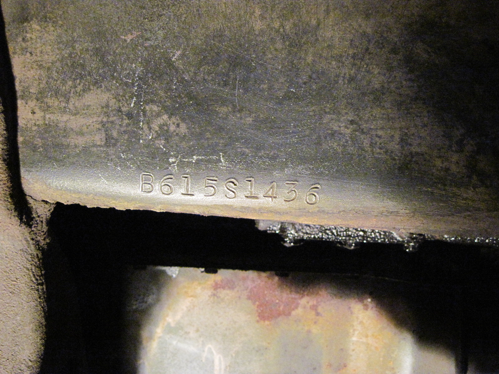

I was looking only few inches away and didnt see mine! Should be down close to the bottom of the frame rail...in front of the rear front spring hanger (passenger side)

Well I have an update. I finally found the serial number on the frame and it matches the door tag, it a B-73. I'm trying to pick them up and haul them home tomorrow if the weather cooperates and my borrowed lowboy doesn't find a job. Hopefully I'll have another update tomorrow. Thank you all for your help.
