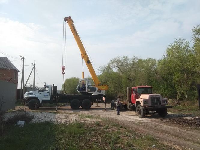

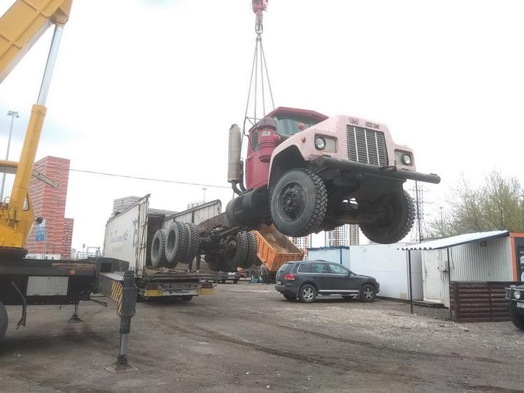

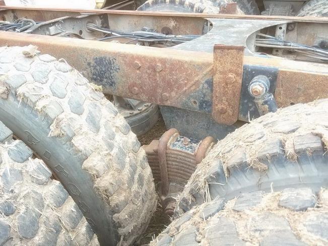

No part 2 of the travel story is upcoming since the truck is already in my yard. The 2nd portion of driving was less than one km from just a paved spot big enough to park a semi and a crane to my street. I live in a residental area so the streets are narrow to slick with a semitrailer in. I will tell more about the truck since it has its chassis stretched up but the job looks really rough with poor correspondence of the rail heigth and helluva bunch of fish plating put at the outer sides. So I'm going to clear those excessive parts off the chassis first and maybe move the bogie to its original position. But need a bit of time to do that and also some time before to figure the best way I would choose.
No trip pics this time because I had been in a hurry and the road itself was not too scenaric. I crossed a big bridge over a river of Volga near a city of Toliatty (where Lada automotive plant is located) but turned out I drove there both times in the dark.

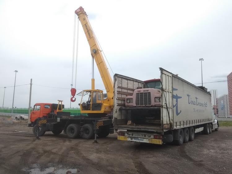

The trailer is a typical European "gardine" trailer as it's called here (and probably in Europe also). It has frames at its sides with rails at the top. The roof is a canvas with cross planks. The plank at the rear end forms the gate opening when in place but can be reattached and moved forward. The same for the other planks and the top canvas. Side canvas can also be freed at the bottom and slid forward along the top rails Side stacks and planks go off really easy being dismantled allowing you full side access if needed. Both operations are simple and can be done by one person (driver) in about an hour. Usually you don't need to open everything so less time is required.

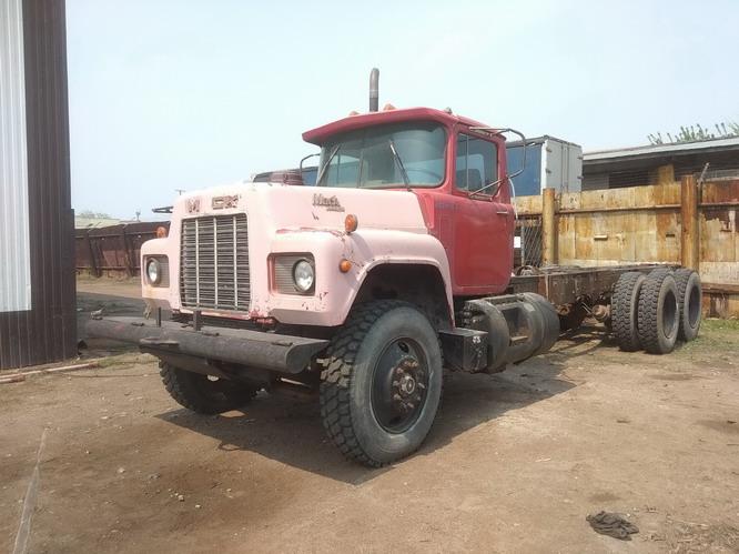

The Mack is 1985 R690 with 4V EM6-300 and T2070 7-speed tranny. Double frame with Camelback and 5.73 carriers as I could found out yesterday. The frame has about no spread probably due to being covered with equipment unit at the top but has plenty of extra holes drilled for attaching the fish plates. Currently I just wonder how many kilograms of heavy 1/2" thick steel will go away.

The cab has air suspension, right. But the front springs are a common style, not those 3 taper leaf setup. My guess multy leaf packs have higher load capacity but ride rougher. Overall look is strange a bit since the front looks like 12000 pound axle and the bogie is probably 34000 or 38000. But those heavy front springs and double frame seem singing another song. BTW the tag says it's R690ST so it was a tractor when leaved the factory.
Vlad, are you sure that truck has lighter axles ?  It certainly looks to be a like something that would be made heavier. Or do you think that may have something to do with having been exported at some point ???
Mark, unfortunately I don't have a better picture handy but looking at this one you see the trunnion style is of lighter series. I have never taken those apart so far but my guess it has rubber bushings or something and not bronze like 44000 utilizes. The axles are fabricated, not castings. Front axle beam looks very close to what I have on my light green R (FAW537 12500 pound) but it was dirty to read the stamping and the ground was wet to crawl under the chassis. Possibly heavy front axle is not always a heavier beam but same beam with thicker spring packs. So the question requires some investigation to figure the truth.
Actually the truck was not exported the usual way as we understand it. It was American oil company which provided works in Russia and supplied some equipment for. I'm pretty sure the chassis was lengthened in tthe States since the add on is 1/4" thick steel (6.35mm) and here in Russia you can only find 6.00 mm sheets. So if anything major was changed to the truck it was done in the US as long as I could judge.
Edited by Vladislav
There's definitely rubber bushings in the centers.  There's such a thing as heavy welded housings. Count the bolts on the axle flange (6 is some form of 44,0000 pound and eight would make it 38,000 pound ...in general. Mack axles can get confusing. 38s have a somewhat smaller axle flange with 8 bolts)    No matter, interesting find and it looks to be in fair condition at the very least.

The axle flanges have 8 bolts what seems suiting that light trunnion. The hubs are steel not alu though and the front spring packs were supposed to carry some load I belive being 10 or so leaves. They more look like off a DM but thinner leaves, I think they were an option for an R-model. Or probably more correct to say taper leaves was an option.

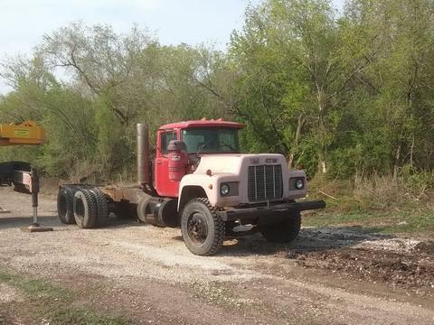

The truck is in fair condition indeed. The engine runs smooth and looks like have never been taken off the truck. And doubly seriousely overhauled. The AC compressor is still on with pipes and condencer. The cab is in a quite good shape with no bothering rust. Just the roof was "walked in" but doesn't look difficult to fix. Frame rails are very good for a 35 y.o. truck, the same with the axles and springs. Another side of the coin is half ruined interior, hardly and excessively cracked hood, both fuel tanks bent at the bottom and that fish plating frame mod. Also the rubber has about no wear but hardly cracked due to sun and age. Overall the rig has a lot of potential, just needs time to put care on.

Hmm... I may agree with your terminology indeed. A transfer case is also a kind of power take off. But to a front drive axle usually (I think?) The unit in the R-model is of very similar style to what was used in fire trucks. anyway I'm going to remove it as well as extra fish plating and other mods put to the chassis. And I lean toward putting the bogie to its original position since the wheelbase still would be rather long. Quite enough to put a flat bed or even a sleeper.
