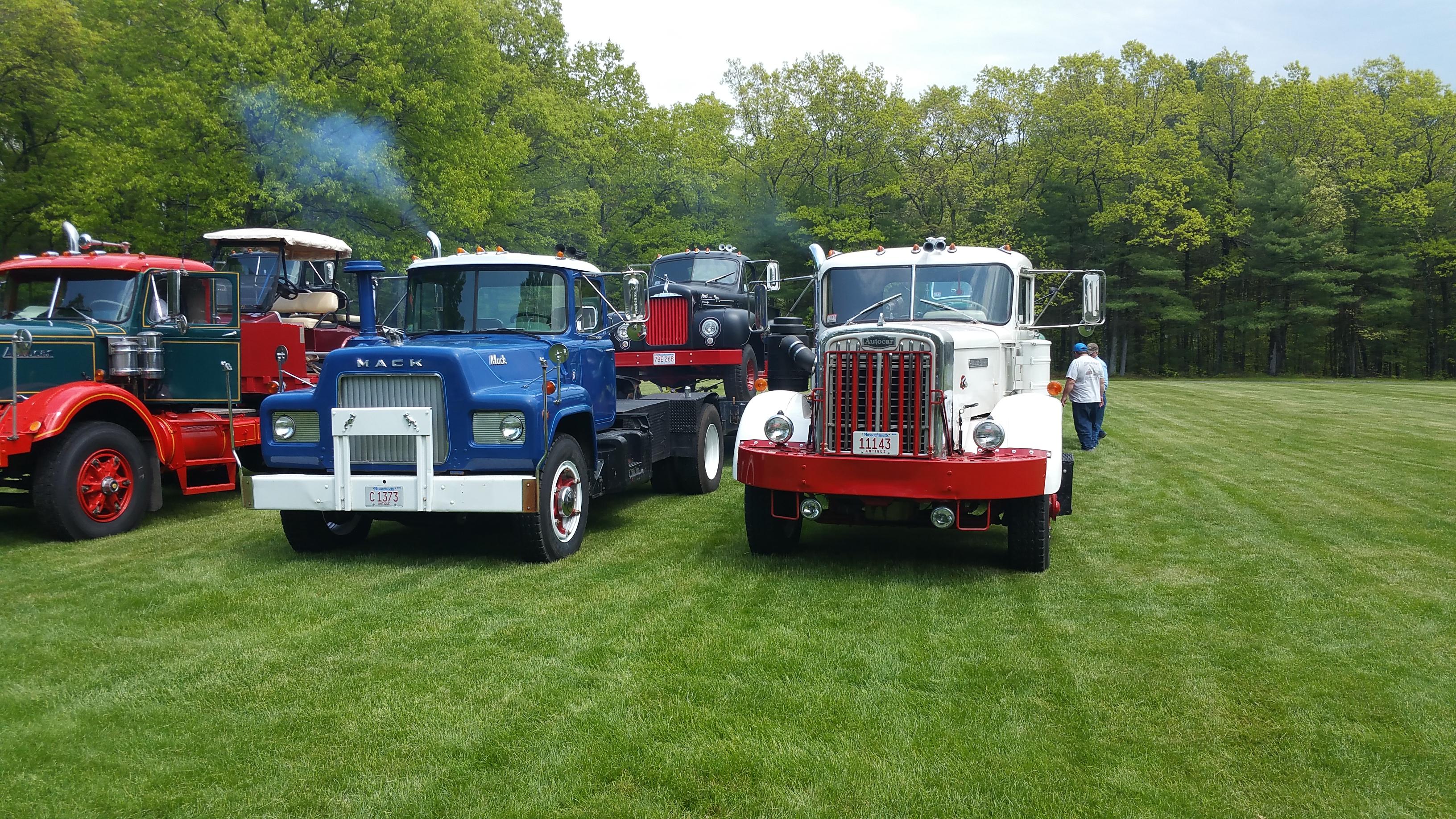

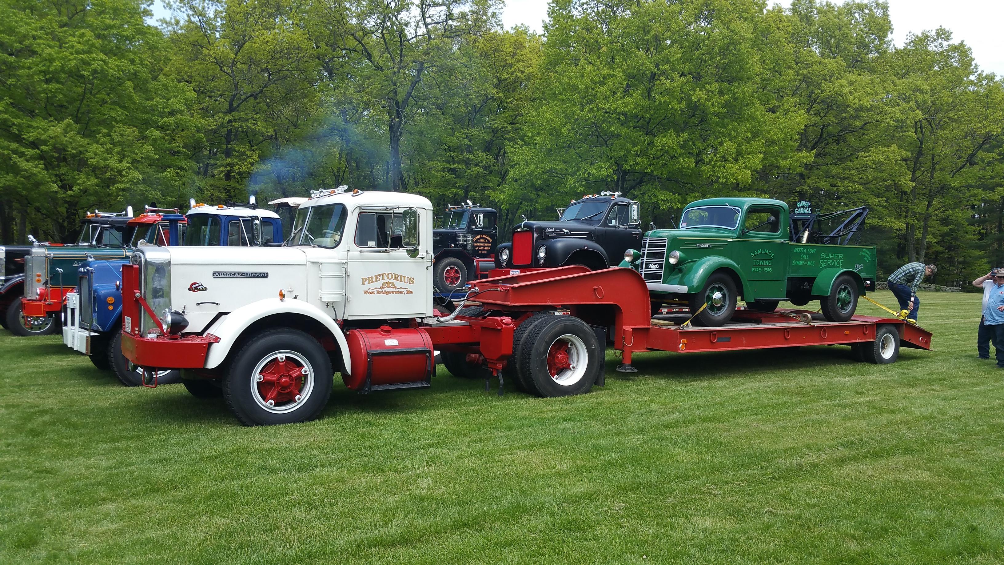

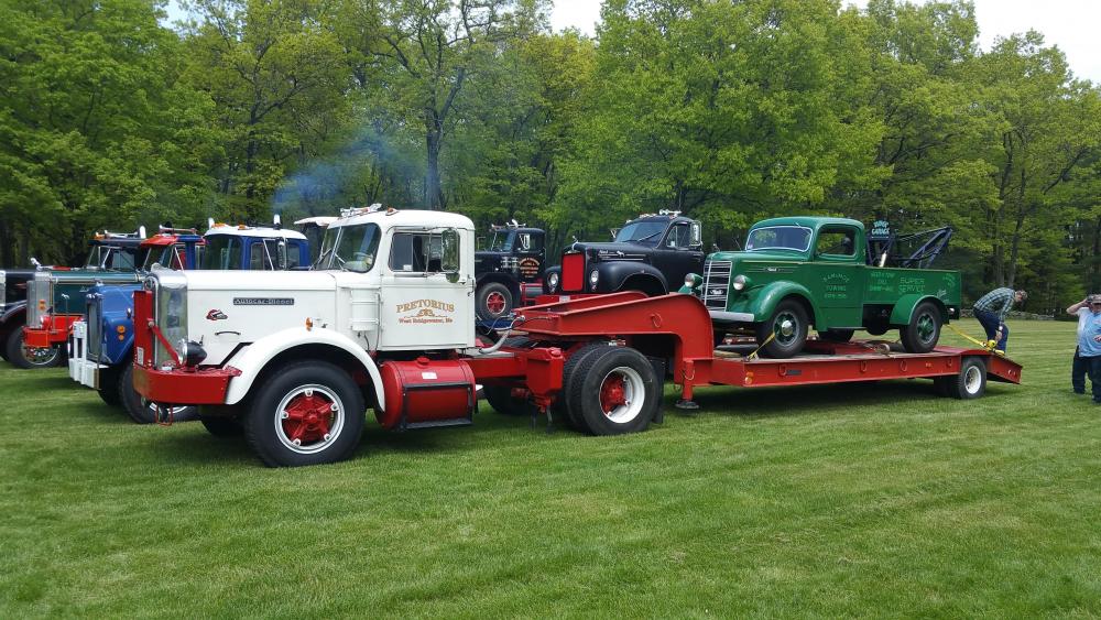

What is the source of blue smoke on the 2nd and 3rd pictures?

My R model was running
What engine it had? Was it cold after start?
My interest is not because I dislike smoke but I would like to know the reasons my one does it.
If you blow smoke like that and the motor is i  good order I reckon you will find the motor is glazing up due to not been worked
Paul
I have two old 237 horses, used as yard trucks once in a blue moon.  They both smoke. Never get worked hard. Injectors good be lazy and worn out, sleeves could be worn out or need to be re-honed, valve stem seals could be dry rotted and leaking oil... (I forget if these engines even use valve stem seals)
If I re-honed them I'd have to do the brake in procedure which isn't possible on these.
48 minutes ago, 66dc75 said:
It was only smoking because I had just started it cold. 5 minutes down the road no smoking.  Its a 673 250 horse built just before the 237 came out.
Besides, it's an old Mack it's supposed to smoke
I like the look of that blue R.
My personal preference is the later series but the earlier ones look nice and very nostalgic.
Got about the smoke went away after some driving, thanks.
