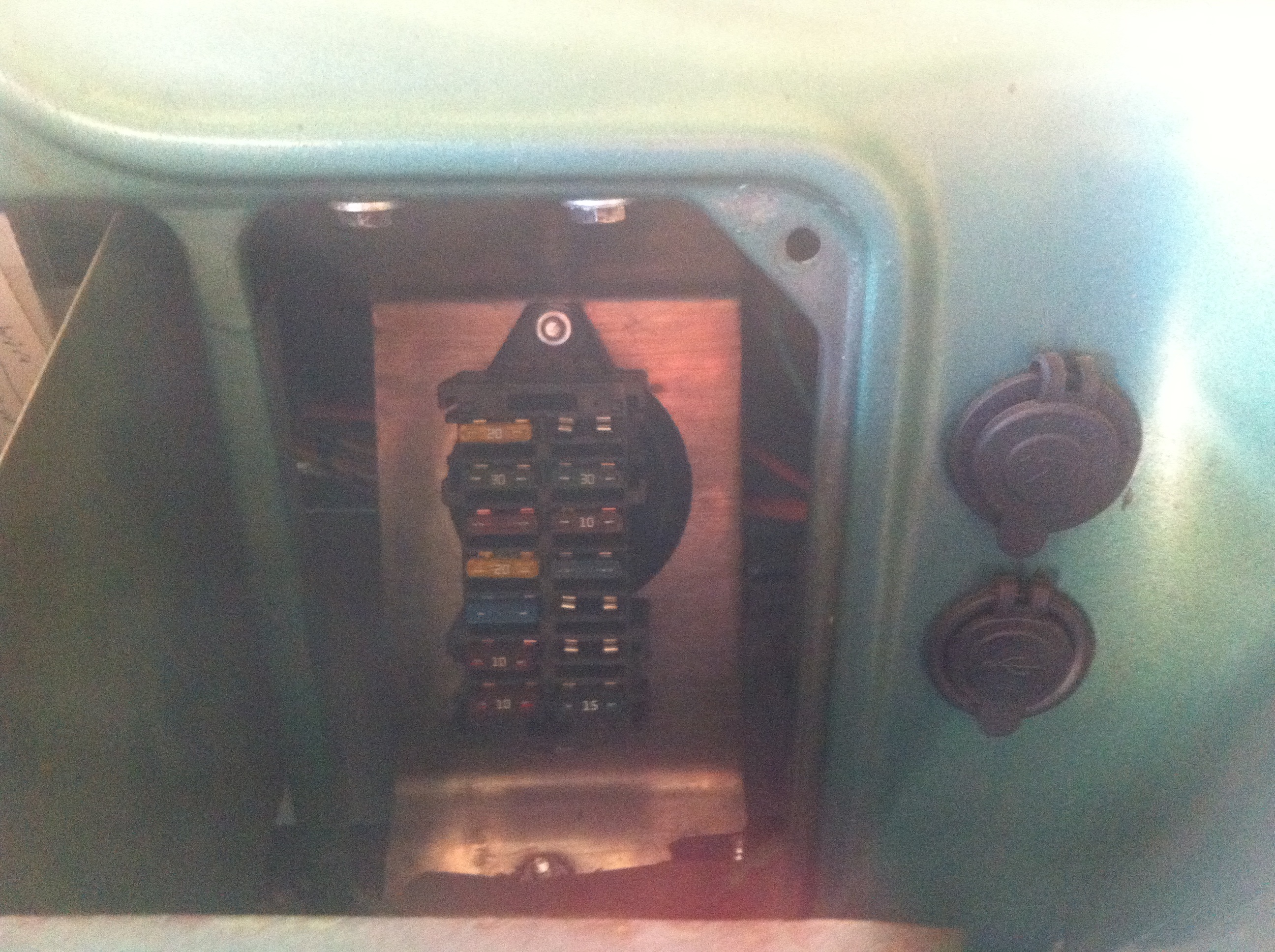

My opinion is I didn't trust 55 year old wiring with brittle insulation and decades of hack jobs.   I cut every wire out of the truck and started new.  I started with  a 14 circuit universal street rod kit from ebay.  I have 3 circuits not currently used, i plan on one for a radio and 1 for elec wipers.   I put  2 of the marine power plugs in fxfymn mentioned.  They came in a panel on ebay, but I threw that away. Their plastic with a big plastic nut on the back to secure(just drilled a hole). 1 is a USB plug other is cigaret style.   image.thumb.jpg.a02f1eae1b6ba47517ae9bd6c44b9d7f.jpgI think have 5 circuits I ran through relays also.  High & low beam, trailer lights, and 2 for tractor lights.    I like the alternator idea also, but I know where your coming from on the look.  On our 2 johndeere's  I still have the generators because they are right out in the open and an alternator looks way out of place. The farmall is hid under the hood so that got changed.
Beautiful.  That is exactly what I plan to do. New wiring harness, looks original while modernizing it.  I may even incorporate the old original fuse panel to appear stock original......make it so it will flip down and have the new fuse panel behind it. Open the glove box and you can see the old panel, behind it is the new one.
