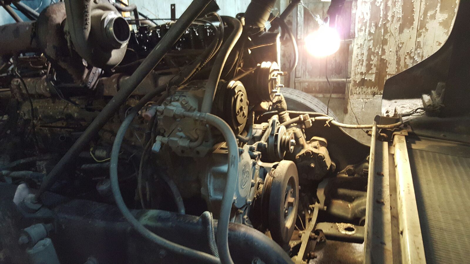

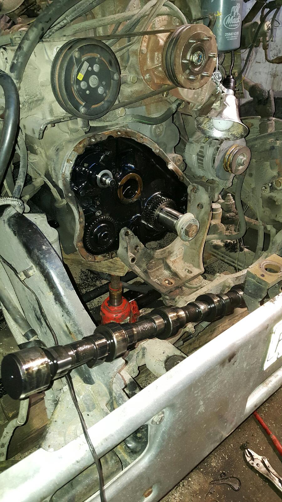

have to preform major surgery on the superdog

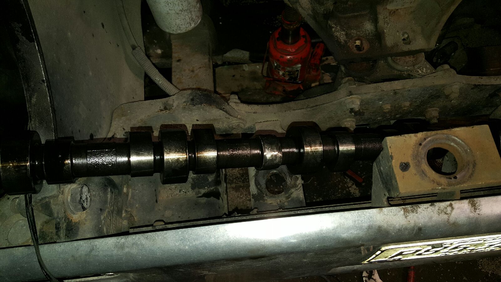

That's it.The lifters that they repair for my friend looks good.They replace the hard face and grind.One of the engines had a problem with coolant in the oild so he replaced the engine and give the old one to me and I took the cam and lifters out for my self.I have used them in a engine of mine but have not put the truck to work yet.
glenn akers
Bet that made quite a bit of noise while it was running.
Sure did was an exhaust valve for number 4 so was popping thru the intake and had noticeable miss. Had to have allen's towing come and retrieve it from cp 600 tow and 3100 in parts but that is a new balancer and motor mounts plus cam and 12 lifters
