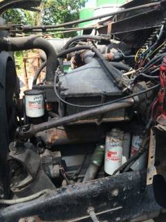

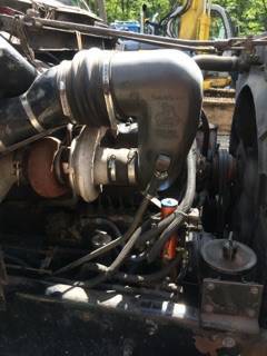

Regarding the eBay link "300"..... It looks like a early 237 or older 673. Just looking that it's not inter cooled. The pipe off the turbo goes directly into the intake. The 285 HP were side mount charge cooled and 300 were front mount inter cooled..
