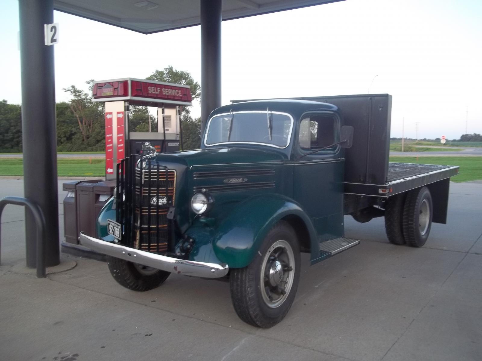

Beautiful!! Paul

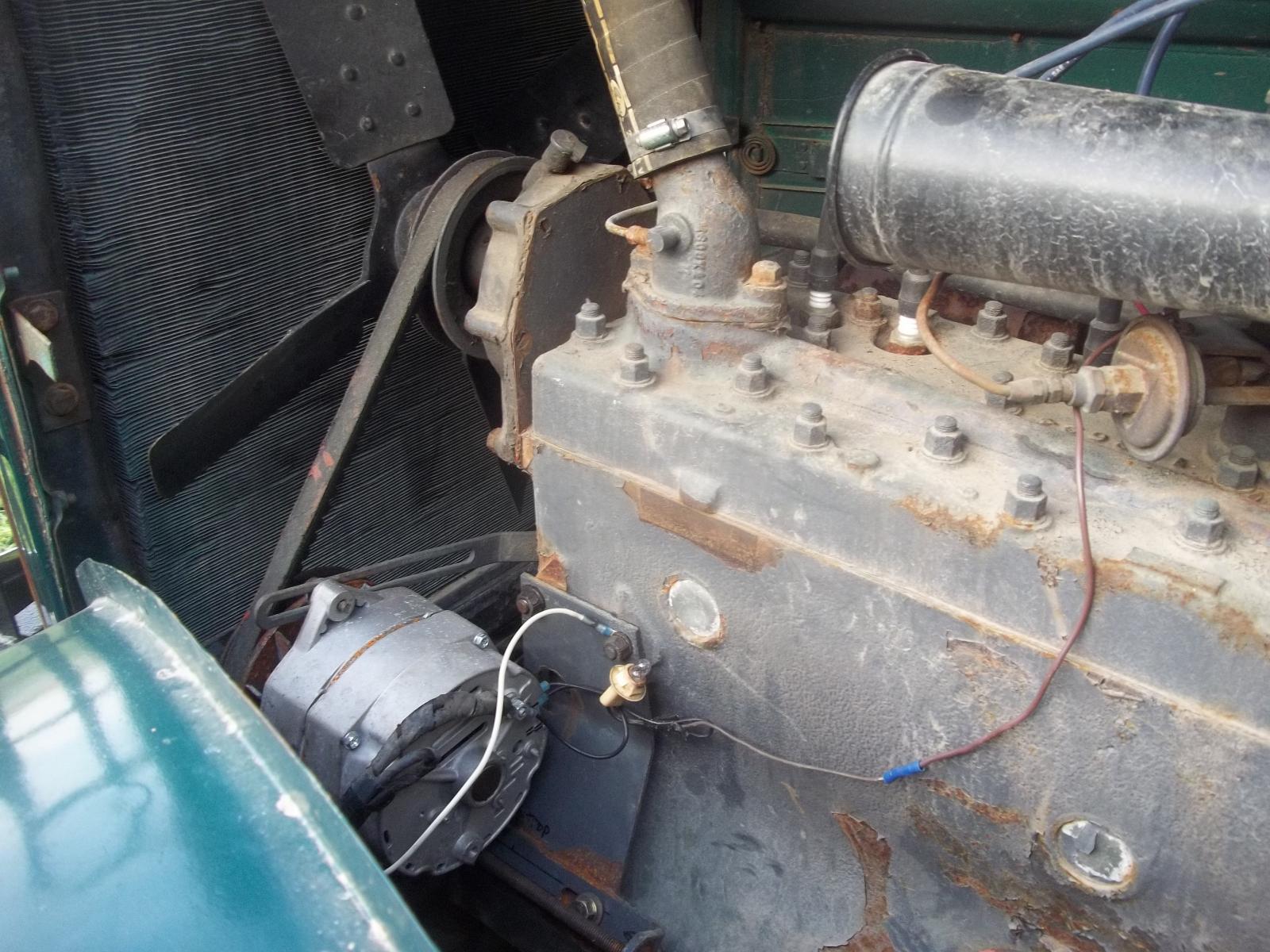

Nice truck! I have one just like it, just not as pretty. I was wondering if you could tell me the numbers or any info on the distributor vacuum advance. Mine is rusted out, and I can't find one to fit it. If I had the numbers on it and make, I might do better. Thanks, Steelman

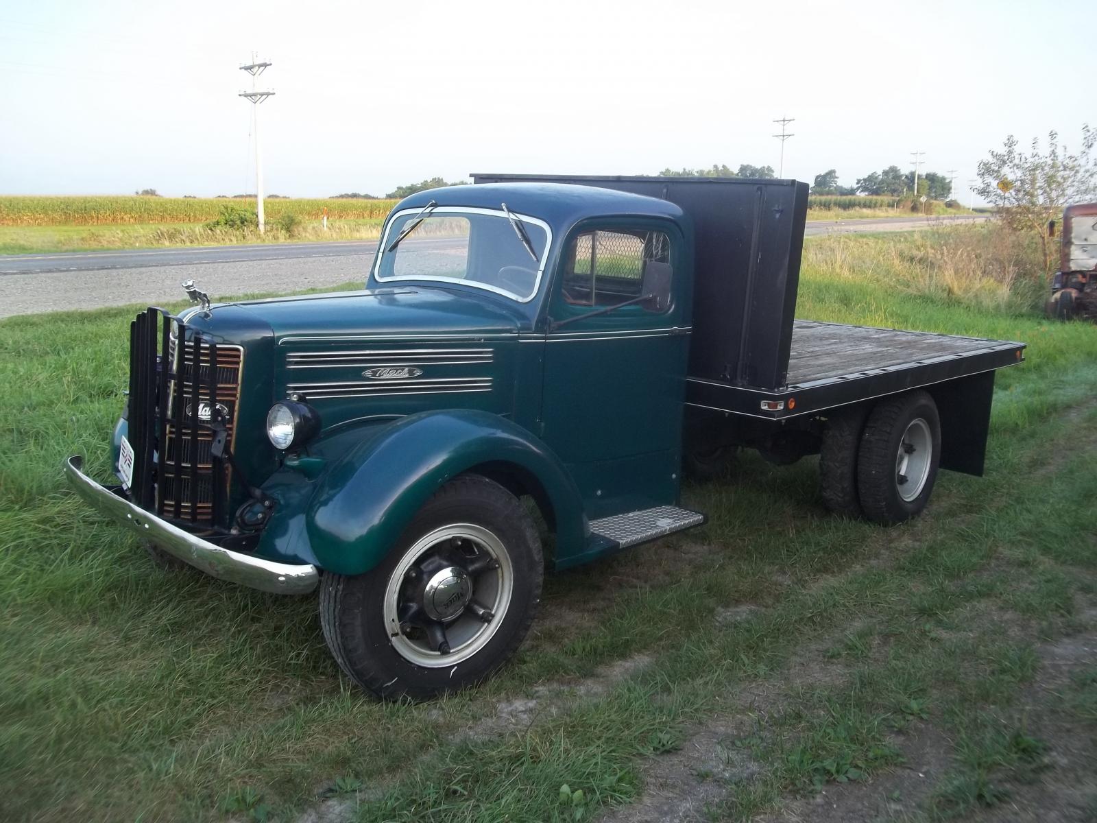

Looks Fantastic!

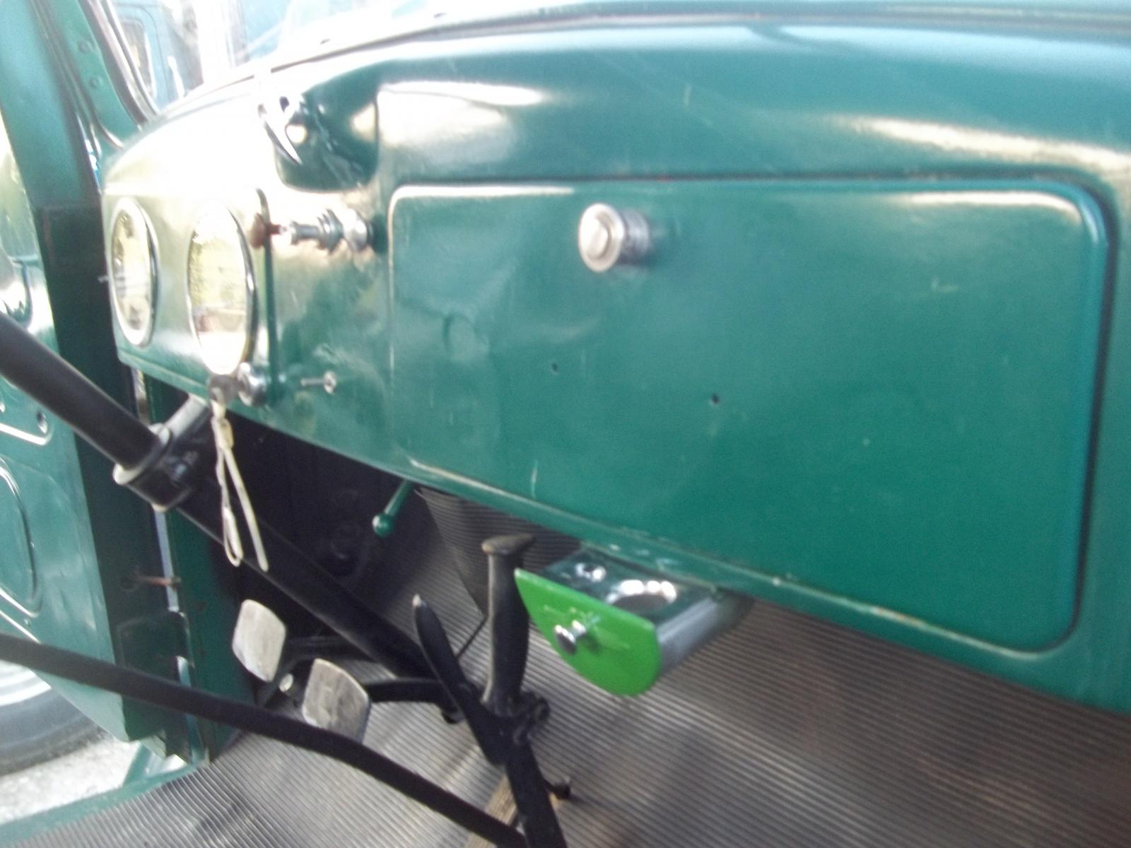

I have seen that style of ashtray in some Mack factory photos so your are good to go there. E models also had an ashtray that could be attached to the drivers door just below the window reveal close the dash.
