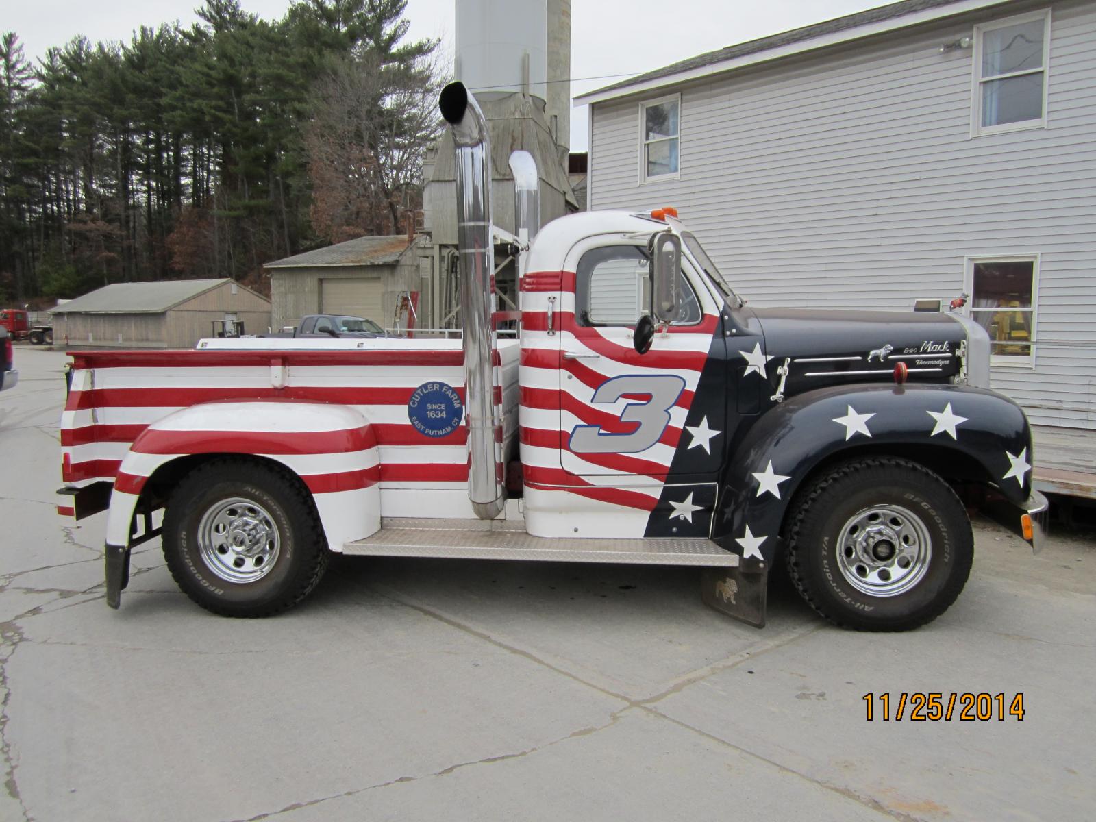

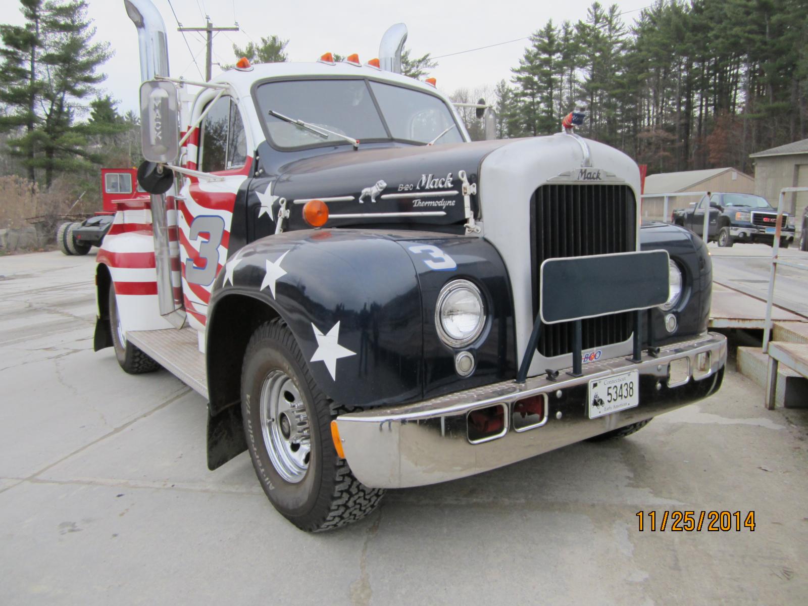

The last on in the first group of photos has some really nicely done sheet metal work. Cut down fenders, grill and the bottom hood edges. Almost don't notice it. Paul
wish I had the specs on what George did to cut down that green truck. its scaled perfect. I know he sectioned the cab cause it has no center section or ash tray and he sectioned the hood, shell and fenders. looks like it has a 53-79 Ford or a Dodge Warlock box on it and that fits well to

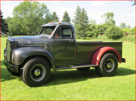

Here's my favorite. Not sure who it belongs to and not sure what's up with the red fender. But I like that it has Mack spokes, presume its all Mack except for the pickup bed.
Now that looks awesome! I wonder how they singled out the rear?

yup, knew he sectioned the cab . looks like he might have done both of those green trucks? one looks to have a standard hood shortened, and the other an aluminum B67 hood. I think I could handle all that except would need some guidance on the fenders. the fenders look perfectly scaled down. looks like he took a few inches out of the whole center of the fender, then cut it in half and took about 3 inches out the other way. he also sectioned the shell, then had it rechromed I see. I remember when that truck was first done before Tackaberry owned it. the all green one that is. the green and red one could almost be a twin
