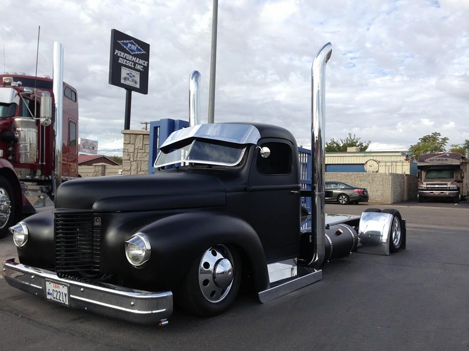

No guys, what I'm talking about is taking the leaf springs off and replacing them with an air ride system that will allow me to set the truck rails on or near the ground when parked. It's more of a style thing than anything...I was just sort of hoping that it might help the ride quality by changing the heavy leaf springs to more forgiving set-up. My plans are to do a truck that looks similar to this one, but notch the frame and put an air bag suspension system on that would tuck the front tires way up into the wheel wells, and set the battery box, fuel tank and front bumper with-in an inch of the ground while parked.

That's exactly the look, Bigdogtrucker....actually, that truck is the insperation. The difference is, that truck is on a E350 Ford drivetrain and I'm going to keep my set-up all big-rig. I saw the build thread on this one...and while it looks great, it's still a "light-duty" truck. I wanted to keep the original look for a B model semi, but be able to tuck the tires and lay the battery box, fuel cell and front bumper on the ground, as in the above pic. I thik my ride height will have to drop 6 inches or so, because I don't think bags allow for enough travel to get my battery box step to the ground, and then back-up to where it is now. Most travel I've seen is about 6"-8", so I'll be riding lower than I am now, but be able to lay it out at full drop.
