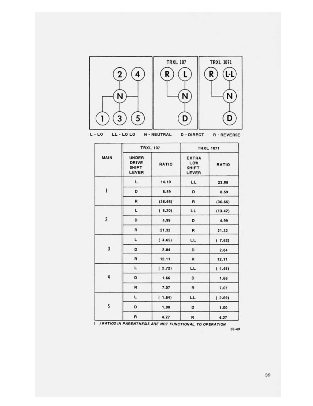

Here is what the manual says for the transmission, mine is the TRXL107, It says it is "impractical" to use Low in any gear other than 1st. When Bobtail I use it in Low with 2nd and then shift to High than 3,4,5.
When I first got the truck I tried starting out in Low 1st and High 1st and it wants to start bucking. I guess that is why I use Low 2 than high 2.
Interesting to see the manual. My truck is an 86 R. I'm mostly on city streets so starting in 1st direct is fine. I only use low in the mud or crawling out of a hole.

If you could run a slow truck race in reverse that low-1 combo would kill em, 36.66 that's low.
