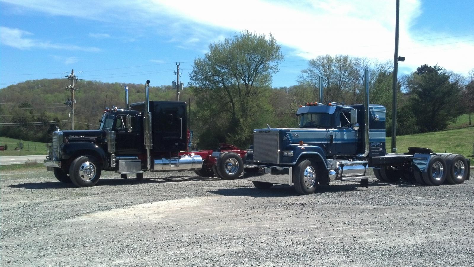

Workin on the Superliner
Go to solution Solved by hatcity,
I was thinking of going with round horns on my superliner. Hadley makes round ones now that fit the same holes in the roof as the square Hadley horns where Grover bolt pattern is different.
Must of had a Grover originally as the new one bolted right up. I think my valve went bad though.
Damn, that's lookin' GOOD!!! Love the original old school paint scheme. Keep it "original" looking!!! Don't go all gansta on us!

don't take the horns off the roof,please,you have way too nice of a truck to do something that damn Peterbilt to it.You can still put the extra lights on without taking them off if you want,but I always thought 5 was plenty anyway.
i agree mike, i drive a pete daily and i am not a fan of taking the horns off of any make truck, in fact i like to have 4 big round ones up there 10-4.

Vlad I cut the outer frame and moved the rear section back with my trunnion so I only had to drill the inner frame and had a drill guide for all the holes. I have another piece I have to cut and section and weld in place to extend the outer filling that gap. I just don't have enough hours in the day to do it all at once but I'll have it finished soon. I don't know about the horns on the roof, I have had Macks with both horns and no horns. I don't consider it making it look like a peterbilt I consider it making it look like you want. A Peterbilt comes with horns on the roof too, I like doing things others haven't and making a Superliner look like I am is gonna be different. I have never heard anyone say Sal C's truck was messed up because he doesn't have horns on it. The way I see it I bought it I paid for it and I'm gonna try to get it fixed up the way I like and if I do something I don't like I'll change it back. Its all back tot at personal preference thing, I wouldn't have big flames on mine but I'm not gonna say no don't do it cause its not mine, I might say I wouldn't go that route but that's it. I think it will look nice when I get it semi finished in about 4-5 years, I'm out of income tax money so the truck won't get much more for a while now I have to use up the pile of parts in my garage and office.

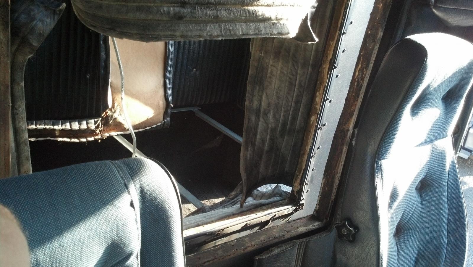

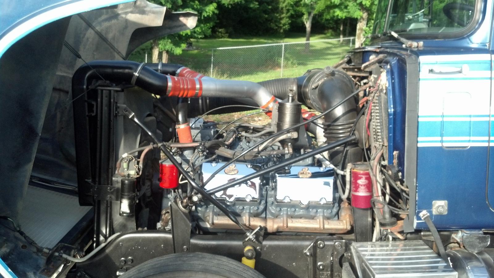

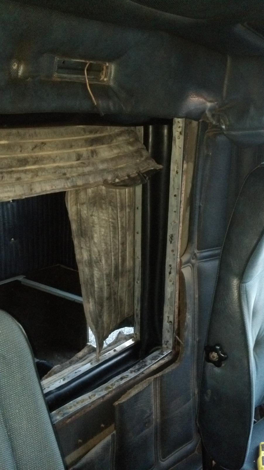

Well I got a couple more things half done yesterday and today, I got the old sleeper boot out and replaced the so called rubber outer. I used some 1/8" rubber sheeting used for making gaskets from a local hose and belt shop, I had em cut me a roll 10" wide and 11' long. I think it'll work better than the rubber coated cardboard or whatever was in it, I gave it plenty of extra material between the cab and sleeper for movement since have an air ride cab and solid sleeper. I got some new original chrome turn signals on right before dark and put all new hardware (bolts, wire clamps) under the hood it was all crusty. I got a few more projects I want to get done before this weekend. I'll go ahead and give you a spoiler alert the Superliner is set to appear in a music video this weekend, if all goes well and they actually go thru with it I'll get a link to the video up as soon as it becomes available. I promised I wouldn't give up any info until they had it ready so don't ask, I will say that D Wrays green RS700 wrecker and my Superliner are set to be in it. Great day for old Mack trucks if you ask me.
Almost forgot, if your planning to replace your sleeper boot beb prepared there were just over 2.6 million staples in mine( I lost count around there).
post-5240-0-61184700-1366160491_thumb.jp
post-5240-0-75818400-1366160581_thumb.jp
Did some 'liners come from the factory with just the window to get to the sleeper? Some I have seen have a different cab back that the opening went to the floor...or is this just a good way to do and add on sleeper without cutting the rear cab?
Yeah mine was cut as a sit down, of course its still too tight to just sit down if your over 10 years old, they cut the cab out and added a panel to get the opening they wanted. I have ppondered on opening it up more b ut with the way the sleeper is built it wouldnt get me anywhere since the mattress is higher than the bottom of the opening now.

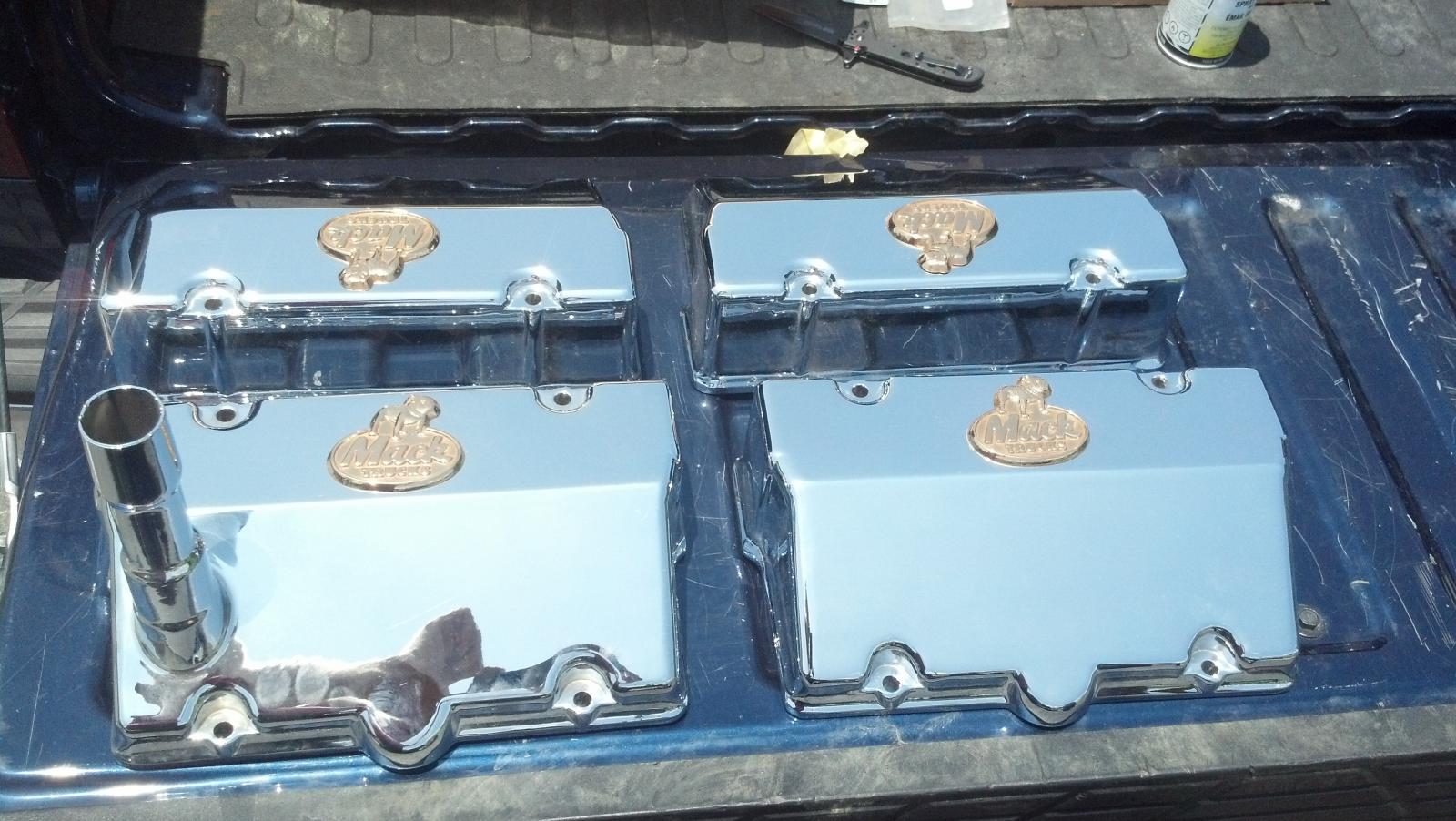

I don't know, these might be too shiny for me.
