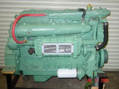

Now listen here fellas, There is A Big confusion here. There are TWO "Detroit Green"s on this earth. If you talk about them, you should specify. Also, niether one is the same as the "Mack Green".Take a look:
The "Old" Detroit Green:
post-10909-0-63694800-1357439976_thumb.j
The "New" Detroit Green:
And just for comparison, the official "Mack Green"
post-10909-0-26932600-1357440580_thumb.j
Please take careful note of the differences.
Ben

Yes,Matt is right! Even early R model green is not Alpine (or Detriot) Green! To me,the best way to match any of your paint,is to bring a sample into your paint supplier.They can match it (for a price)and it will look right when your done! .............................My 2 cents!
I would never suggest that Mack green interior paint is the same or even similar to DD engine paint. But maybe if you mix Mack green with oil you will get DD green! coollaugh.gif
