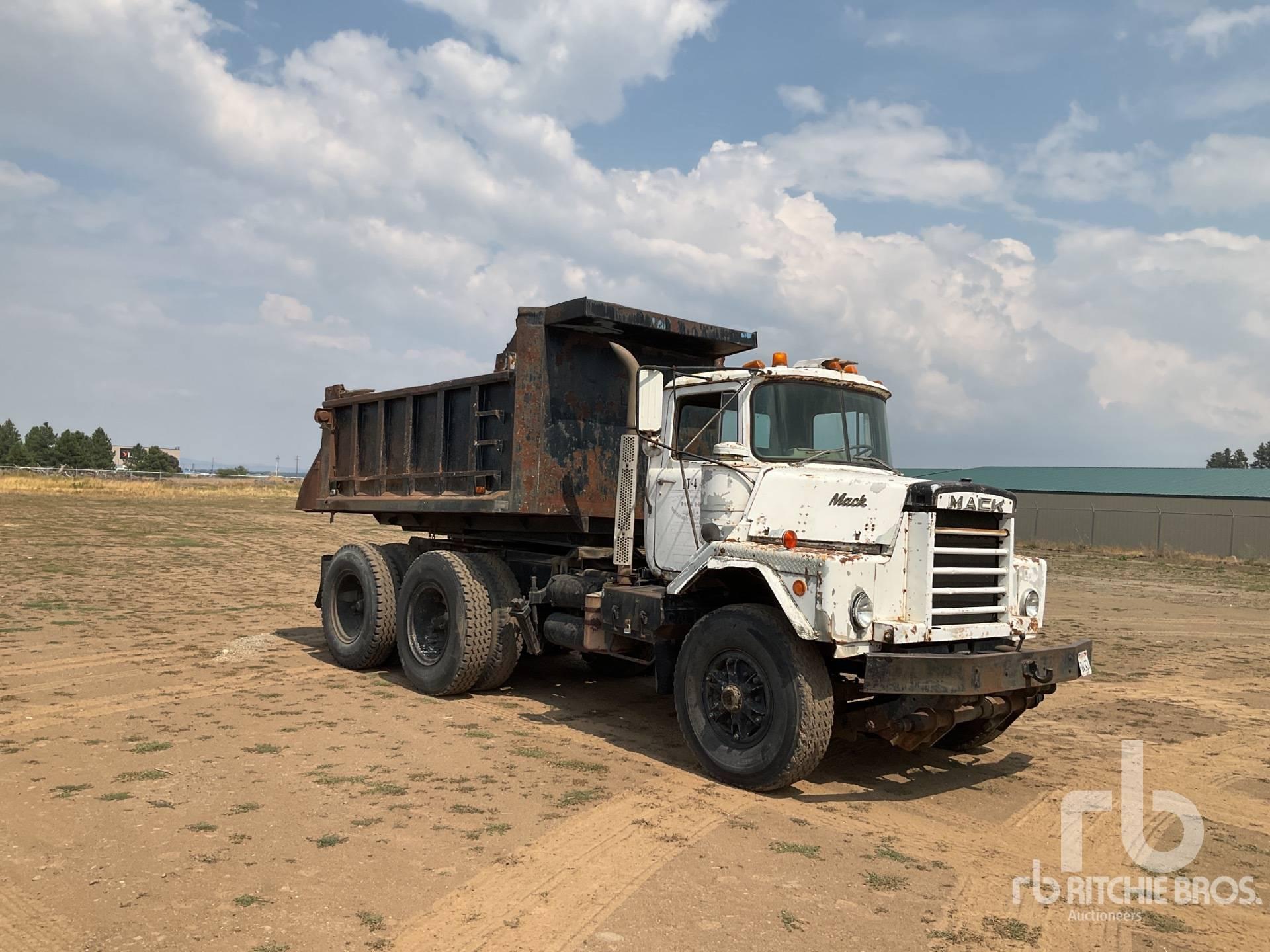

Bought new to me 1979 Mack Dump Truck

Thank you all for responding. I do not have the truck in hand yet. I paid for it but the front tires were in rough shape and no brake lights. I am having a guy I know deliver it. It's going to cost more but I do not have a CDL and it is in another state. So crossing state lines, no CDL, bad front tires and no brake lights...I decided to have it delivered.  Sometime next week. I will get more pictures when I get the truck here.
I am chomping at the bit. I want to get to working on it. Cleaning it up. You know, making it mine. Once it is on the property, I will tear into it to fix the brake lights and get two good front tires.  Surprisingly, the rears are all in okay to very good shape. Thank you again and more pictures to come.
OH, and the first two letters in the VIN are DM. So, DM600 something for the model?

I got the truck home today. Drove it 115 miles with no break downs. I couldn’t find anyone coming this way to deliver it so just took a chance and drove it.  I had to adjust the clutch pedal as the clutch was slipping.  I can’t down shift at all.  Trans won’t stop rotation when down shifting and just wants to grind. Clutch started slipping going uphill.  That is when I stopped and adjusted the clutch pedal return bolt just to make it home.  Lots of little things wrong.  Rpm, speed and fuel gauges do not work. Got the brake lights working.  Bad wiring and rusty bolts were the problem there.  Anyway, it is home.  More pics coming in a day or two.  Guess I should start a thread in the proper forum after posting pics.  Thanks everyone for the welcome and help.

enlarging the picture shows it has the"big" rears with bolt on axle caps.
