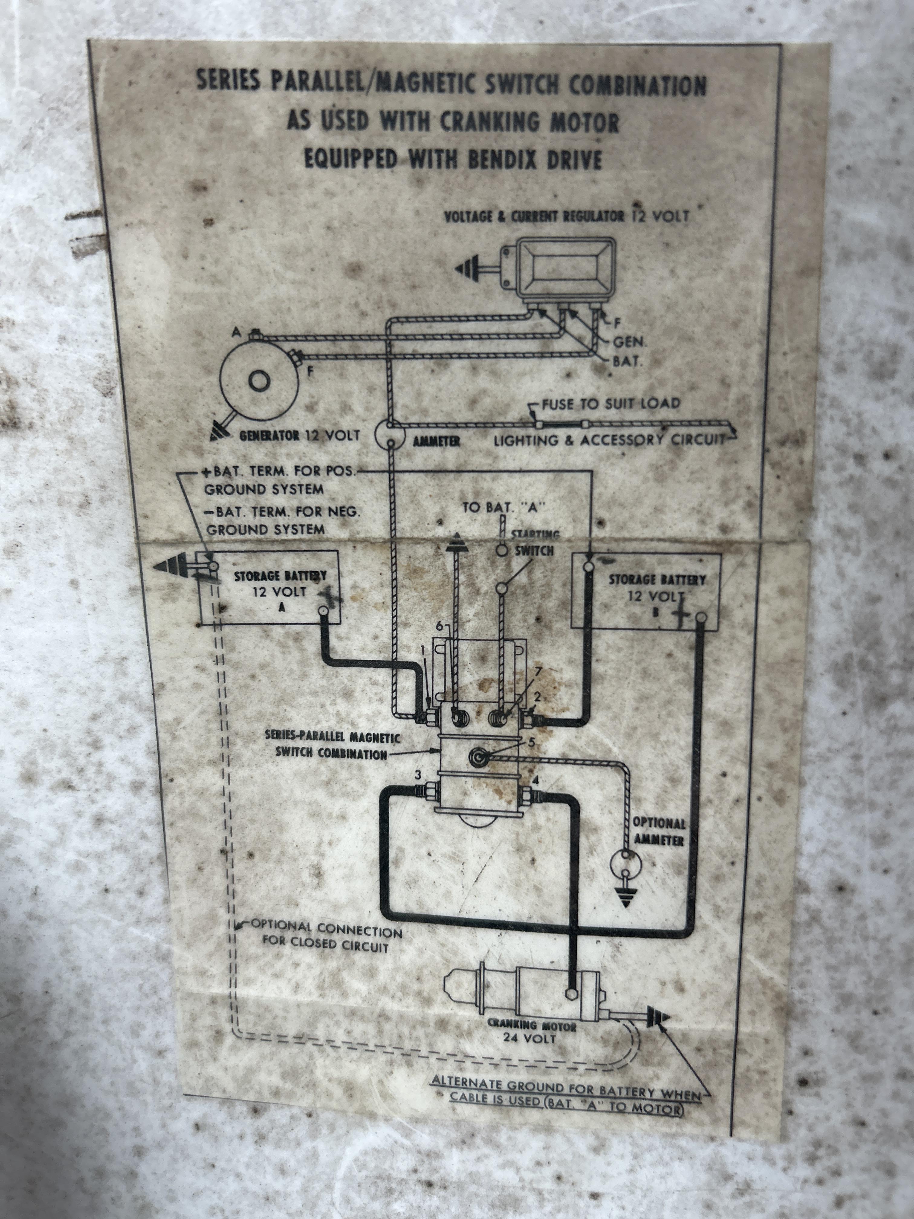

I’m wiring up the truck now. Using 2 12 volt batteries,not 4 6 volts ones.Here’s the diagram I’m using,is this correct?I am pretty sure the truck is positive ground.Anything I should be doing since it has been about 15 years since I last wired up a Mack.image.thumb.jpg.f69e31d9483fe463ba79e98ce974ae0a.jpg
that diagram should do you just fine since only change you are making is the 2 -12's VS 4-6's. difference in dia with 4 -6's would have two 6 volt batteries tied in series on each side. 6's in series = a strong 12 also give a longer lasting cranking power.
Tks,it has been about 15 or more since I last did this.Just don’t want to burn anything up

Series parallel is pretty simple, more confronting to look at than it actually is
Follow the diagram and you'll be fine
Paul
Finally figured out that my sps is bad got 24 going in and nothing coming out.So I went on line and found one.So now I wait for my oil filter( hopefully Friday),sps also thinking Friday.Will be busy this weekend if all goes well.
Finally got it to crank over.That series parallel switch gave me a fit, figured my switch was bad.Got one off the internet and just waiting for the oil filter to come in at the local Cat dealer should be in in the morning.
