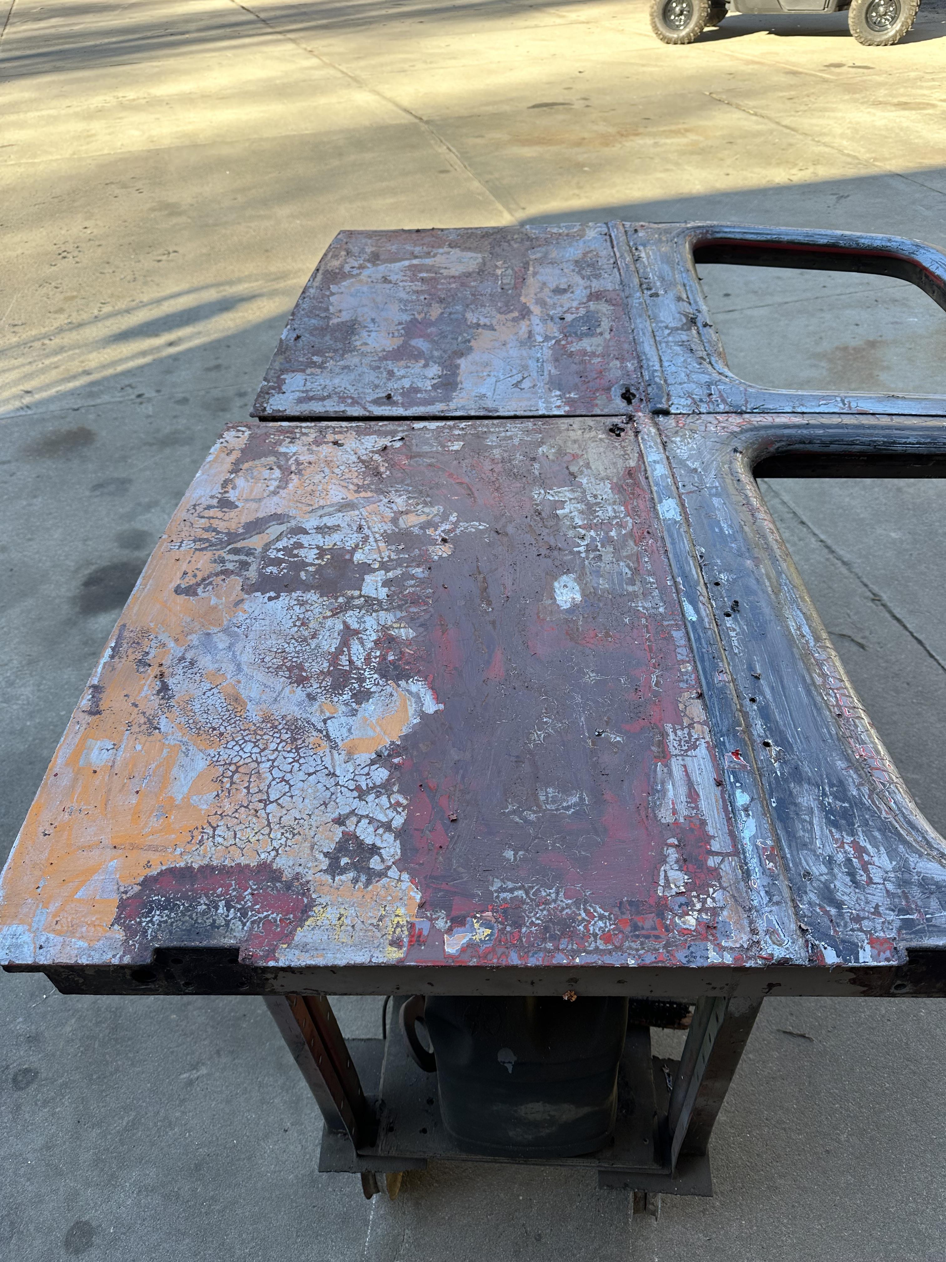

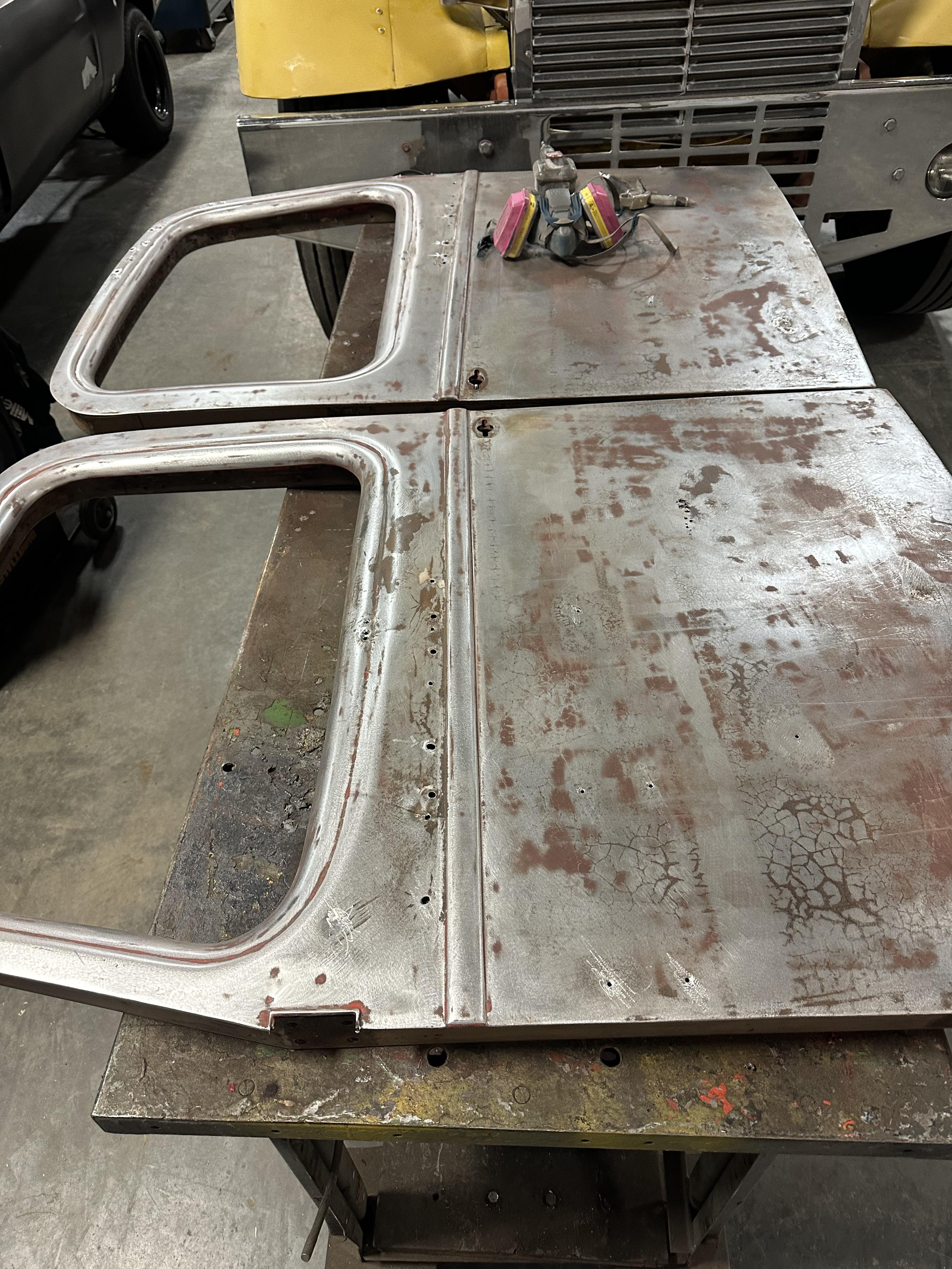

My goal is to hand sand the complete cab and get some primer on it to prevent and more flash rusting.Then when I’m ready to send it off to a body guy I may sandblast the whole thing for him so he has bare steel to start with,or what he wants.What’s everyone’s thoughts?
You don't need to remove all that surface rust if you're going to sandblast the whole cab before painting. Sure if you don't see a 10 years gap in time. Actually strange to see that much of it as long as you work in a shop not outside. Is the compartment dry enough? Or do you do wet sanding? And what is the reason at all you do that?
To me it looks at least two ways may be chosen at this point. 1st you remove all the items off the cab, repair areas where actual rust through or dents take place, than sandblast the whole thing and bring its further faith into the hands of paint guy. 2nd is you sand off a certain area, for the best a portion of a cab with some borders, than mask the rest and apply primer, self etch or epoxy, depending on the religion you prefere to go along, and continue working on the next portion. This way no need in media blast is seen, or possibly locally only where deep rust was detected you can't sand off. Then paint guy will scotch-bright or sand your primer up and put his other layers over it.
I used my steam cleaner to strip some parts, works well when the water is that hot. I used Nason Ful-poxy primer and was very happy with it, but if you're going to blast later that would be overkill. I used it on the chassis, engine, etc. and it really sticks-hard to scratch or chip. You have to top coat within 24 hours but it sure makes a strong coating when you do that.
As long as you got  it down that far you might as well bead blast , the whole thing yes, that’s definitely way to go, but do not use the sand like the other fellow said Save a lot of work then it’s ready for paint then of course you gotta make sure you blow all the shit out after they get done so it doesn’t surface when you start painting. Good luck. Great progress you too.dean….bob
