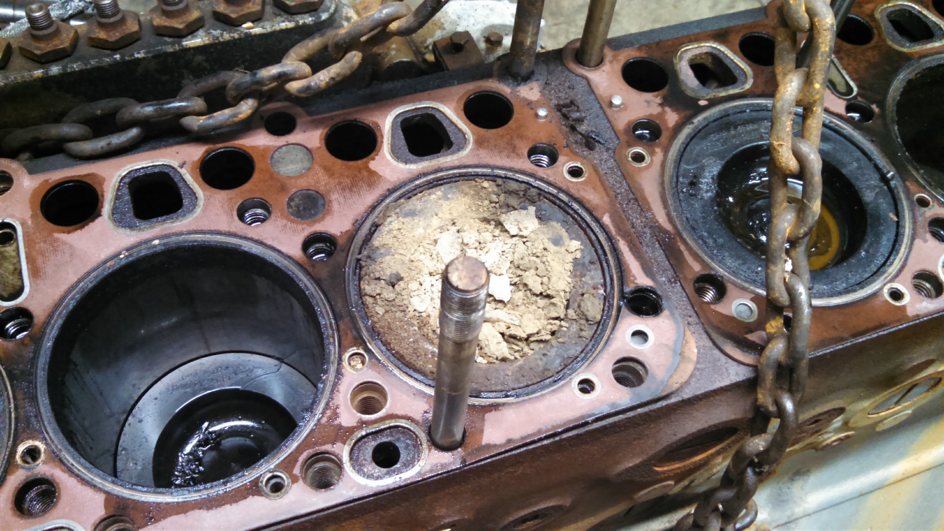

Pulling injectors on a 673
Craig N
Go to solution Solved by theakerstwo,
I don’t think your sleeves are going to pop out but who knows I freed up a Chrysler slant six years ago just with mystery oil at typing the Pistons real light with a chunk of wood and I hammer again patience don’t get in a hurry but If the rings are rusted to  the cylinder walls you’re better off to punch them out and at least clean everything and reassemble .. Good luck Bob

Well would you look at that!  I didn’t realize they had all this for these still. I hope I don’t have to get into sleeving this motor, but if I have to, good to know they still make parts.
Do you know if there’s room to drop the oil pan with the motor still in?  I’ll get under there tomorrow to look. There’s a good machine shop close that could do the crank if need be. Man, I really hope not. I’m really hoping for a nice clean up and breaking it free without busting anything.  Would be nice if all I needed was a gasket kit!!

Are these dry sleeve or wet sleeve motors? And if they do pop out why could't you just reseal it and pop them back in?  You can check the condition of the cylinders and check for cavitation if they're out.
Also do Mack's have problems with dropping or sinking liners like Cats do? I'd imagine sleeve shims would not be easy to find for one of these.
If someone is putting a lot of force on a crank to move a seized engine then pushing as sleeve out is well with in a possibility
Then as Joey suggested these are a press fit or freeze and get back
This is all gunna be a challenge with a pistion still stuck in a sleeve
Anyway thats how I would deal with it

Awesome, I’ll be sure to call and order if I do end up rebuilding. Hoping to know what the inside of the combustion chambers look like today.

Yup If it's just a toy Why piss away a big bag of cash on a rebuild! In my mind, open it up and see what's there pulling liners on this old stuff can be a nightmare I have had it where the whole weight of the truck was on a jack and a plate before the liner would move back when we had nothing!  We had a porta power at work to do this job ! Just saying !  Let's see what you got bro! as Joe mentioned welding the liner can shrink it however myself I would opt for a quick hone and new rings at most! if the liners are not scored up!
Just stuff to think on!
I’m really hoping that the liners are in nice enough shape along with the rings.  This is just a toy and I don’t really want to rebuild the motor. I’m going to see what I have when I get the heads off and go from there I guess. I would probably go for 67R models Mack listed above before I rebuilt the 673 I have.  A running 237 would sure be nice. That seems like a good deal as long as I can get it here cheap enough. A running truck to pull the motor out of is is a big plus for sure too.  I’d probably just swap the whole drive train at that point. It would be easier to pull the cab and nose off and do it all at once I imagine. Here’s to hoping that the engine I have is clean enough to re-gasket and put back together.
