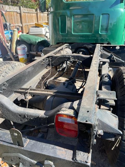

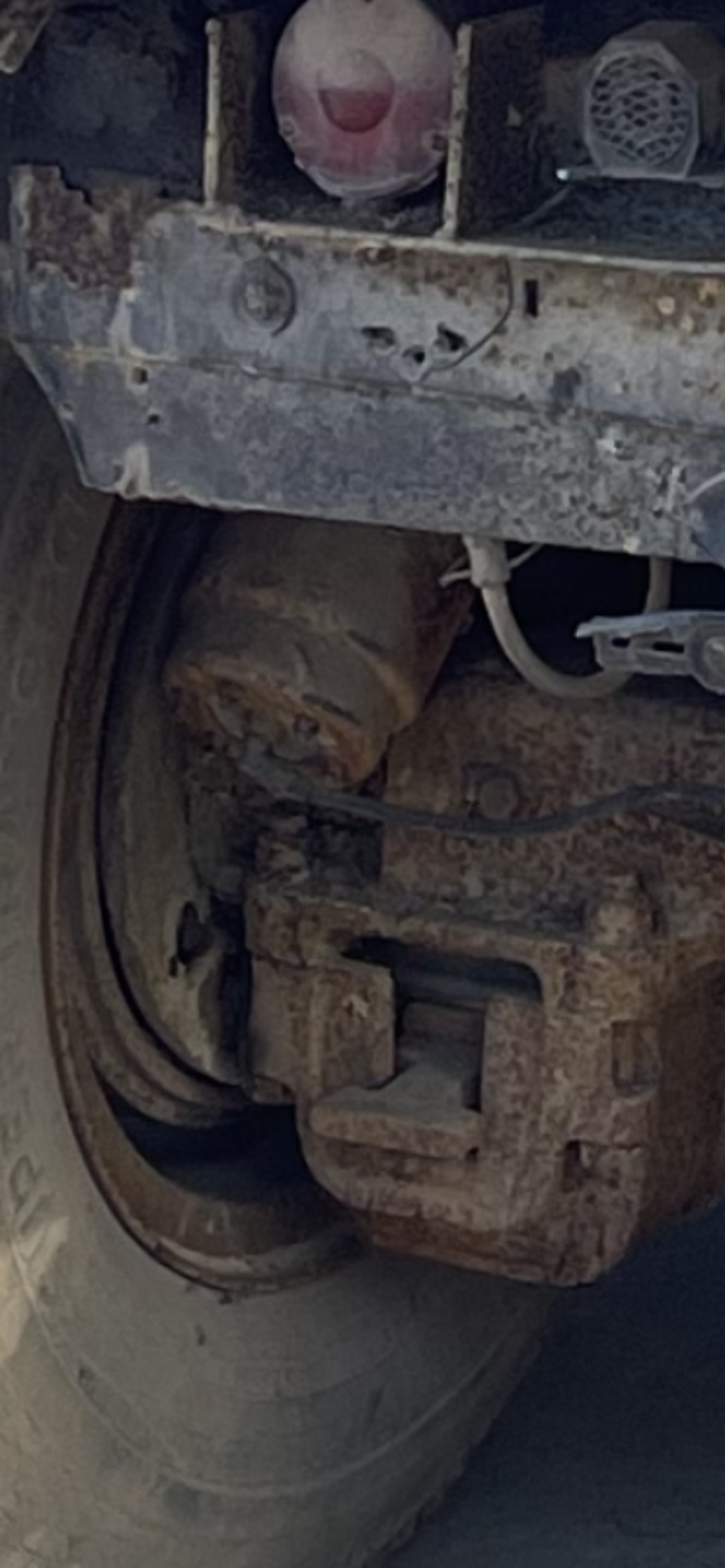

She worked a pit for the wash plant quite a bit I guess. I’m tempted to put my body on it and paint the dump box. Has wedge brakes though and my single axle has maxi’s so not sure what to do yet.

1 hour ago, Joey Mack said:
I do beleive the bolt pattern for wedge brake spider and the s-cam spider is the same..  I assume the same style Mack rear's on both truck's?
Oh that’s good to know!  No, they’re different style. The single axle looks like a more modern setup, I believe with camelback suspension. The dual axle has the rear ends that look like they’re flipped on their side, if that makes sense?
that picture shows Mack rears.  they are top loaders..  whats in the other truck? I would like to see a picture of a single axle camel back.. never heard of one..  the truck pic you posted is camelback..  I guess that the new truck?

can you raise the bodies and post pics of the brake chambers?  wedge brakes had lateral chambers and s-cam brakes have longitudinaly mounted chambers..   Of course,, I am always eager to learn something even if I need to be corrected..   :)   jojo
Well, shows you what I know lol. I just saw big springs on the green one and thought camel back. I’ll get a good pic of it tomorrow at work. The rear on the green has “Mack” cast into the pumpkin on the back. This is the only pic I have of it right now
I’m supposed to go pick it up Friday or Saturday so I’ll get a bunch of pics for sure. I guess I don’t really know if it has wedge brakes. I just saw these tiny little cans underneath and just made an assumption. I’ll get the body up and get some good pics

Not a maxi can ;; old style brake chamber only   unit has a hand brake correct. looks like a drum up on drive line by trans. that style can has a ring of screw driver style bolts around it 6-maybe 8. use to be rebuildable . some B 's had a maxi with 1/2 in rod going to brakes . chamber was mounted in the frame
Yep, hand brake. The green one has new looking maxis with slack adjusters to S cam.
